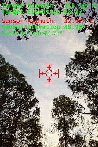

Did you access the target azimuth in the first picture with DishPointer? How did you get to that?
Let me clarify: I got good signals in 2 locations with one portable tripod dish/FS1. The other site (a customer's house) I could not get any 'lock' with 3 different dishes. In locations where I can get good signals, I do the 'balance' between 11842, 12152 and 12115(I think.. it is next in my meter).
The first picture is from my son's Android phone app. I don't know the name of it. The others were from DishPointger on iPad.

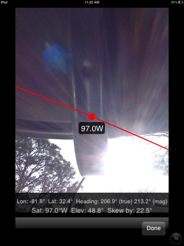

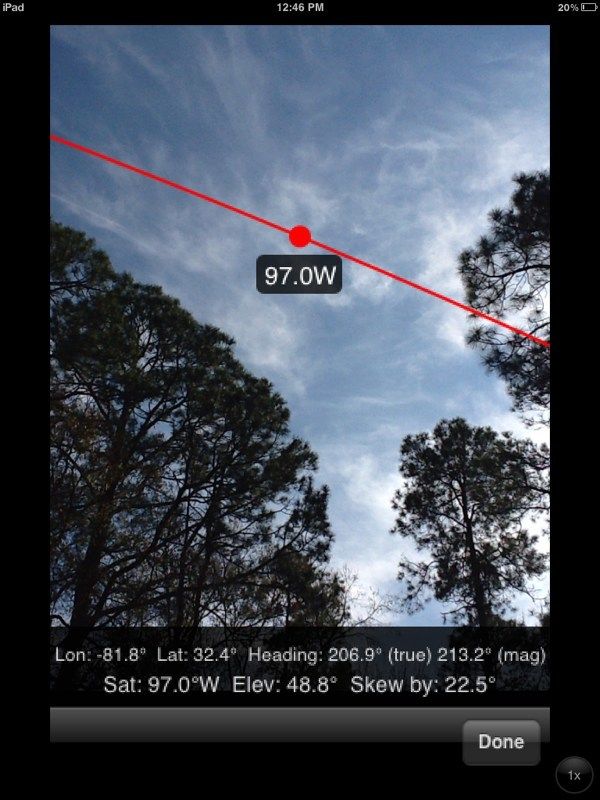

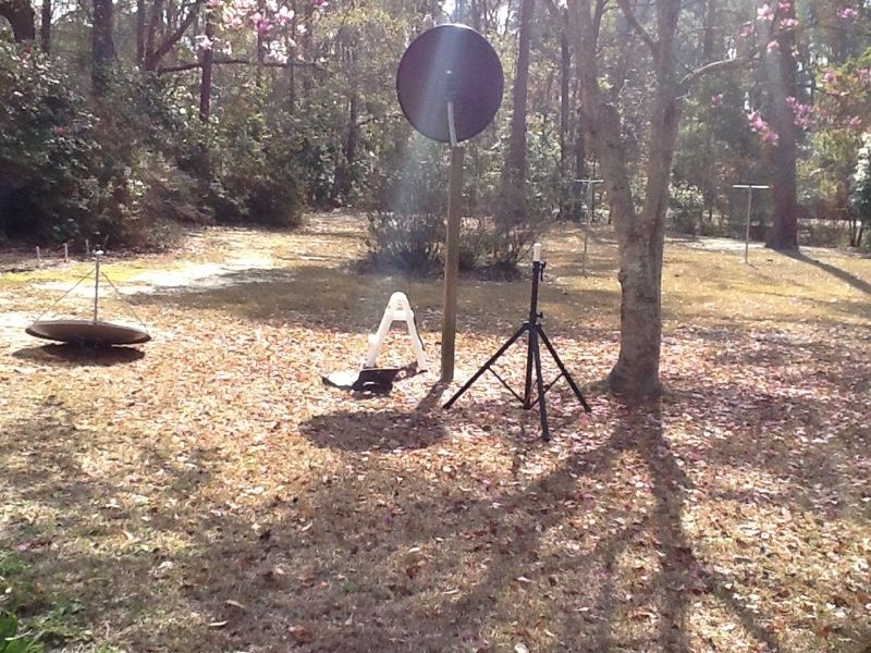

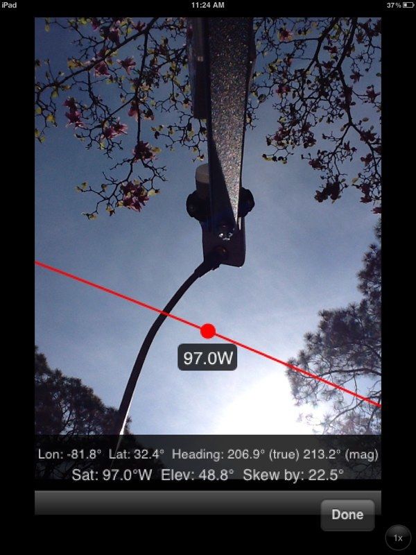

Images 2&3 above are taken looking up the lnbf arm. Image 5 is looking up at the window in the trees from in front of the dish.
About the posted images: Image 2 shows a prolific magnolia limb that came down in front of the dish. I cut that limb off.

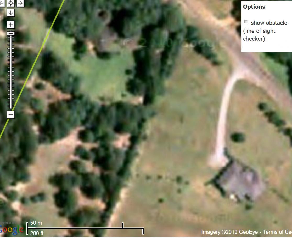

Wescopc.. Bob.. Thanks for the comments about DishPointer. I have been to the site you link to. I confirmed there the way points for my home as well as the one in Statesboro. Both maps don't place the point at the correct house. I'm uploading images of both locations. The second image is of my house in the lower right corner of the image. The indicated line of site for G19 originates down the road a ways but is quite parallel with where my functioning dish is pointed. The other image (customer's house) is also centered down the street, but aims at a very different azimuth from where the original AMC4 dish was pointed.
I have a serious issue to resolve.
A: The original AMC4 aimed dish looked one way into a small window in tall trees. Satellite finder in an Android phone and DishPointer in iPad both place G19 in the same window.
B: The DishPointer site aims the dish some 30 degrees to the west from the original. The current attempts to lock on either G19 or SES1 in the same window have been unsuccessful. (I'll try again with Brian's updated meter settings.)

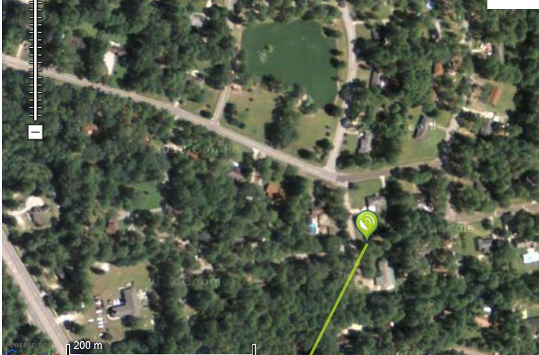

Pepper,
When you find the location of the house/dish on DishPointer just click that spot and the program will relocate the balloon and azimuth line for you. Be sure you show 97W (G19) in the pull down window.
Bob
Thanks, Bob. You're so right. The resolution at the target location isn't good, and the trees cover up the house, but I can put the balloon where it should be and the azimuth, I'm quite sure, is not in the direction the old AMC4 dish was pointing. I did the same for my house. Resolution, etc. is better and the azimuth line is exactly right. I have a fixed dish there that works fine. I've set 2 other GS dishes there with my tripod speaker stand with good results.
I've printed the image of the target location and will take it with me tomorrow back to the site to see what I can do.
I'll keep you posted. Bill

Quick answer to the last question: Yes, I'm quite sure the dishpointer map was correct. The area is not where I live, but judging by the surroundings that I am familiar with, I believe the azimuth was correct. That map on the web page is not influenced by local magnetic variations. Neither is the sun.
Bottom line: 3 magnetic compasses were influenced to send me in a wrong direction. The sun told me where to look.
