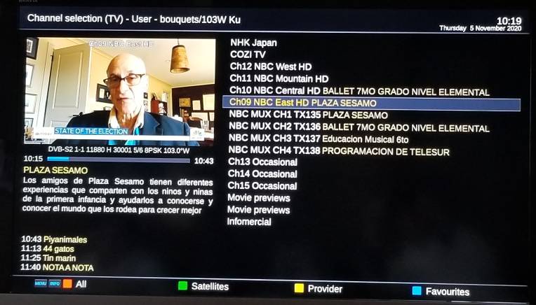

See attached image. I have EPG info from a different satellite appearing beside channels. How can I remove these? It must be a setting I have wrong.

The unwanted incorrect EPG data is from 30W which is on a similar frequency:
30 W: 11884 MHz
103W: 11880 MHz
If I could turn off all EPG data then that would fix the problem.

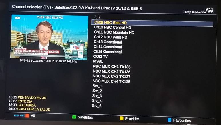

In TNAP 3.2, I found "Include EIT in http streams" at Setup > System > Customize.
When I disabled and rebooted, this removed EPG data from the Channel Selection list (see image below). So this is a good improvement. But EPG info remains in lower left of screen.
Anybody know where epg.dat is so I can delete? I'm searching now using telnet to the Edision.View attachment 148646

In Webif, I did find the two parameters you mentioned: Enable EIT EPG and Show EIT now/next infobar. I unchecked both and rebooted. No change.
At least the channel area is cleaned up so I will leave it like this.
