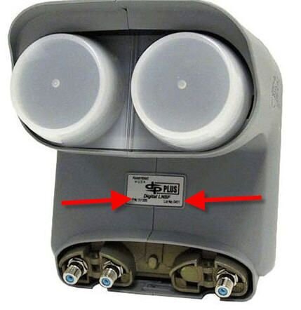

I printed out the info and images and gave it to him. He checked the LNB but did not directly state to me that it was outside the range so I assumed it was.
I wonder if this was a case of it was the only LNB he had, let's cross our fingers, and hope it works ??

The Duo Nodes without the dots should work with all LNBs except for the ones they listed and the ones that fall into those serial number ranges. The new Duo Nodes with the black dots will work with all LNBs and should not be affected by weather. So technically all that should need to be done is swap out the LNB for a new one that is NOT in that serial number range. If you wanted to go further with it you could ask him to swap out the node just to be safe. I would also consider having him change the cable between the Host port on the node and the Hopper itself, just to be safe.

Tech came out yesterday and replaced my LNB and Node. LNB serial number was listed as a bad one. Not sure why he changed the node, because he gave me the same model I already had, the one without the black dot. But since changing the LNB was really all that was needed I guess I dont really care about the node.
The new nodes are in the field but it's possible that not all offices have them. If they don't have the newer nodes then switching the lnb should fix it. But if they have the new nodes then the lnb can be left alone.

My Tech came out today and knew all about it, said there was a tech bulletin last week on it.
He did not know which serial numbers/bar code were bad so I gave him the list that Dish Software Support posted here.
They are to call in at install time to verify with lead techs to make sure the new bar code is good and he did.
He did not have any new "Dot" nodes but said it was not needed per tech bulletin, just the LNB

My new LNB is : A212A2

Print out the posting form the Dish Software team and give to the tech that comes out so they know what part to replace. It include photo of what needs replaced and what bar code numbers. Some techs have not read the tech note yet.
