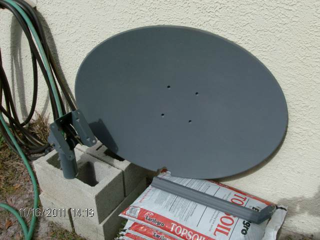

If you can use this, come and get it, its free for the taking. It is a ChannelMaster 75e and I *might* have an LNBF and the bolts for it. It can be in SE TN about 118 miles from you. I'll be there the Fri after Thanksgiving for about 3 weeks. Let me know before Thanksgiving and I'll take it to TN.
