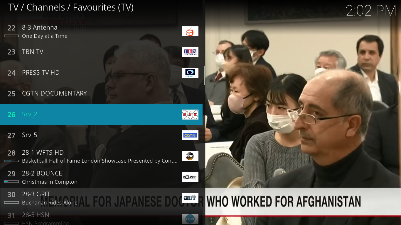

103w is not far from 97w it has NHK on Tp 12145 V 20000 3/4
I get my OTA locals with my receiver and stream everything though kodi.
Have a few satellite dish's fixed in place i've never setup a motor sorry can't help with that.
