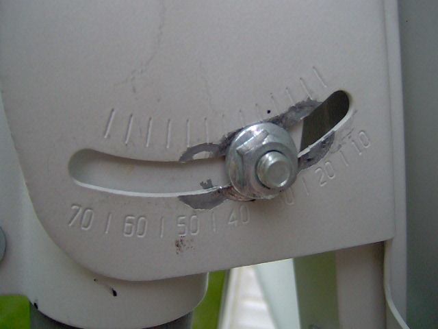

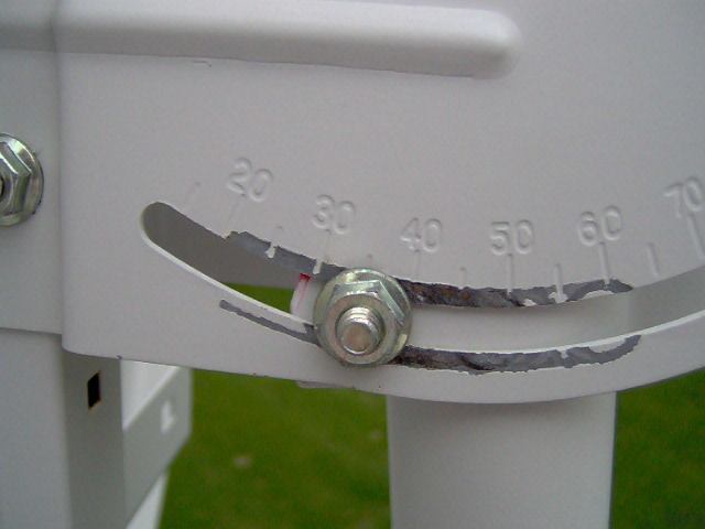

-elevation on the dish is at 38? Depending on the dish, some have a red edge to line up and some do not. The ones that do not need the centre screw lined up with 38 degrees. See the below pictures. 1st pic has a red edge so its lined up for 29 degrees. The 2nd has no edge so the centre of the bolt is at approx 34 degrees.
