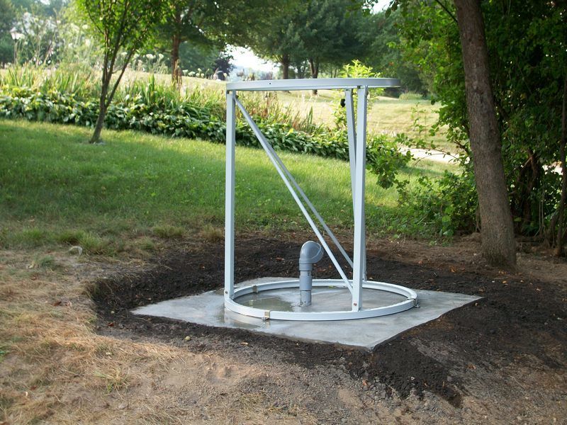

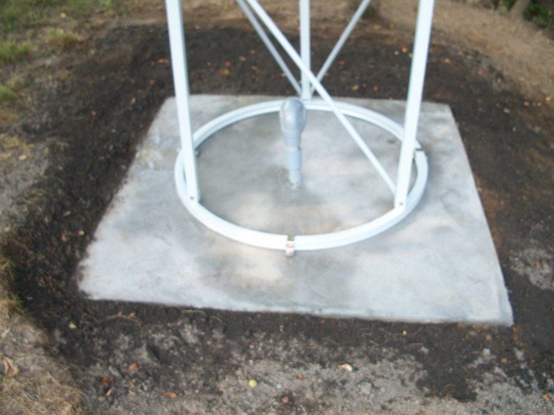

As most of you know during the summer I poured a concrete pad to support my 8' WSI dish. I know that with a motorized dish it is critical that the pole be level to receive the various satellites, but how critical is it for the concrete pad to be perfectly level for a stationary dish?
When I poured the concrete pad I leveled it using a 2x4 as well as a trowel. Due to variations in the concrete (small bumps, etc) the pad is near level, but not perfect. When aimed at Galaxy 17 I never had a problem receiving the channels with a high signal strength. The elevation bar is simply adjusted for any variation in levelness. However, now when trying to receive the AMC 3 satellite (DVB-S2 channels) I believe I might need to shim the base to make it 100% level in order to receive the highest signal strength. Is this true?
I don't think so . For a single satellite, a plumb pole is not as necessary. You should have all the adjustment you need ( within reason) with elevation, azimuth and skew to bring in any sat that you can see !
I wouldn't think that the base that you're rotating the dish upon (azimuth) would make any difference as you also adjust elevation and skew separately. These are all automatic on a (properly installed) polar mount, making a plumb pole imperative.
If you motorize the dish on your pad, then you must ensure that it is level. But, for a single fixed point dish, you should be close enough and any errors in plumb you should be able to fudge around easily. I don't imagine that your pad is grossly unlevel.

I removed the shims tonight that I had placed under the base last week to level and AMC3 now comes in better than ever.
