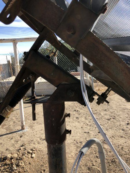

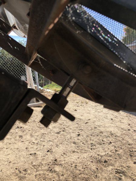

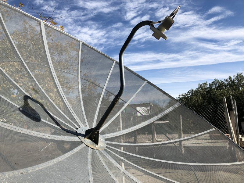

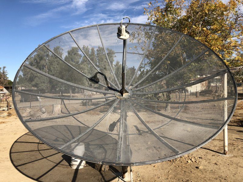

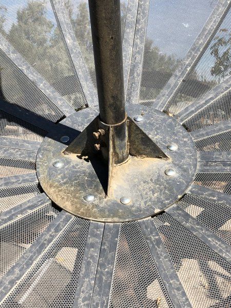

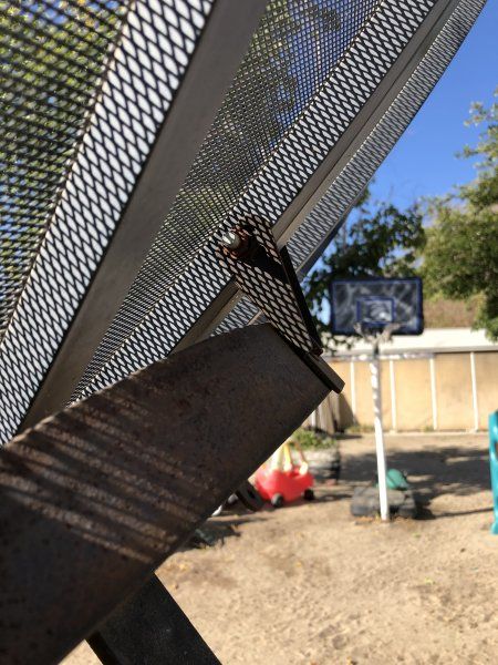

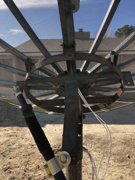

Hello ... could someone ID this BUD for me? It looks like a Perfect 10 but the Perfect 10 Elevation/Declination Angles don't work for it. Thanks in advance for your help!

I don't know what it is but I have never seen a Perfect 10 that was a buttonhook feed support, not sure if they ever made one.
And the Perfect 10 polar mounts I have seen (and owned) are not "centered" when looking at them from the back.
The Elevation / Declination angles are for your location. They are the same for any dish brand. Is your LNBF out of alignment? Skew?

Looking at the five gallon bucket they don't appear to be reversed.
It kind of looks like a Unimesh, but the button hook throws me. I can't remember if Unimesh offered them or not. What makes it look like a Unimesh if how the mesh panels slide into a track rather than being screwed down. The screws along the outer edge is odd. I guess it could be an early version. If so, the later versions had the outer edge welded to the ribs. If it is an earlier model, it looks like you could unscrew the outer band, slide the panels out and repair them. Can't do that with the later models.
That polar mount is almost identical to the one on my 10ft Unimesh, and, the Unimesh I have has a button hook also. And on the bottom side of that button hook mount there is a decal that's still there that says Unimesh. The button hook mount on yours is made a little different than mine where it mounts to the dish but that polar mount is almost a carbon copy of what I have here with that Unimesh decal on it.
