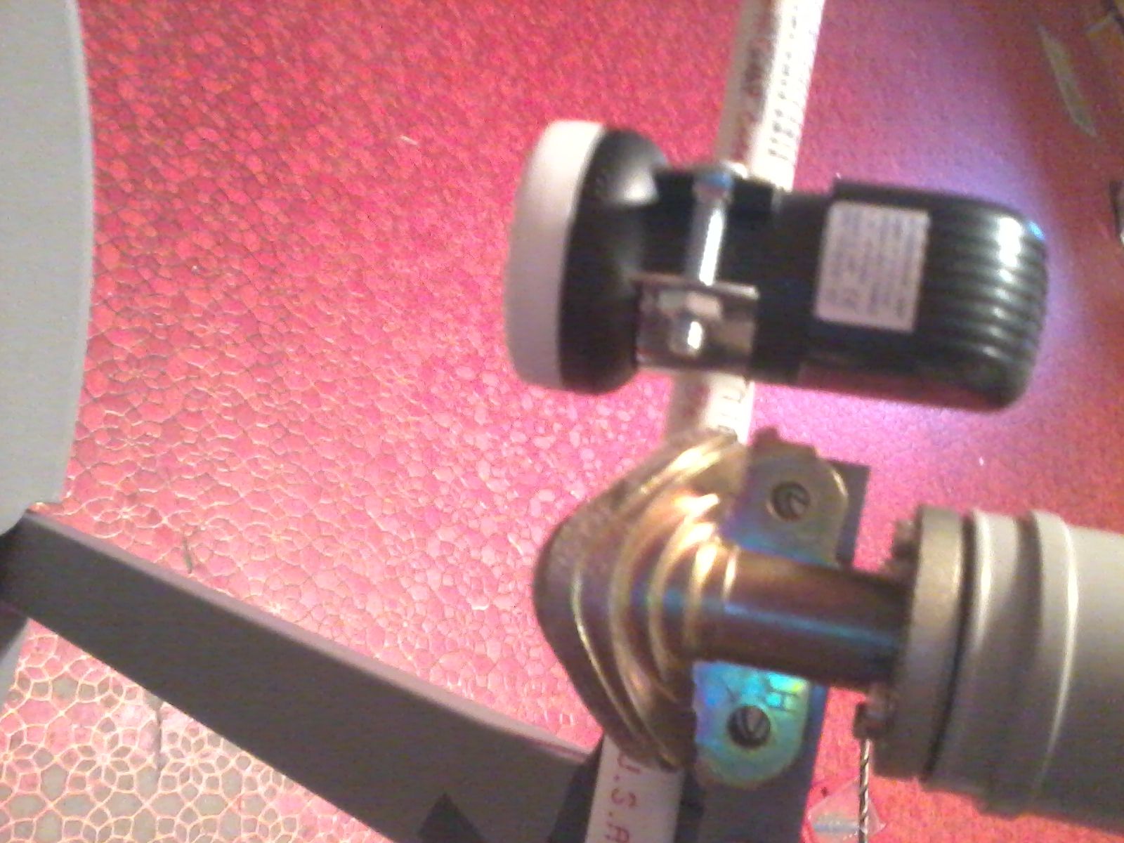

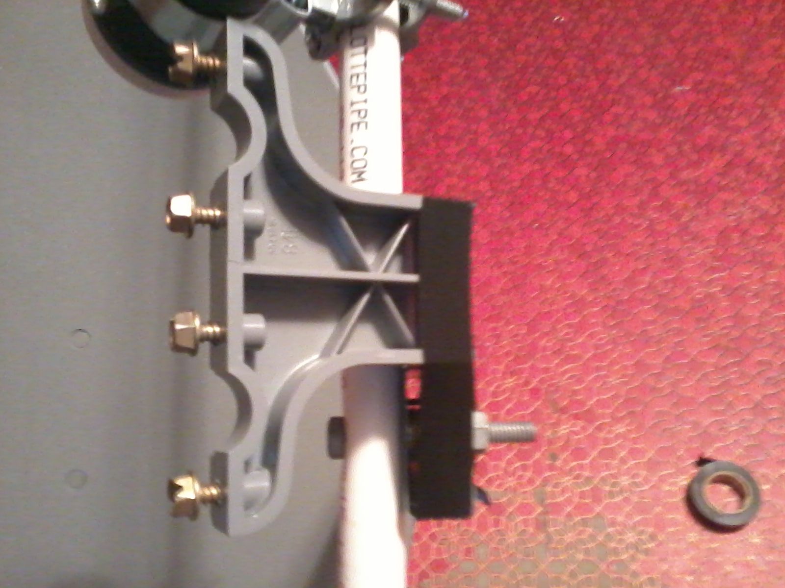

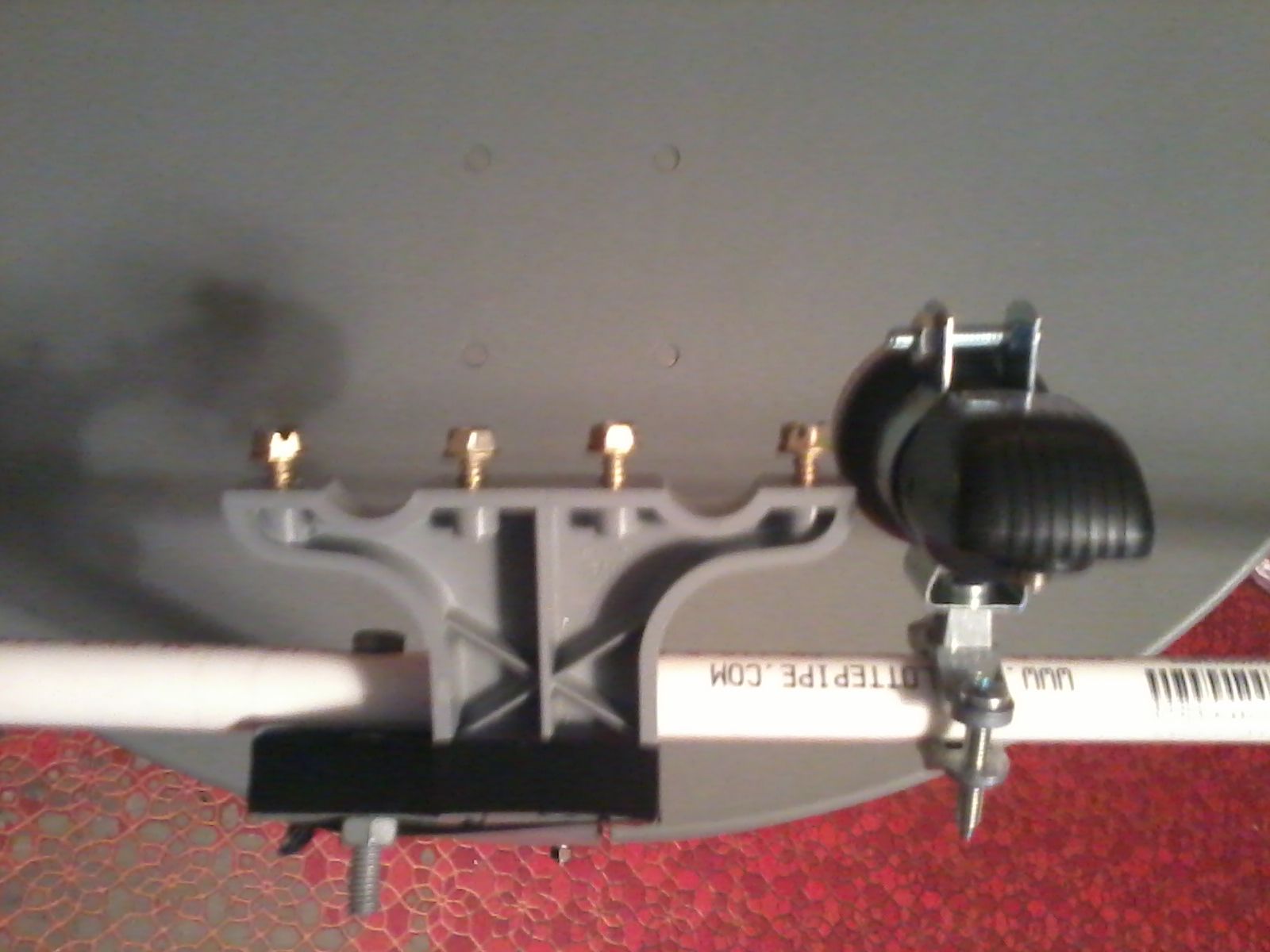

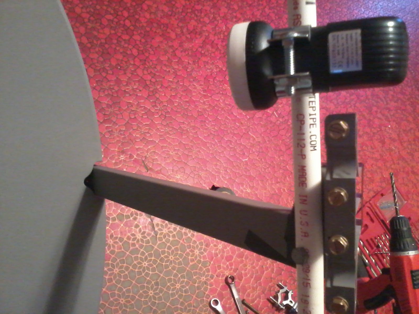

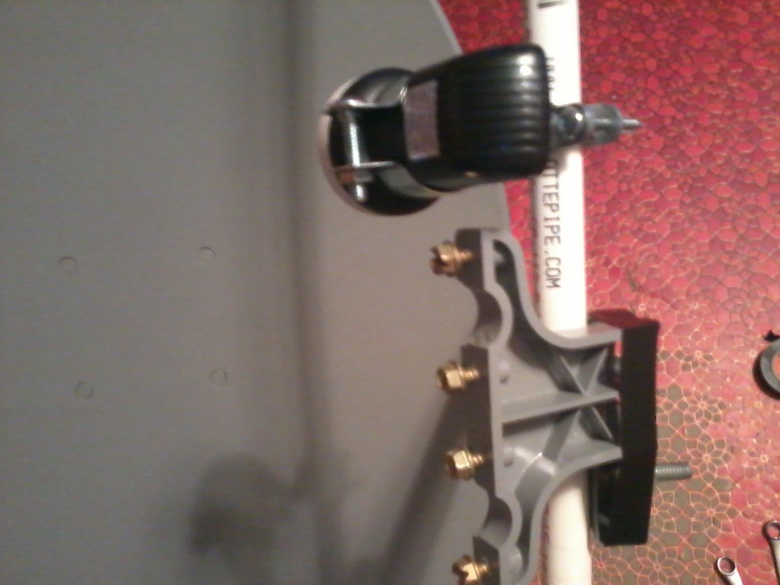

O.K. I have not done measurements yet. But here are the pics of the lnbf bracket taped to the side the the arm so that you can see both how it would sit if it was bolted on and also the lnbf and custom made bracket attached to the plastic cpvc. It actually is sitting purfect as far as hight. But it is about 1/2 inch to 3/4 inch to close. See pics I just took. Photo439.jpg Photo440.jpg Photo441.jpg Photo442.jpg Photo443.jpg
Them make your multifeed in such a way that LNBF is not placed so close to the surface of the dish.

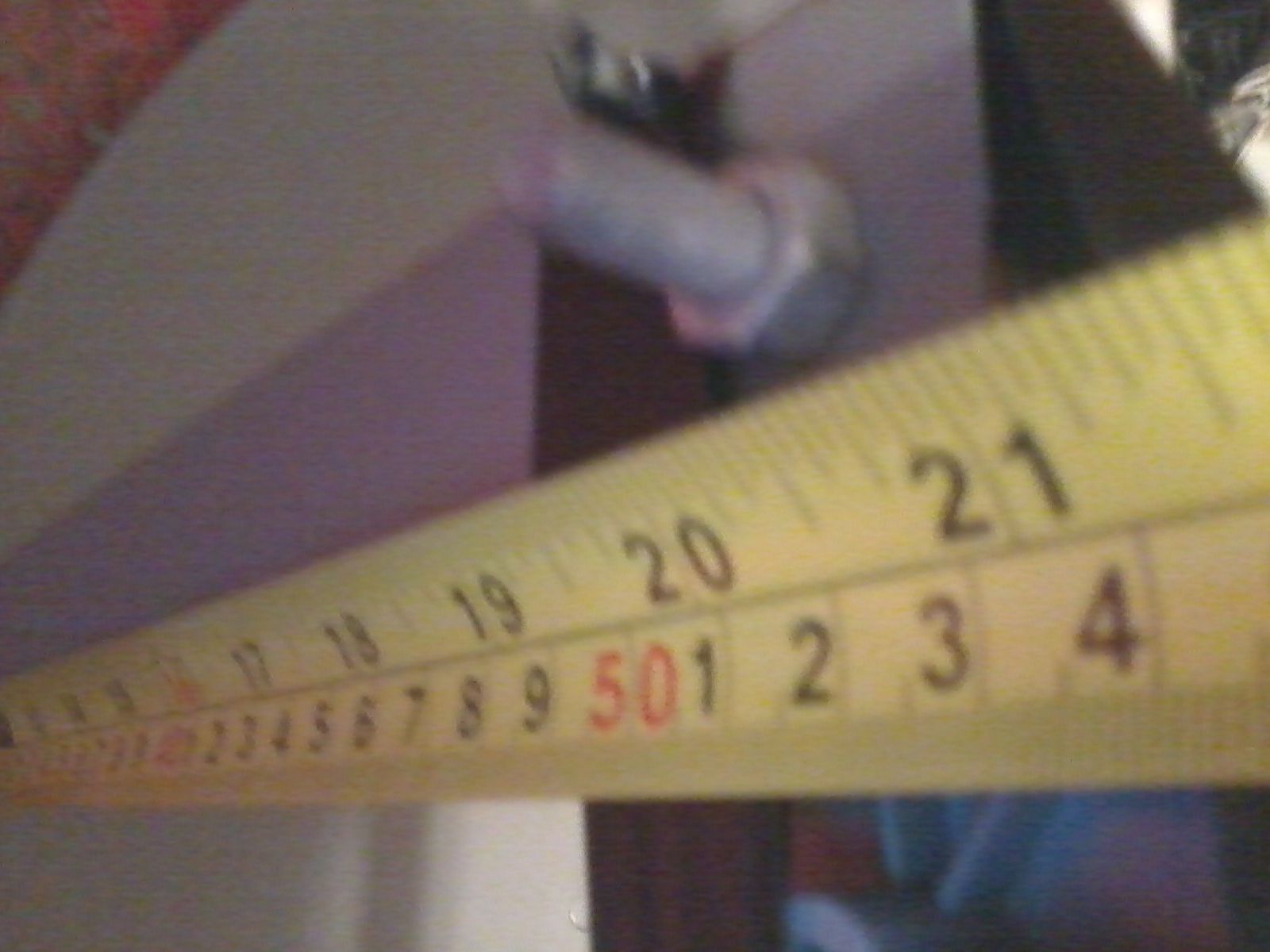

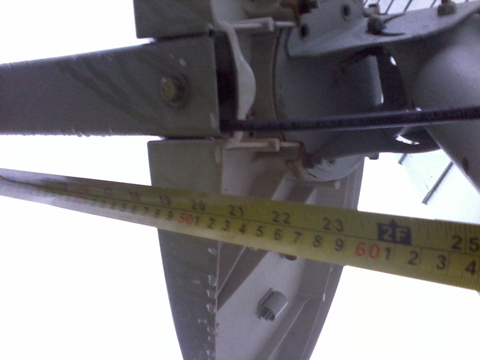

I just did some measurements dish to dish. There is about an inch difference. Oddly I was wrong. The arm on this e84 dish is an inch longer. 21 vs 20. The e84 on the left and e74 on the right HMMM.

OK. I have been out and about after work looking for a solution to mounting the lnbf's. Now I am frustrated. I determined how to get the lnbf's 1/2 inch back from where they are using a metal plate. Only to realize that the lnb arm that came with this dish would not be even close to correct if I had used the lnbf holder that came with it. It put's the lnbf aiming above the center of the dish. The lnb arm holder on the e74 is not this way and it is more on an incline than that of the arm that came with my e84. In fact I feel like I am hopping through more hoops than I should have to. In fact I am starting to question why it is that there has not been a bracket made for fta like dish and direct tv bell tv or others has. This is not a new thing. Some kind of conspiracy what? I have decided not to get the metal plate made. I am sticking with what I started with after looking at linuxmans stuff. I seem to be doing something very similar minus the radiator hose clamps. I am not sure how much a 1/2 inch being closer to the dish can limit me but will find out. Wish me luck

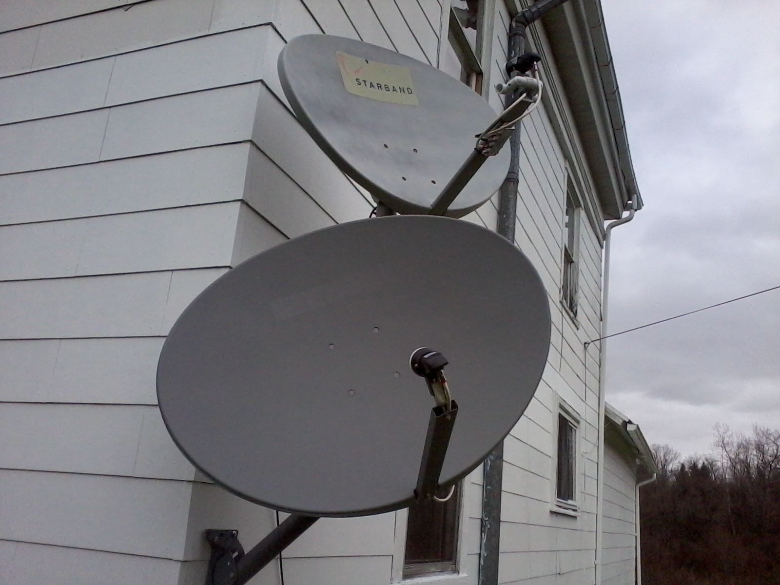

OK. So its been a while. My apologies to all. I have needed the over time at work. To Answer the arm issue on the 84e dish. The re-seller has not made an attempt to respond to my questions in any capacity. Total radar silence. So... I will remember that for future dish purchases that's for sure. The dish was made to use a Prim-star type lnb arm. Designed to hold a eagle aspen style lnbf. It is slightly longer in length than the direct tv flat style that actually came with the dish that was purposely packaged to go with it but not as designed to be used with it. YES. I have learned that the multi lnbf does in fact need proper distance. In wich I didn't and could not have because it is a direct tv style arm. I am sure it worked to some capacity for some sat's but why set your self up for failure with poor signal quality? The arm that came with the dish started to collapse while tightening and I had to buy washers to put inside it. The dish was not designed to be used with this arm. Yeah it will bolt up, but you have to be careful and then mods have to be made to make the lnbf work right. PITA. So I ended up not having multi lnbf set up after all. Just two dishes. You can see what was done by looking at the pictures. Pretty much I took titanium's advise to get the single lnbf holder that was adjustable. This actually is the best set up I think. I did have to bend it to get it to hit the dish correctly but not by much. I can tune in any sat now. Only I decided to have the dish set to pick up 125 west. The other dish is still aimed at 97 west.
