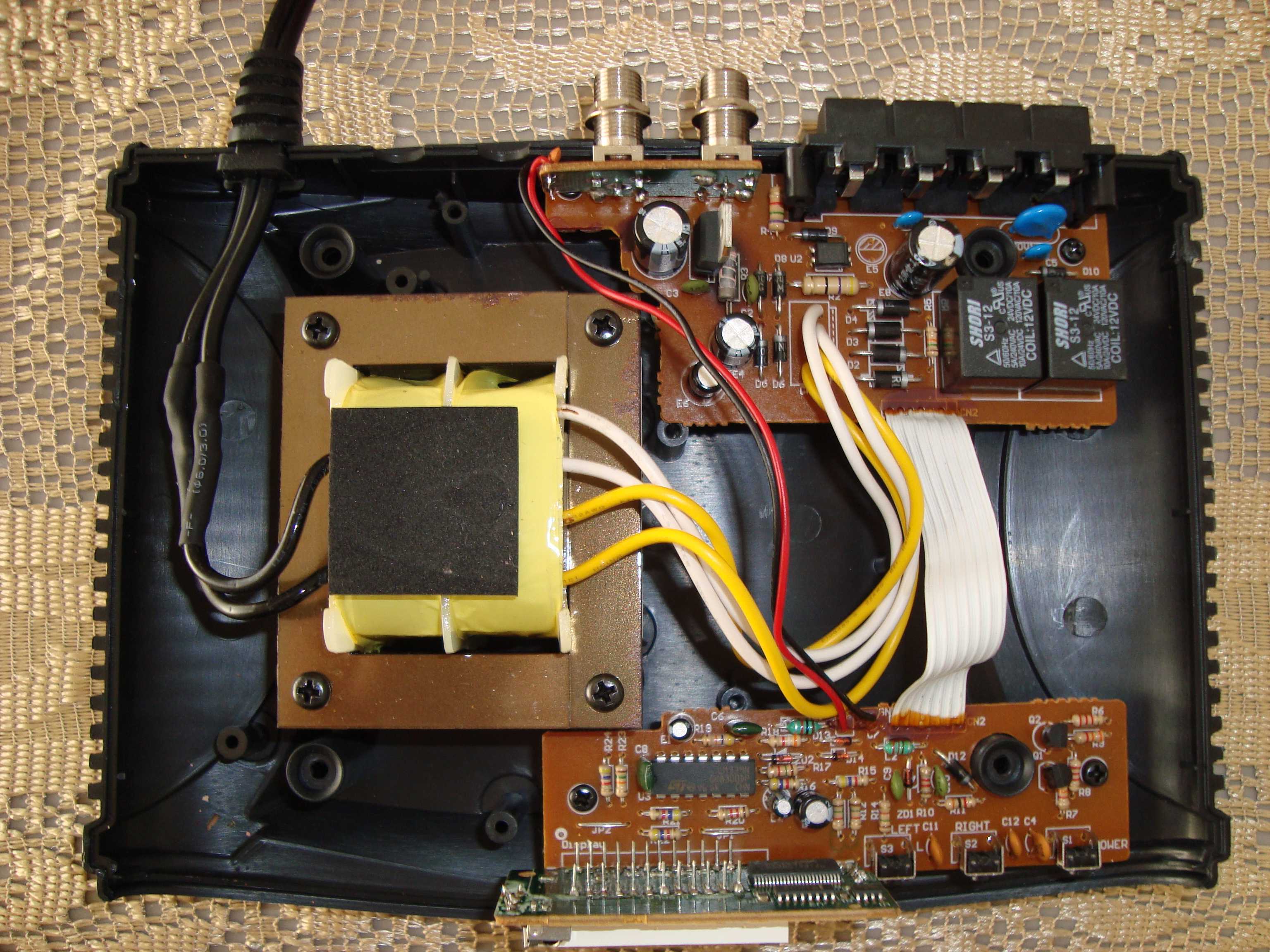

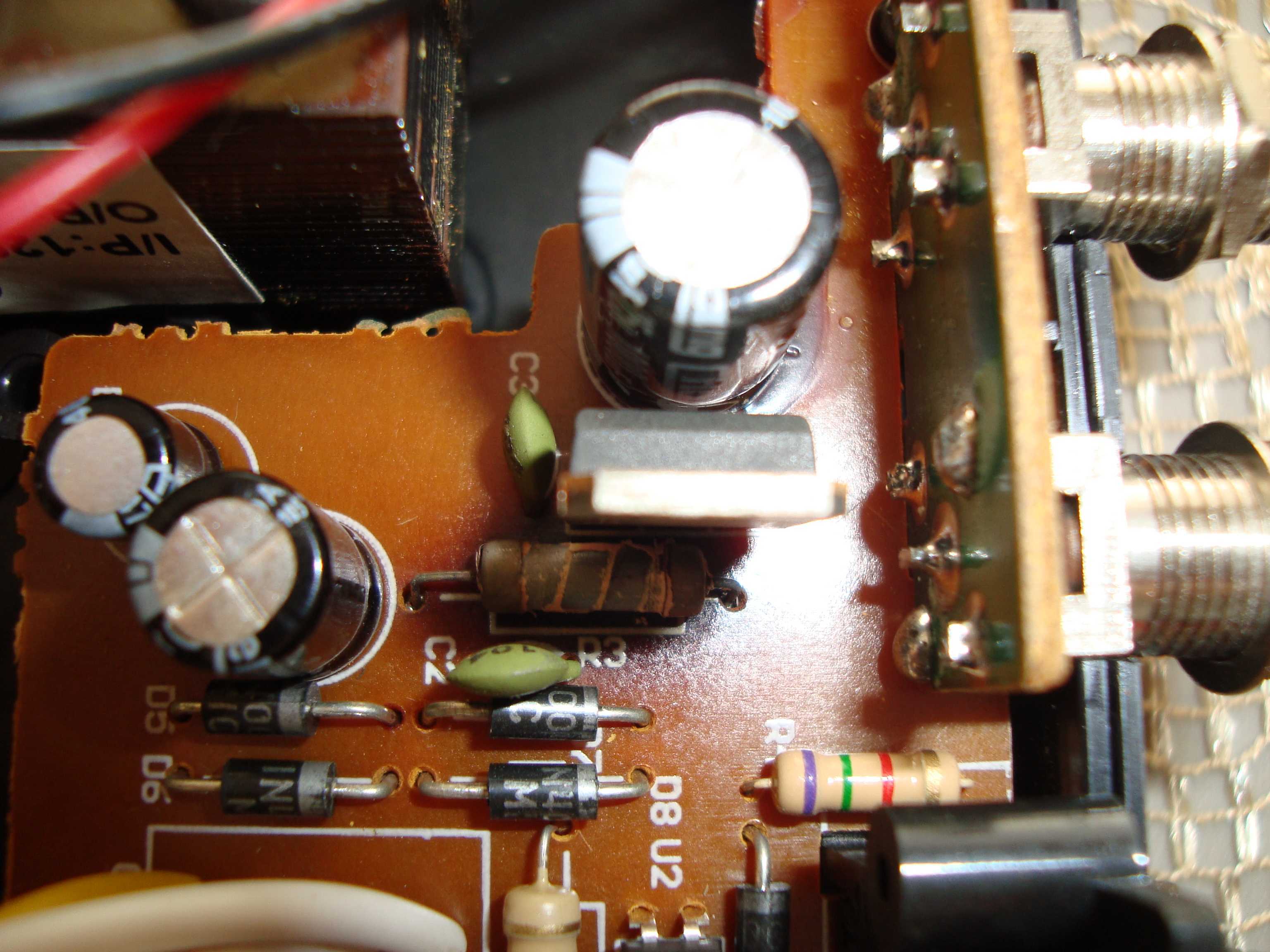

Yesterday my GBOX 3000 was not turning on.After 20 min.of trying i opened the box,looked around and found that one of the resistors(R3) is burned.
So went to ratshack and bought pack of 5 (47-ohm 5%) thinking that are the same as the one on the right(R2)resistor.
After installing the new one it burn up again
Any help will be appreciated. THANKS[/ATTACH][/ATTACH]

Well, I see discoloration on the board under the cap on the left. Suspect shorted cap. (heat causing the discoloration)The item between the cap and the burnt resistor I suspect is a 3 pin (LM78xx[??])voltage regulator. may be shorted also.
