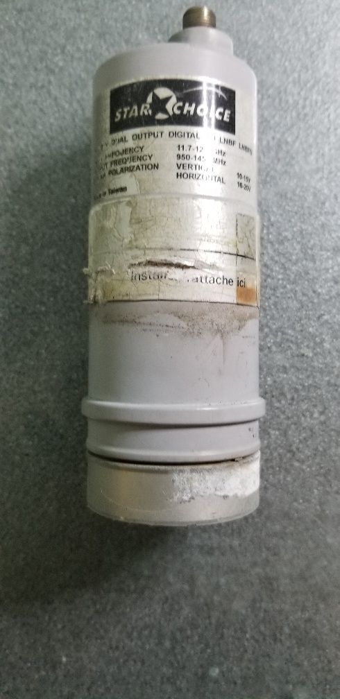

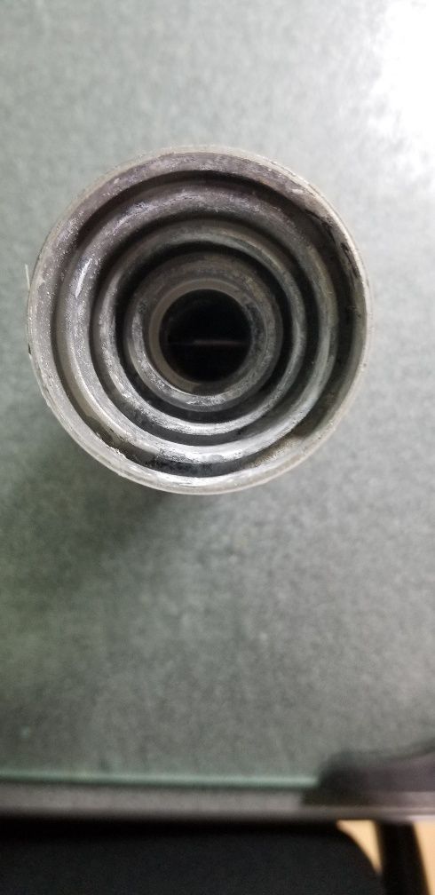

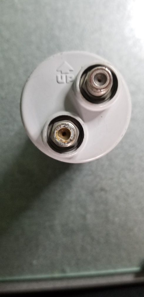

I get no indication that this LNB still works when I connect a receiver with voltage to it. It seems sealed and I can't open it (even destructively for educational purposes). Any hints how I could make it work again or at least see its electronics?

Isn't that a bandstacked model? It should show signal but won't show quality unless your receiver had a bandstacked option.
When I substituted this LNB onto an already aligned dish, and randomly picked one of the connectors to connect to, I found 0 signal. This is why I concluded it's faulty. I expected to see maybe 45 on the receiver. I never tried selecting a bandstacked LO.

No, that isn't a bandstacked lnb, although Shaw/starchoice had many. It is a dual output standard 10750 linear. I had the same lnb with my one metre dish I bought in Amherst,NS. Mine went dead after about a year and a half. Threw it away about six years ago and got a Maverick Pll.
