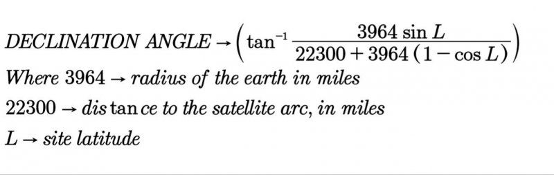

Another equation for figuring your declination angle, instead of using less accurate tables.

The earth is not a perfect sphere. Therefore the radius and distance to the arc are variable depending on your location. You need to determine those two factors for the equation to work correctly.

That said, I agree with Shicks4, the tables get you close enough to start off with.
Plugging numbers into a formula or calculator isn't particularly stimulating. Mathematics is deriving the function that you plug the numbers into.
You're absolutely right, earth isn't sphere & earth radius is variable from equator to polar, if you want to get an accurate result you need to get your latitude radius & also distance to your desire SAT first before using this equation. I just put 3964 & 22300 values in order to write the equation & is not exact radius & distance to satellite for other site's.

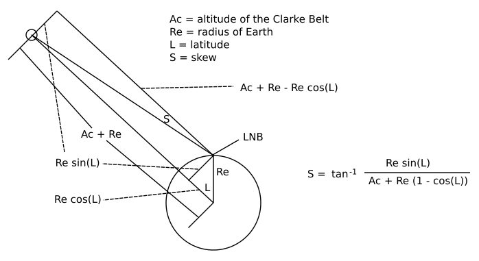

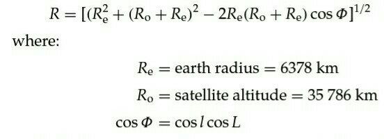

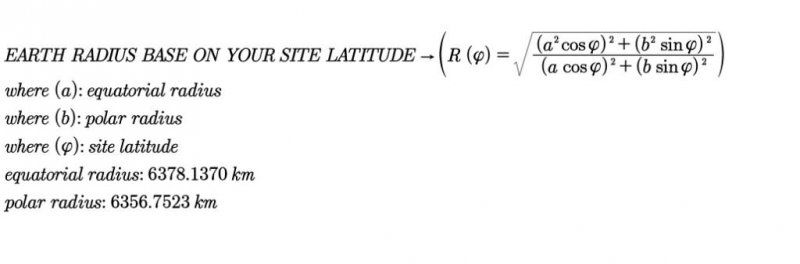

You can get your site radius & distance to satellite through these equations.

I know calculation is a hard way to get all these information when you can get them in seconds on the net. but i'm a pilot & flight navigator and I have learned & accustomed to do every job on it's standard way instead of relying on the internet & website's. That's why i rather to solve such given problems through computations. Imagine you need to set up your satellite in the middle of desert with no internet connection, it's not better to do it yourself instead of getting help from other sources?
