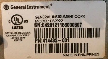

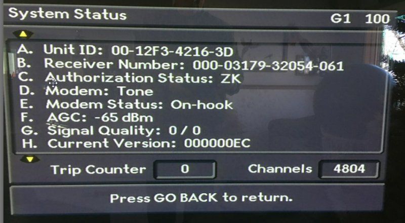

Power up the unit and see if it has the UID (Unit ID) number in the diagnotics screen and that it matches the UID on the bottom of the unit. The seller should be able to provide this photo proof or move on to another unit...

Is this the information i need to validate the device, or am i missing something? I see the Receiver Number on Menu matches UA on label.

Don't worry about a dead battery/scrambled ID,just put a new battery in it.The only thing the ID was for was to get subscription channels,you can't subscribe to anything anymore so it doesn't matter.A 4D with a bad ID will still get the "free" channels just fine,as long as there is nothing else wrong with it.I know because I have one.It does need a god battery to work,bad ID or not.
