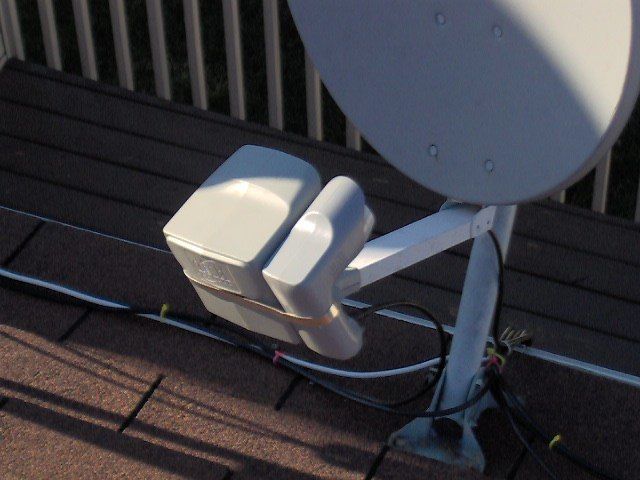

Here is when I made a Ghetto Dish 1000...you would just put the single or dual LNB on the opposite side of where I have mine :)
