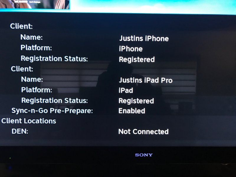

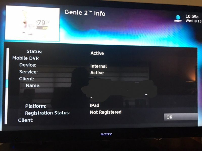

What does the system info screen on the HS17 show, does it show mobile DVR enabled and the clients registered?
It doesn't say "enabled" exactly, but the iPhone and iPad Pro are registered. (Ignore the other iPad referenced, that is an old iPad that was previously registered to the hr54)
Ok. So I used an old ASUS router (the one T-Mobile provided if anyone cares) and thus resolved the issue. However it isn't a practical solution. I guess if anyone has any router configuration advice I'd gladly take it (I'm using Google Wifi mesh system).
