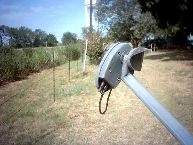

laseradam,
Is this the type of LNB you have on your Primestar?

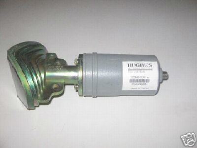

No it looks like this on that is on sale on E-bay. I think I can see a weather cover on this picture.
I have the same type of LNB as in you picture on my other 2 Primestar dishes... they don't have a weather cover on them either.

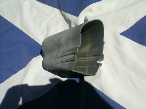

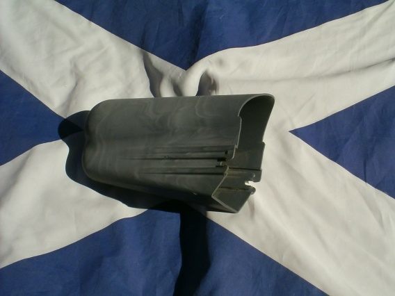

Here is what the weather cover looks like.........

That weather cover is for the oval dishes. There are lots of different kinds of primestar dishes. It sounds to me like he was refering to the plastic seal over the feed horn portion, like the white plastic cap on a d* or e* LNB. When I was with primestar, we got a shipment of oval dishes with defective plastic seals. We had an outbreak of intermittant signal problems. The first one I ran on, I determined it to be a bad LNB, so I took the old one off and put a new one (with the seal intact) on. Then, I dropped the LNB, and a bumblebee rolled out. Hell, I put the old LNB back on and it worked! I still replaced it, so that I could show everyone what I was talking about. "what do you mean, there was a bumblebee in the LNB?" He was camped out inside the neck of the thing.
The oval dishes had a dark grey plastic seal. Very prone to cracking and falling off. Never had problems like that on the big dishes that had the clearish seal.
That other cover is too keep the connectors out of the weather, not to keep bugs and water out of the front of the lnb itself.

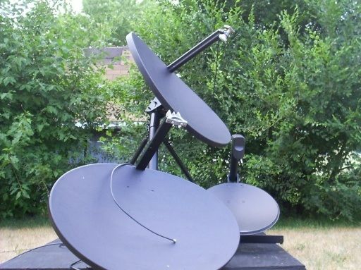

They are BIG dish that can be retro fitted with new LOW noise LNB's
With my 40" Primestar I can skew the whole dish and not just the LNBF!
They can be had VERY cheaply or often for no cost at all....... need I say more :)
