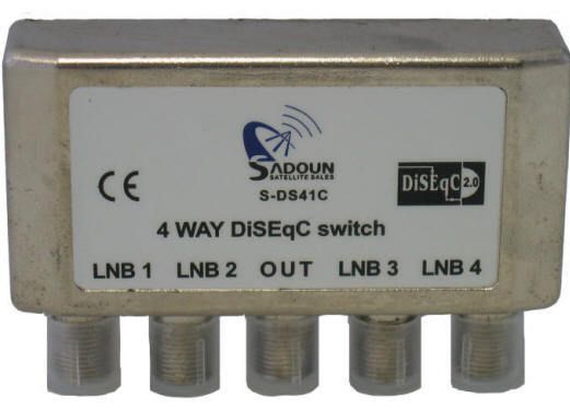

BTW, this is what I have - - - and I bought two when I got them - - - the other one is still in the box unopened. Should I try the other one using a different configuration?
Well heck, why wouldn't you? What have you to lose?
