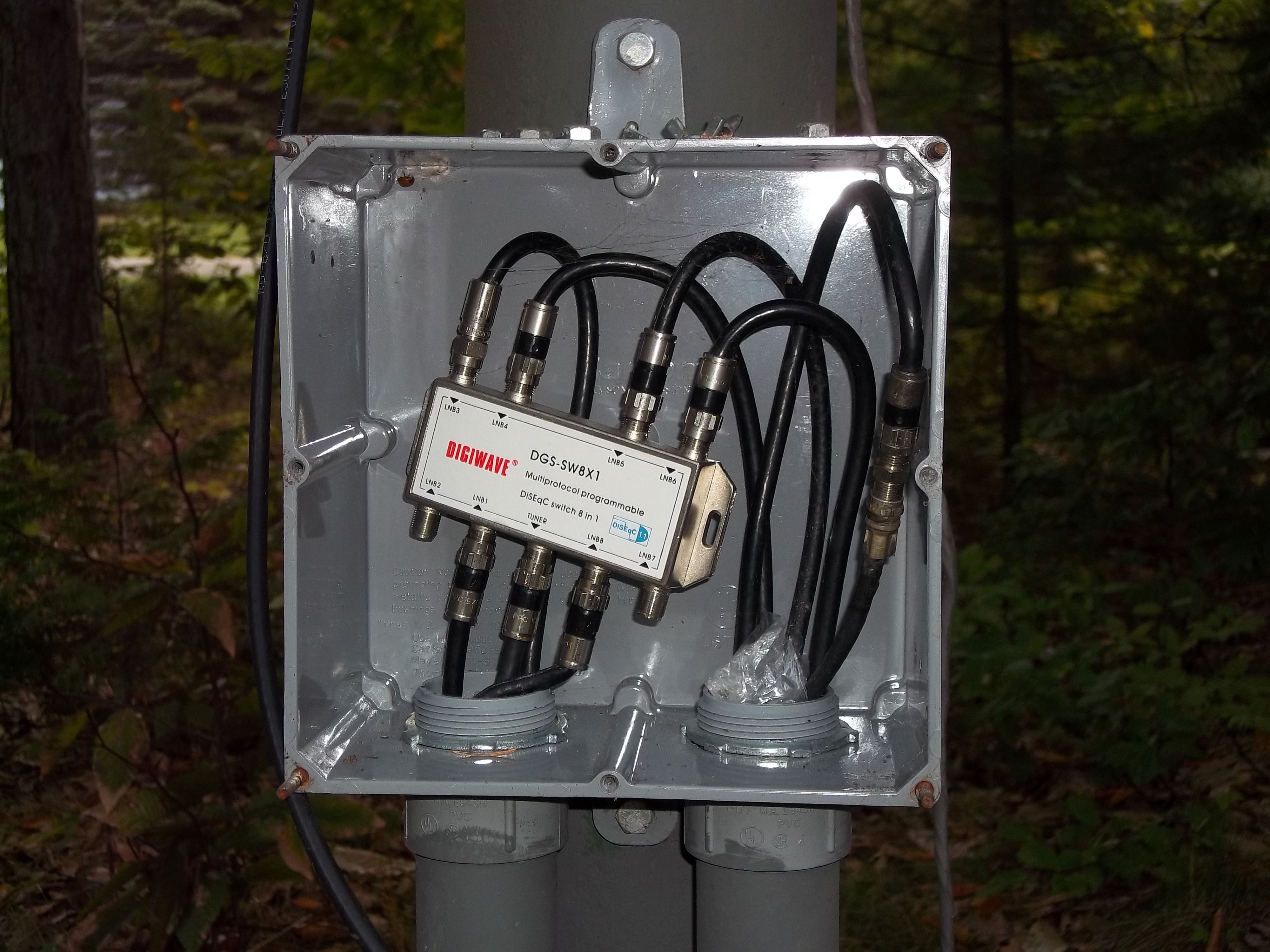

I usually protect the switch from weather, since even the "high end" switches are of terrible quality, and add a little effort to minimize cable length. This means mount the switch near as possible to the dish without getting rained on. It seems to be the best balance between cable cost and switch replacement cost. Or possibly physical effort. I enjoy life more when there are fewer things that demand attention.
.....I usually protect the switch from weather, since even the "high end" switches are of terrible quality, and add a little effort to minimize cable length. This means mount the switch near as possible to the dish without getting rained on.........
Not difficult to protect from weather. My 8 position out on post to my Winegard. Weather proof box with cover off.
