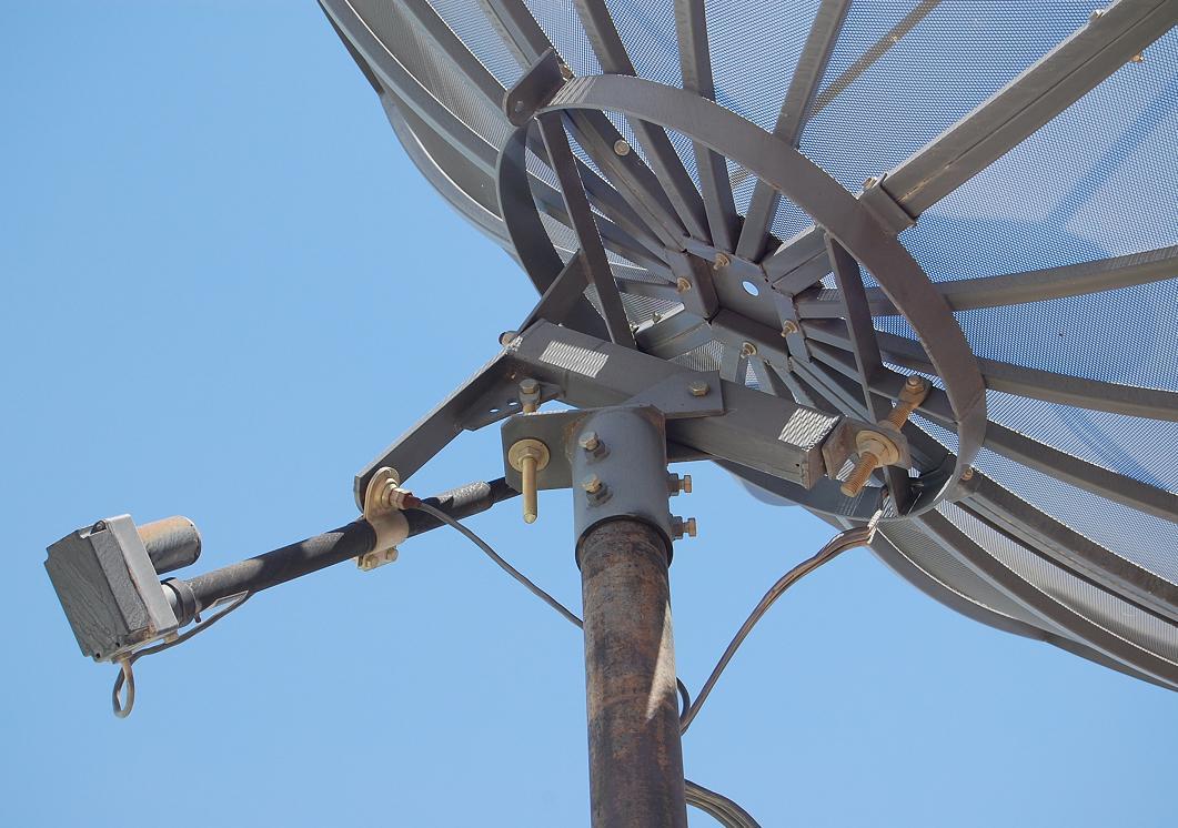

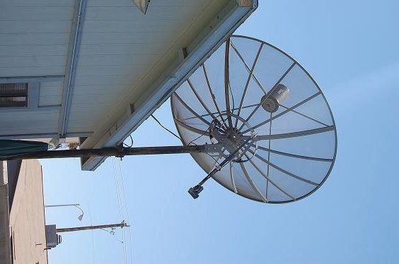

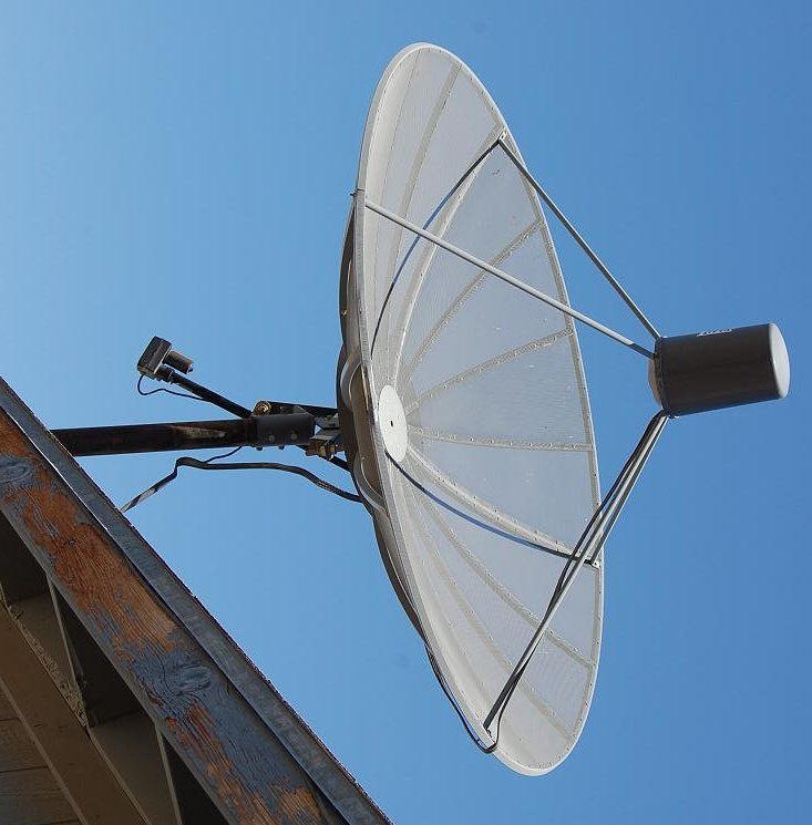

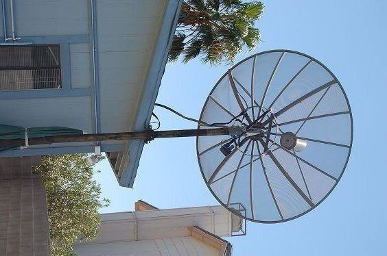

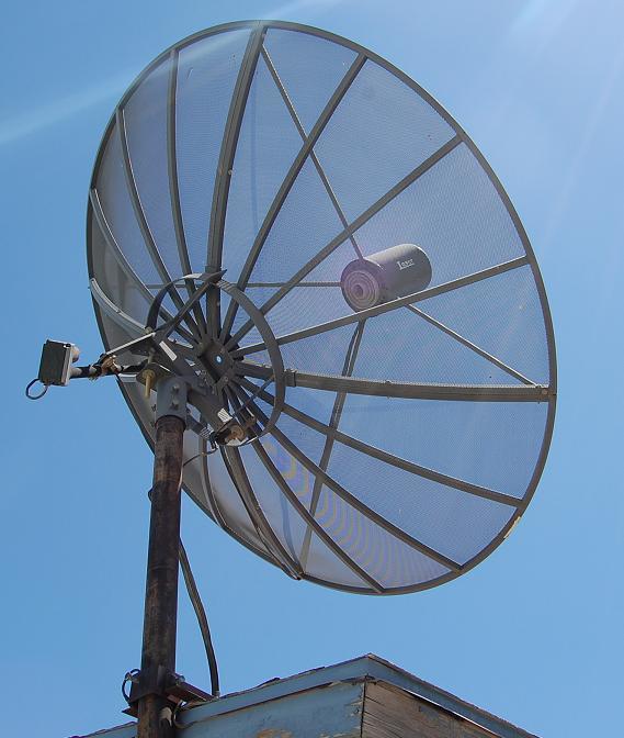

Here (attached) are 5 photos of the dish out back, requested by anole. Note the brand name Laser can clearly be seen in the 3rd photo. In the 5th, I zoomed in for some detail, but I don't have a clue what I'm looking at. It is too high up for me to measure, but I think that it is more than 6 feet wide.

a Big Useful Dish :) now that will probably work for FTA :)
if i was to guess i would say 7 1/2 fter :)
what would be neat is just hook the Viewsat PVR7000 up to the coax from this big dish & setup to scan c-band freq (5150) and see if it finds any just the way it is :)
and welcome to the group and the world of FTA
EDIT: and if i had to guess i'ld say its pointed at 125W Galaxy 14 but thats just a guess :)
Nice pictures of the BUD. Thanks for posting.
I think I would suggest refocusing on the 36" dish for now.
Get some TV going for the family.
Then, as you get a better understanding of FTA (and acquaint yourself with the BUD section), maybe grow into using the big dish.
Because, getting it going as your first project is a bit daunting for a newbie.
edit: and this is in no way a discouragement from the suggestion above to hook up to it and see what you get!
If it's parked on a good bird, you might be pleased!
Is that even possible?? Just hook the PVR7000 directly to that monster and maybe I can see something? I would have to figure out how to "scan c-band freq (5150)" but I did see something about scanning in the manual. First I will need to find out just where the coax goes... maybe it even reaches into the house. No telling how long ago it was abandonned.
voomvoom, does Eastern Arc refer to some satellites that are truly in the Eastern sky? East of where?? We are located in Southern Nevada, and it looks to me like this dish is aiming a little bit Southwest of here.
i was just guessing but it also might already be configured for c & ku
there are several coaxes going to the feedhorn but i think this was a common installation method.
but if it does have both c & ku you would just need a way to move the dish :)

yes its possible :)
if the coax entered it probably entered into a main room or den and could be hid behind a blank outlet and should have several wires (or ribbon cable) unless it was pulled back into the attic space.
