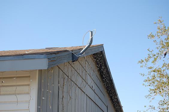

As I look at the detail in picture 5, I believe that I see rust, not just on the mast, but also on the cylindrical object in the lower left of the photo.
yes since its physically pointed H it should be that way unless the last power pointed the servo at V got it :) lol lol :D i'm going to bed its late
(or maybe that backwards its late )
i guessed galaxy 14 and on H polarity it has TBN , JCTV, SOAC great family christian channels .
have fun guys and a great night :)
rust doesn't look to bad
the cylindrical object is the actuator and it actually doesn't look to bad for being in the Nevada sun

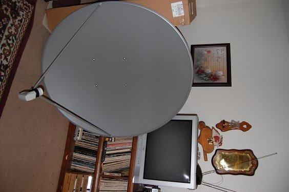

Anyway, after learning that bigger is better, dishwise, AND learning that small dishes are subject to "rainfade", AND facing the very real possibility of relocating the family to either Oregon or Washington (following the work), we decided that it would be good to get a dish larger than 36". It won't make much difference while we're here in Sin City, it would be real important in the rain. So I ordered a Geosatpro 1.2, and waited for over a week for it to get here.
It arrived today and I was surprised to see just how big 1.2 meters is! In photo 62a, the dish in its shipping container sits in the living room in front of a 27" TV.

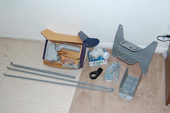

Photo 68a shows the smaller pieces that came in the shipping container, and also the motor and LNBF which coincidently arrived 2 hours earlier.
Photo 72a shows the dish assembled and sitting in front of the same 27" TV.

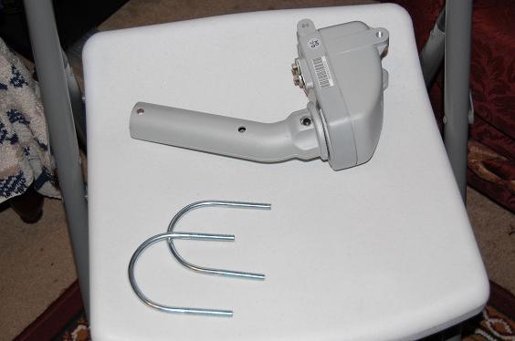

And finally, photo 73a shows the new problem. The tube-like leg sticking out of the motor is 1 5/8' in diameter. The brackets in the picture will only clamp down to 2 7/8" at their tightest. In other words, I cannot get the motor to attach at all to the bracket on the Geosatpro's butterfly.

GeoSat 1.2m (4-foot) dish is a very nice one! - :up
To deal with several of your questions and observations . . .
- people do put that dish on a 2100 motor, even though it's a bit awkward
( I might have suggested a bigger motor or a smaller dish)
- there may be a larger shaft for the motor, as an option
- folks generally get a piece of plastic plumbing, split it down the side, and use that to shim between motor and dish-bracket
- the dish came with a suitable mounting post 'n foot, didn't it?
- Don't put it on the pole on the side of your house! :eek:
- may have mentioned this before, but I'd suggest you put up the dish without a motor as a first step, and learn the basics
Hope that gives you something to think about at this midnight hour.
Plenty more info is available, as you need it.
