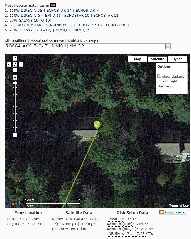

Thanks. It turns out the dish would be pointed northwest rather than southwest as I thought. Here is a screen shot. The dish location is on the north side where the installer said it has to go. It seems like the south side below the peak of the roof along the same line would work. I might call DirecTV and have them come back and indicate to me what tree is blocking it. I could probably have it taken down.
Where you placed the dish on your house is the east side, not the north. Also, you are using 91 for the azimuth. There is a drop down menu for the other satellites. Use the 110 setting to get an idea of where the dish needs to point if you are getting an sd install. Use the 101 for hd. If your sd locals are on the 119 satellite, use that heading to find out how far west you need to see.

North is up in the picture. We speak of the dish as pointing southwest.
The trees to the south are likely to be problematic (if not now, probably later) and that's not something an advanced tech can fix (it is a job for an arborist).
The elevation is the key metric here and in up-state New York, it is fairly shallow so tall trees are a big issue. The actual elevation will be lower than the figures you have because the satellites are further west. Curvature of the Earth plays big in this.
