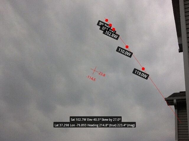

Joe, congrats man. I purchased the dishpointer app to make sure I can get mine installed at my apartment. The tech comes Wednesday morning. Someone please tell me I used the app right and that this looks good? dp-2012-08-06_14-20-47-753.jpg
Joe, congrats man. I purchased the dishpointer app to make sure I can get mine installed at my apartment. The tech comes Wednesday morning. Someone please tell me I used the app right and that this looks good? View attachment 79863
That is it.......clear sky.......no problems.
Somehow, I would have expected the sats to array exactly opposite of the way they are seen in your picture. IF you are in Virginia.........it looks like you are sighting them from west of the array. Anyhow, bolt the mast to the rafter tail and run the cable to the ground block near the electric meter (the tech will know) and you are it.

Thanks for the reply Joe. I'll for sure post a pic. The way they are running is from S/SW to more SW. So 119 is the lowest and most SW of all Sats. I am aiming at about 205 degrees or so. 99 is highest in the sky. Yep, in Roanoke Va.
Ok, Now I get it.....you are shooting from your apartment deck...........should work fine. My installer eye saw the house in from of your shot....dish could go there also. Those three birds at left are the ones you need. The 110 & 119 still have function but not everywhere.
Joe
Joe
Yep, on my deck, lol. Well I am going to ask them to attach it to the deck rail or put one of those tripods in that anchor to the rail. That's even better because the only sat that gave me real concern was 119. Those three I can hit with no problem. This is all sounding good.
With your local sd channels on 119, you will have to get an sl5 lnb setup if you are getting the install from Directv. If you use an independent, then you could use an sl3 lnb. It doesn't really matter since you know you have a good line of sight for 119.
