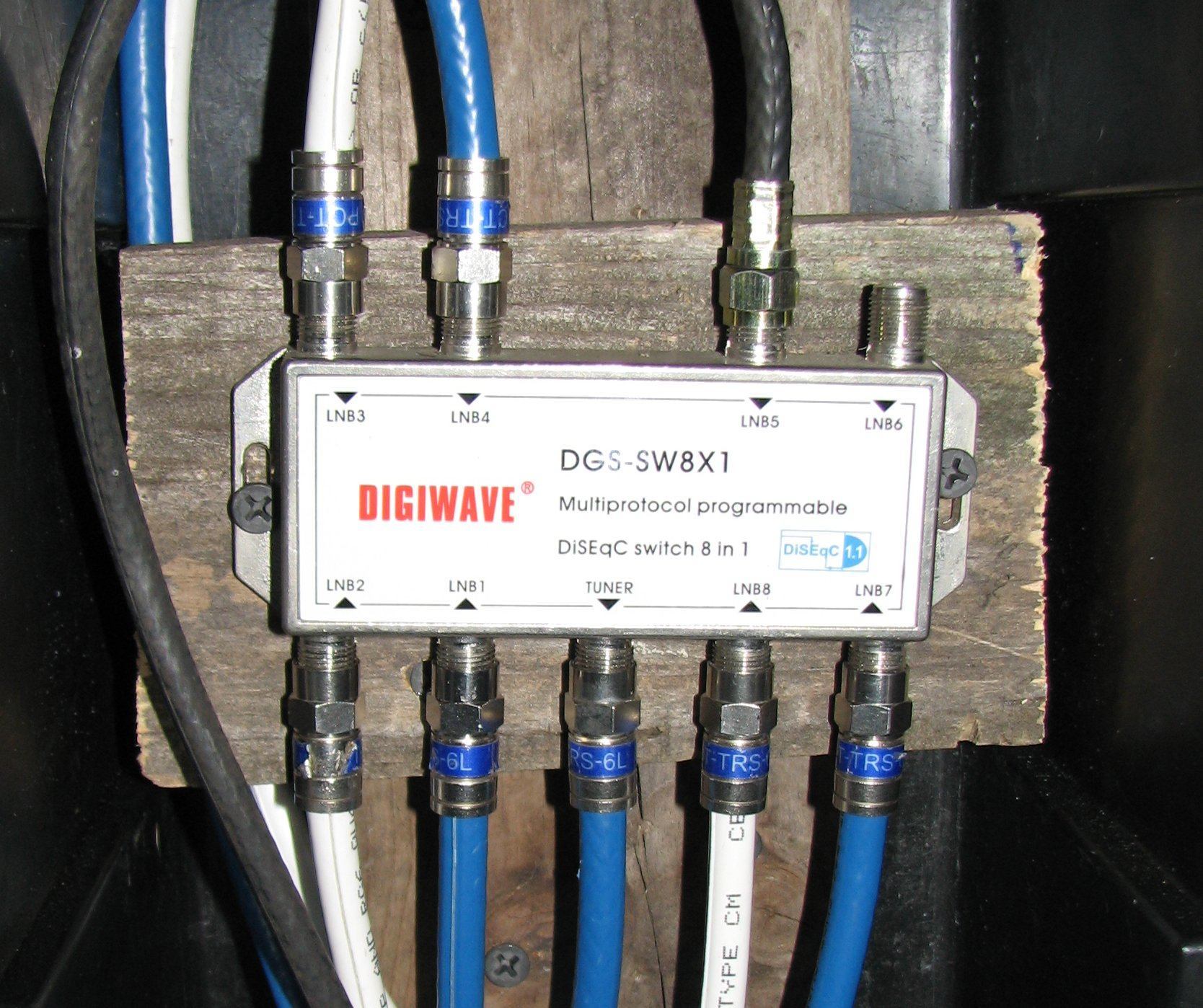

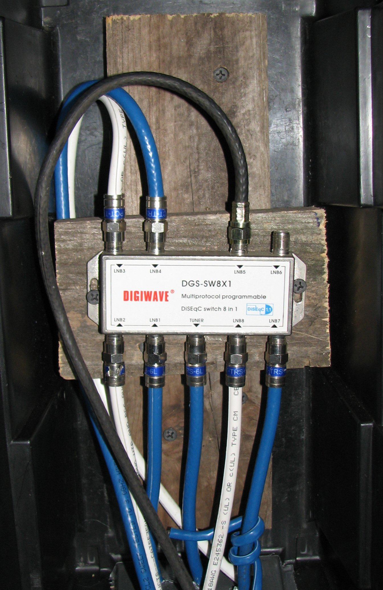

I have one of these Digiwave 8 way switches and it works just fine for me on a home theater pc. I have 7 dishes hooked up to it at the moment.
I can verify that it's Ijjit proof. :)

I have one of those ecodas in front my my Digiwave and it allows me to have the 8 way on one side and a C-band and Gbox on the other side.
Dee,
That is a very neat looking installation. I especially like the blue coax.
