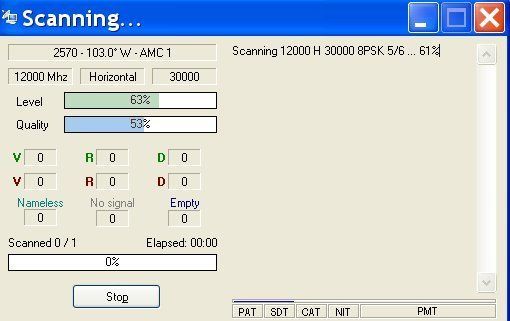

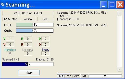

Played with the DVBDream BDA drivers to lock in a few DVB-S2 Ku channels (have yet to test any Diseqc, motor functions).
With my 80cm Fortec Star dish, I 'm able to lock in the Florida Knowledge Net/Channel on AMC3 (pic 1). But I've only been able to lock and tune into some feeds on AMC1 only once (and that was using the latest Mytheatre software, and even then none of the channels were stable/viewable.)
Is this due to the high SR? How much Signal and Quality is needed for DVB-S2 feeds with a high SR?
I don't think the SR on any of those transponders is over 30000? The Dvbworld will handle SR's over that so it shouldn't be a problem. Try giving your lnbf a twist each way and see if you can improve your signal on AMC 1. Some people need to do that as I'm told the ku side of that bird is a little different in skew. I've never really had that problem here but its something you could try.

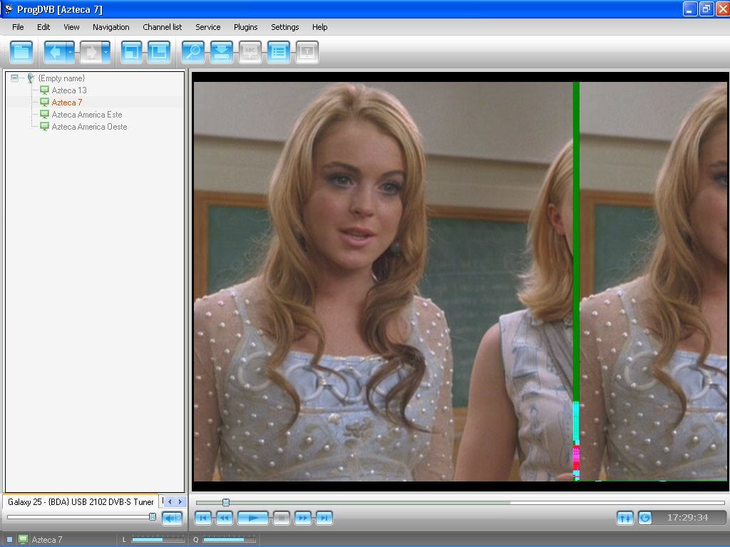

What is the best software to use with this usb S2 unit?
Yeah, Great Question.
After banging my head by using the DVB World software, I am trying other stuff.
TS Reader - I like it, but the non-crippled version is sort of pricey. All of that technical info is interesting, but what I want mostly is to read the FEC info.
DVB Dream - Installed it, but the interface is strange. I don't care that when you hover the pointer over the buttons, it doesn't tell you what the buttons do. Haven't gotten it to work yet. The TP scan seems to see signal and Quality, but a TP scan yields nothing
Prog DVB - If it works well, $35 is a little more reasonable. Installed this one. Didn't get it working with native DVB World drivers. Again, The TP scan seems to see signal and Quality, but a TP scan yields nothing. The BDA drivers work sort of. on the right side of the screen, there is a green vertical line. Then the left third of the screen displays again. No sound...
Ideas?
The Dvbworld uses bda drivers so it won't work with Tsreader. I've used the usb box with dvbdream, progdvb, mytheatre and a few others but I like Dvbviewer the most. It is around $20 and if you buy it you can get Transedit along with it for no charge, it is similar to Tsreader in that it has a stream analyzer feature.
