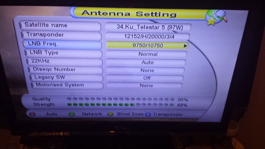

It's never used before I bought it 3 years ago and had it in storage, I'm only getting 75% strength on 97w but no signal.

Select TP Frequency 12152, Horizontal polarity, Symbol Rate 20000. This is a good TP to use as it is not duplicated on other satellites and cause a false positive.
I set it to that and yes the lnbf is in the clamp

Set your LNB Freq. to 10750 only, not 9750/10750.
