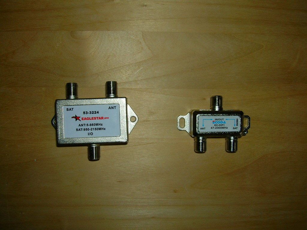

You can try a diplexer. Ecoda is one brand. Its a special splitter/combiner. You need 1 at the OTA antenna and sat antenna cables and the other matching unit goes in the house and feed one end to HDTV and other end to sat box.
I don't have any details but you can search web for it.
2 brands of diplexers.
Unless you have very strong terrestrial signals and don't mind loosing some signal quality on the FTA system, I would highly recommend not using a diplexer. Run a second drop if that is an option.
Quality diplexers attenuate approximately 1.5dB each inserted unit. Two diplexers are required. One to combine and another to split out.
I loose marginal terrestrial and satellite signals when using a diplexer.
