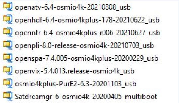

Here are all the images I can find. Are there any of these I should not use? Are some better than the others?
Ok If you still using Openvix do this. once you put the stick in and see the no displayable files screen leave the stick in and reboot the Mio. After the Mio boots pull the stick and put in the computer create a folder on the stick named imagebackups and that will be the folder to Place the multiboot images. You need to leave the multiboot images zipped or compressed. To flash put the stick back in the Mio (might need to reboot again)and go to menu> setup> vix> image manager and you should see the multiboot images listed.Click on the image you want to flash and it will show slots 1 to 4. Click the empty or slot you want but not the slot currently in use. After flash the Mio will reboot to that slot.

Usually the file without multiboot prefix can still be flashed multiboot.To do multiboot leave the file zipped and use the flash image menu.The zipped file needs to be in a folder named downloaded_images. There is two ways to flash 1 multiboot and 2 emmc.If you flash emmc you will overwrite slot 1. Emmc flash is where you unzip the non multiboot prefix file on to a flash drive and flash with a power cycle.
