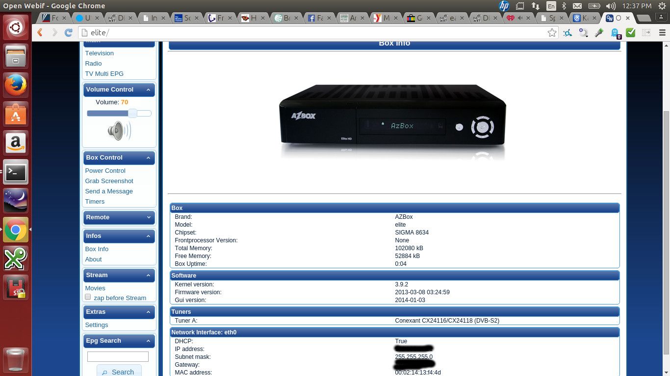

Yep. A lot of things can go wrong. Anyway, I have my Azbox Elite (running Enigma 2 firmware/software) hooked up to the Ku dish with a Birdog between it and the slaved TBS DVB card and using Kaffeine software on Linux. Getting strange results. It's strange that the TBS card is scanning Galaxy 19 Ku @97W OK but I can't get anything scanned in with the Azbox. The antenna is moving with the Azbox controlling it. I doubt that the enigma 2 firmware is an issue since the Azbox did scan in stuff off of AMC1 Ku @103W but it couldn't find COZY (maybe it's gone?) and it didn't find anything on 11760 H 30000 (DVB-S2/8PSK) or 11940 V 20000 (DVB-S/QPSK) - kaffeine (using the TBS card) only found NBC DC HD SES-3/19F CAP-3 (reports 11940 V 20000) - w_scan found nothing. I don't know why. Don't know why Kaffeine sees something on both sats while Azbox only sees one. The SQ is > 60 so I don't know what the deal is. I have to say, also, that although the Azbox shows 80% SQ on SES3 Ku the picture looks crummy - Kaffeine gives S/N as 100. The Birdog says it's 98% SQ though. I had to edit scanfile.dvb for kaffeine even though linuxtv.org provided a file dated 08/2015 - but that didn't help.
Too many issues. I'll figure out what's wrong with all this stuff eventually. To put a positive spin on this, it'll keep me busy in my retirement. Of course, the wife would prefer that I get other stuff done.
