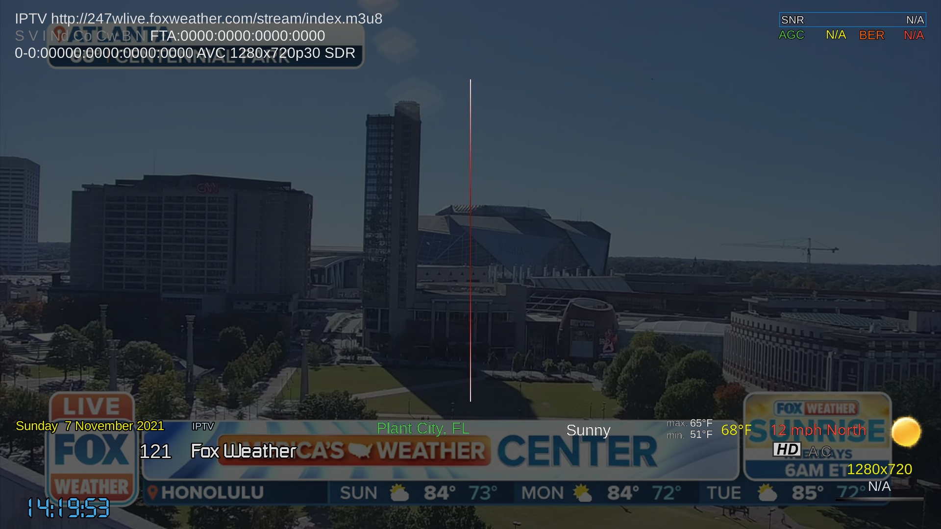

That one doesn't play well for me on the mio4k. keeps stopping. Can't seem to play that fox weather either they must changed the link or it's just my internet speed but red bull tv is playing so I don't think it is the internet. Thanks
The fox weather is still there but they seem to be having reception issue from the source again. I think I see what I did wrong with the johnny Carson link didn't put the R432p in and it's trying to play at 1080P. Let me fix that and try again. That fixed it Operator error!
