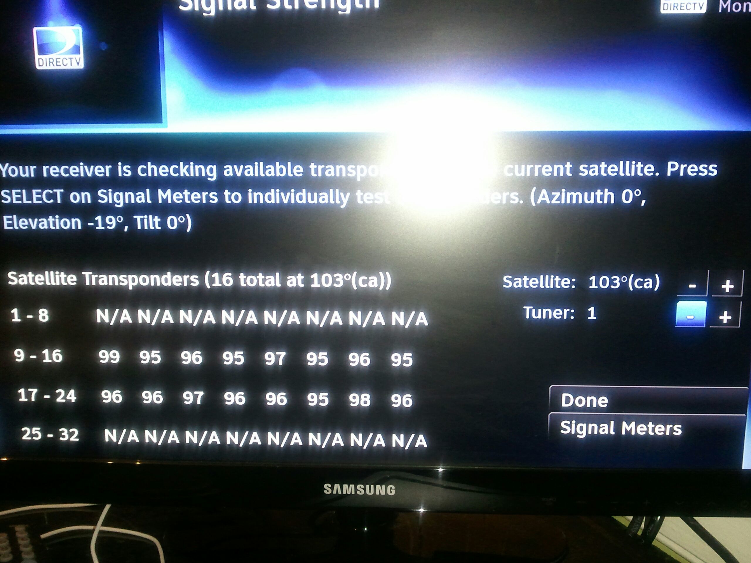

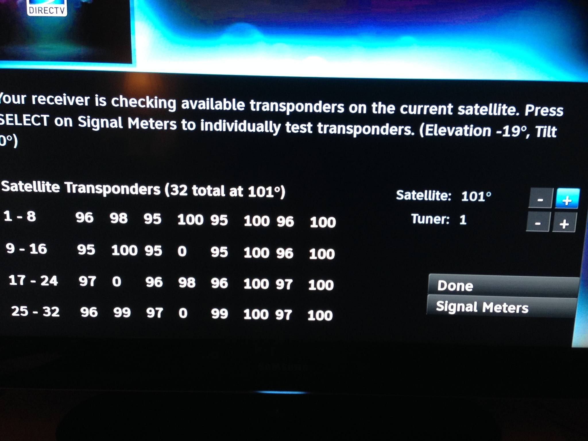

I ran a signal test and this is what it showed. Any ideas??? Please help!
That screen does not tell us anything. It shows the SD transponders for Sat1.
Look at the 99c, 103ca and 103cb screens for both tuner 1 and tuner 2 and post those numbers.

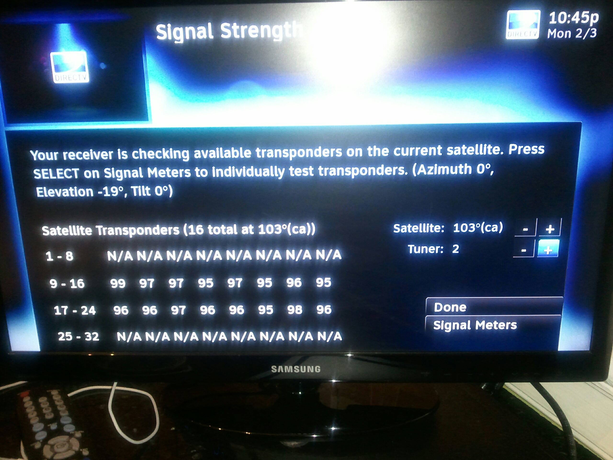

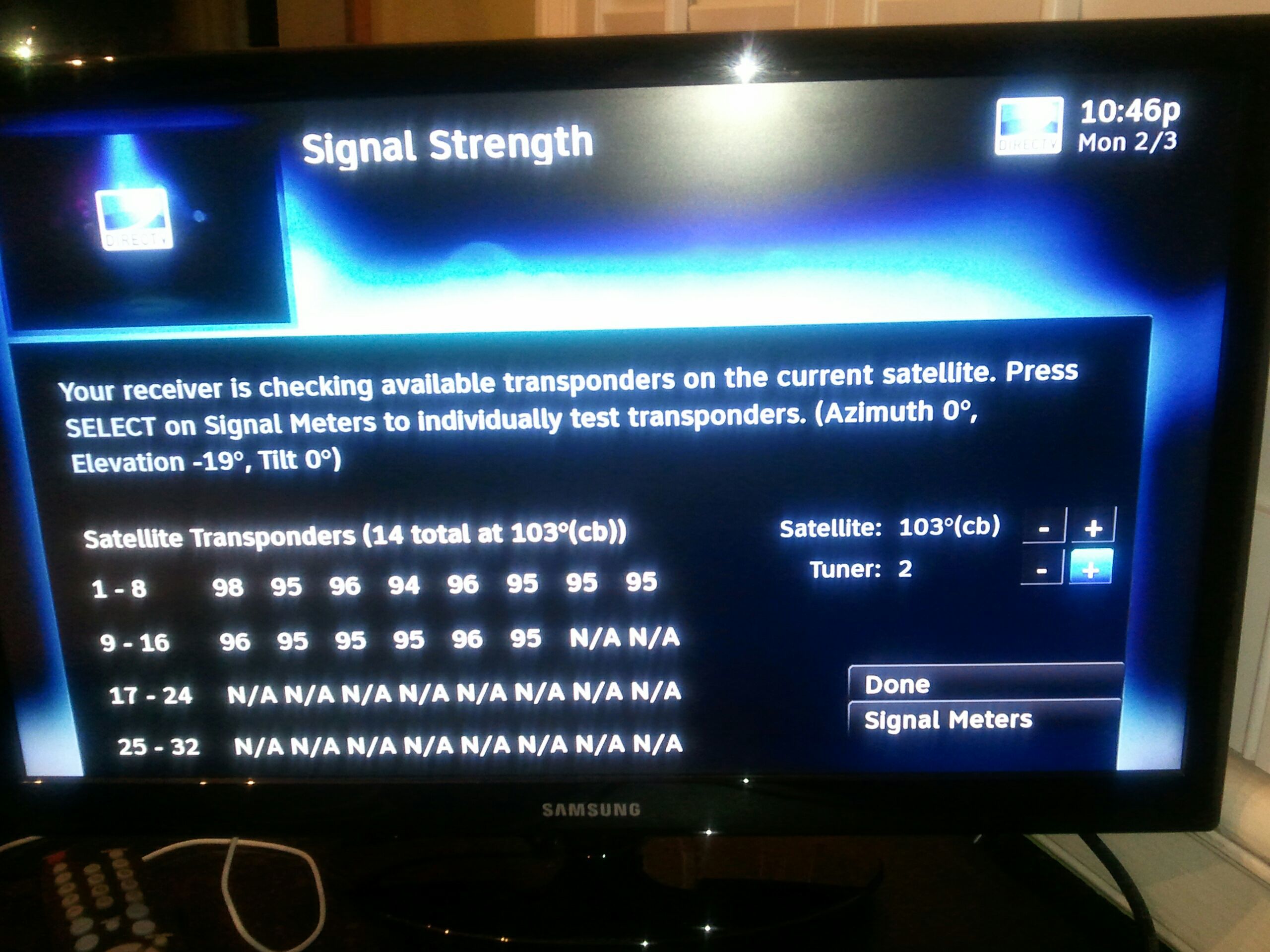

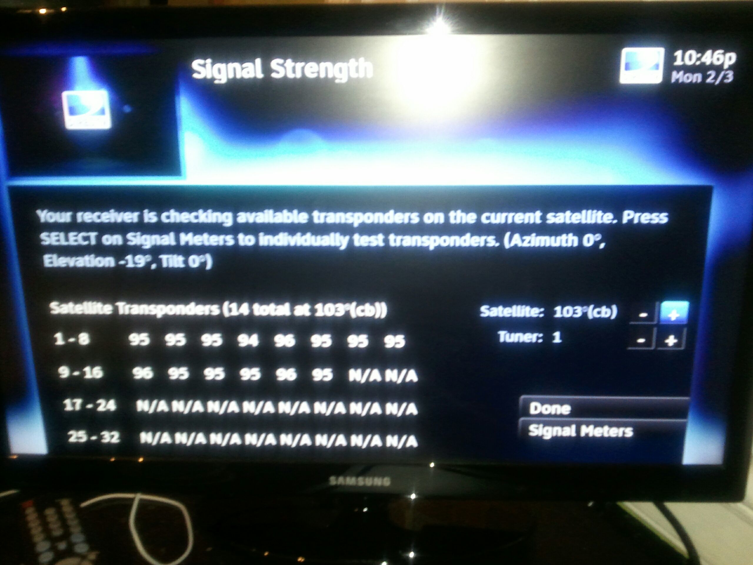

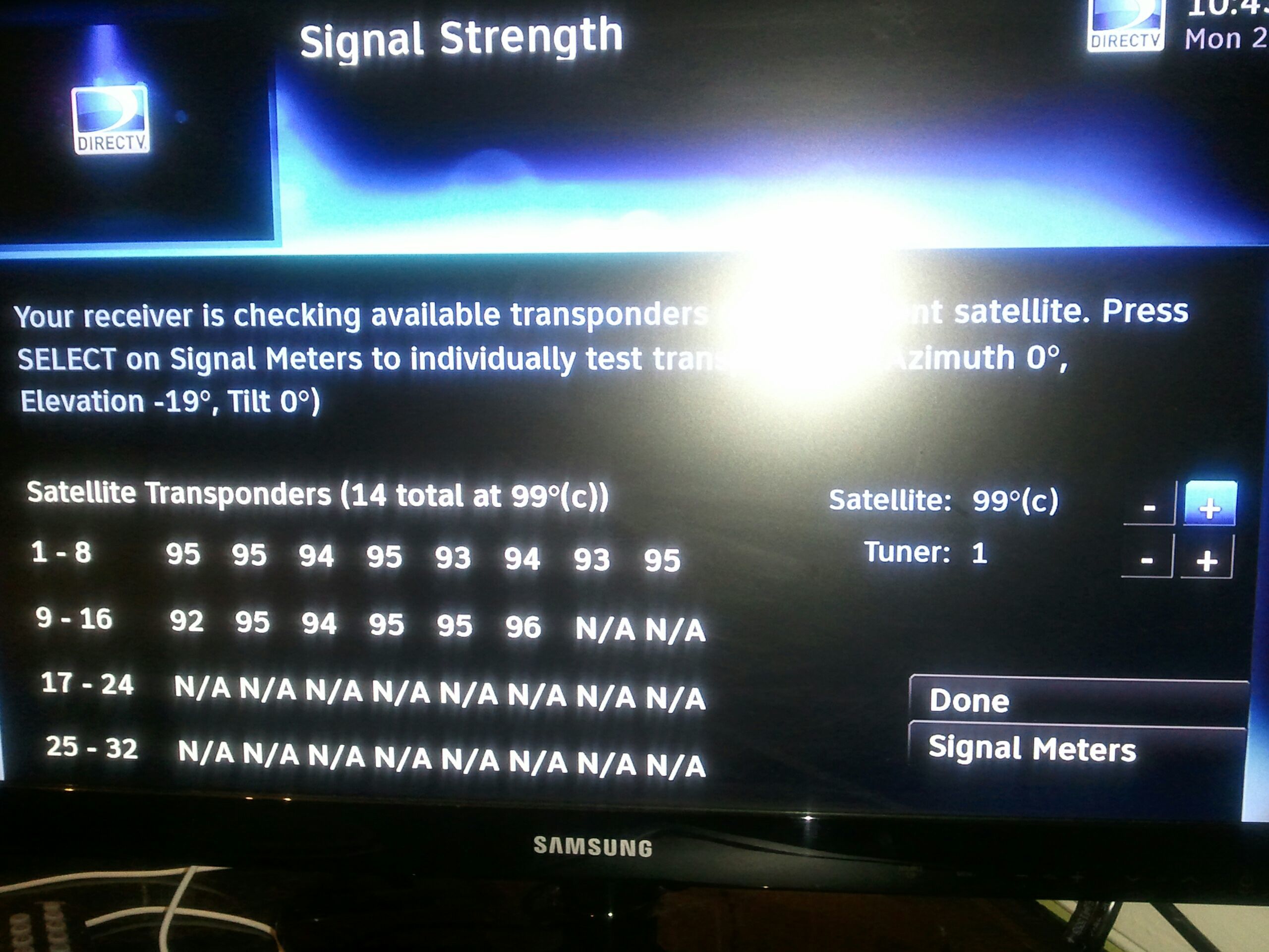

Here are the pics showing the screens. Sorry for the poor quality.
I hope you guys can make sense of these numbers. I can't!
Those signals are great.
The SWM16 is split into two sides each supporting 8 tuners. Do you have more than 8 tuners (4 DVRs) on any one side?
Your problem could be caused by a problem with one of the cables from the dish to the SWM16, but it's really difficult to know because if its intermittent it might not show up on any of the signal screens. But it would result in messages saying your dish needed alignment if you checked while the problem was occurring.
