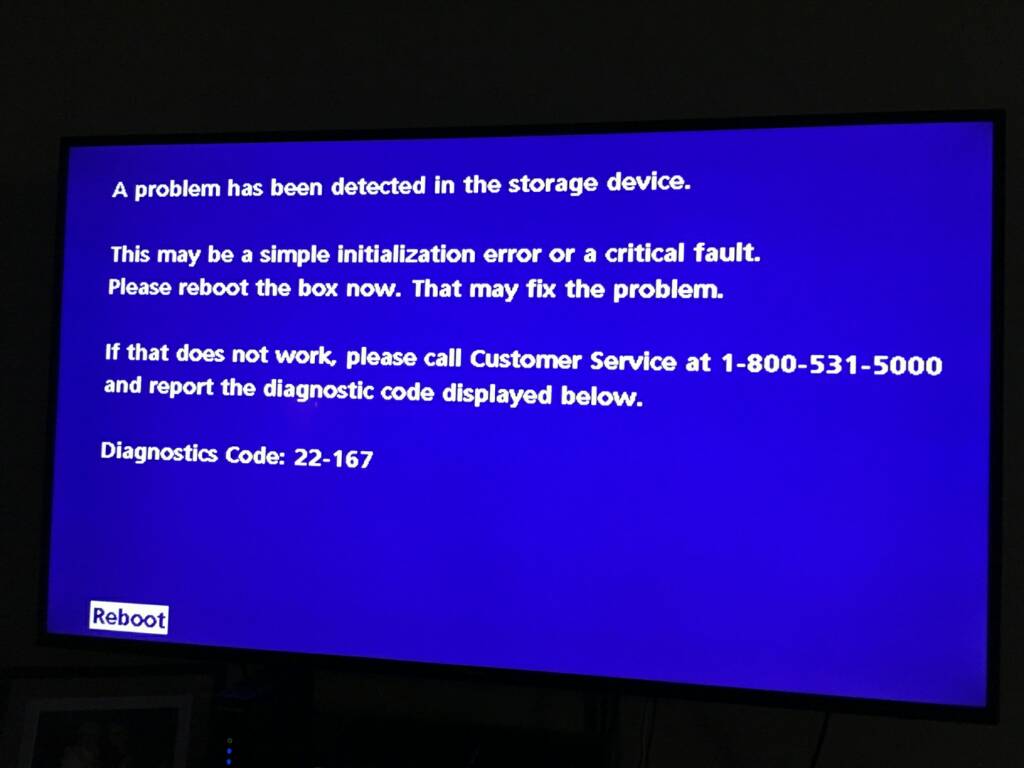

Anyone know ??

If you have rebooted and you still get the same message, the unit will have to be replaced.
  • Error in the receiver's hard drive.
Yep, hard drive issue. If you can get it to boot (may have to try repeatedly) you can do a graceful shutdown and try to clone the data to a new drive depending on what the receiver is. If a genie, it would violate the TOS. If older, DirecTV does not want them back. There are threads about using Gparted to clone. I've done this many times.
If you have to replace it, you'll lose all the recordings on it. :(
usually yes. H23 and HR23 and lower they pretty much dont care though.
Same thing happened to me last week with an HR24 receiver. They replaced it but don't want the bad receiver back. I have 2 HR24s now in the garage doing nothing.
There is a local repair guy says he thinks its the power supply causing the Hard drive to fail is that possible
