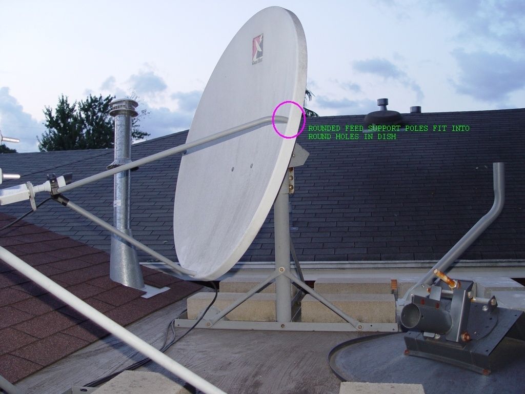

RV1pop, be sure to order the correct legs. As ACRadio mentioned, the ones in the links above are for the transmit/receive dishes, and do NOT resemble the ones on the dishes you and I have. The legs you want are round poles on both ends, one end is not flattened as in the pics in the above links.
The attached picture shows similar poles on my 1 meter Channel Master. The 1.2 uses the same style, but a bit longer.
The legs for the 1.2m dish from Future Vision are the correct legs for his dish. I have bought several from them and they all were correct. The feed support legs for a 1.8m CM dish has one pole with a flattened end.
They also make a set with a flattened end for a 1.2 meter...I have one. It is a transmit-receive dish with a support arm for the BUC...I was just going by what was pictured.

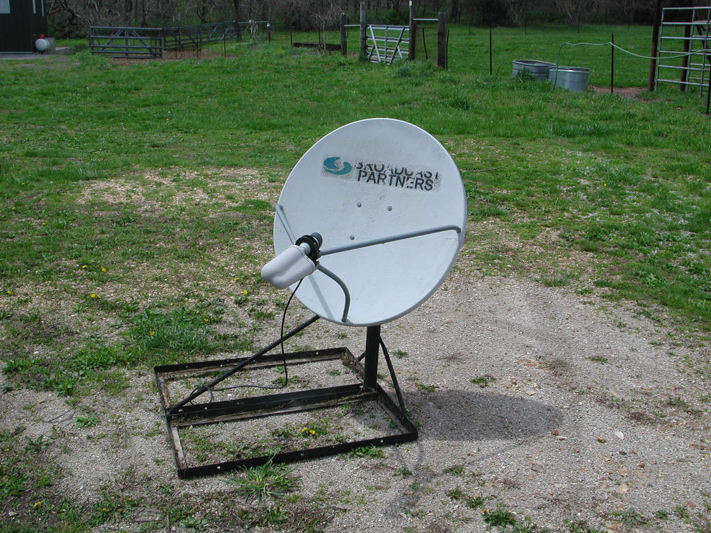

Thanks again. The pressure washer and a little solvent has removed the decals. I am removing the tin dish and replacing it with a 75cm, so I can take the tin one with me to CA. Going to stop by SatelliteAV and have them look at it. I will not try to use it again here, but might set it up in town for someone.

TRON, is the bend angle in the bottom leg on the 1M the same as for the 1.2 M? It looks like it might be. I have the 1M I could copy which might save me a little money if the dish does prove to be badly damaged. The crack is along one side about 1 to 2 inches in, the dish does flex there some. The edge is cracked but does not seem to flex, so if it works, I will reinforce the back while holding the front in place.

POP, I may be wrong, and you probably already know this, but those support tubes appear to be made from electrical conduit (1/2" EMT?). If you could get your hands on a conduit bender, and someone could provide you with some pics/measurements/tracings those things would be easy to make. Good luck and please put up some pics when you can. :)
Thanks, phlatwound, I have the conduit and the bender. That is what I was going to try to do. If the angle on the bottom one is the same, Then I can find the hot spot and bend the side ones to fit. I have a GOOD 1M to copy if they are the same.
I figured you had a plan, good deal. If you get good at making them, next time you are in Springfield I'll let you try to make one for this one, it's got a crack in it also. :D

RV1pop, the bend angle APPEARS to be the same, not entirely sure on that one though. The legs are a bit longer. You'll also need the part they refer to as the "junction" (which is the feed assembly holder).
If Popcorn got the correct legs when he ordered, you'll be okay. They're probably just using a stock picture which has the flattened poles in the link. Also, since Andrew bought out Channel Master, I believe the design of the feed assembly has changed on the newer (Andrew) versions of this dish. Just be sure to specify that the dish you have is a pre-Andrew Channel Master TVRO dish (receive-only).
