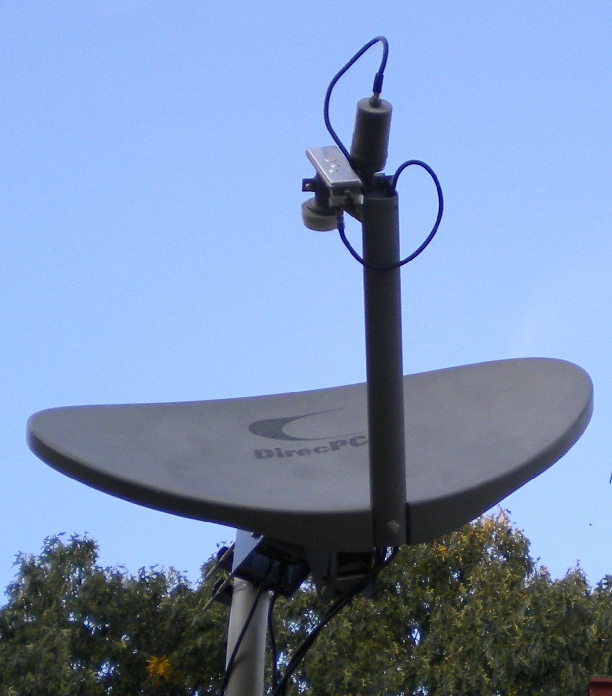

Thanks to the great information here - - - I finally got my new motor working.
Using my old DirecPC, some PVC, plywood and a DG-380 motor I finally got on the arc today.
I think the biggest challenge was figuring out how to match the dish up with the motor. In the end - - -- It was some research and alot of trial and error.
I liked working on this project but it took alot more tinkering than I orginally thought. But I learned alot about motors and my receiver.
I may move my GeoSatPro 90 over to 83 West since RTN does not come in to well with the motorized setup.
Here are some PIX.

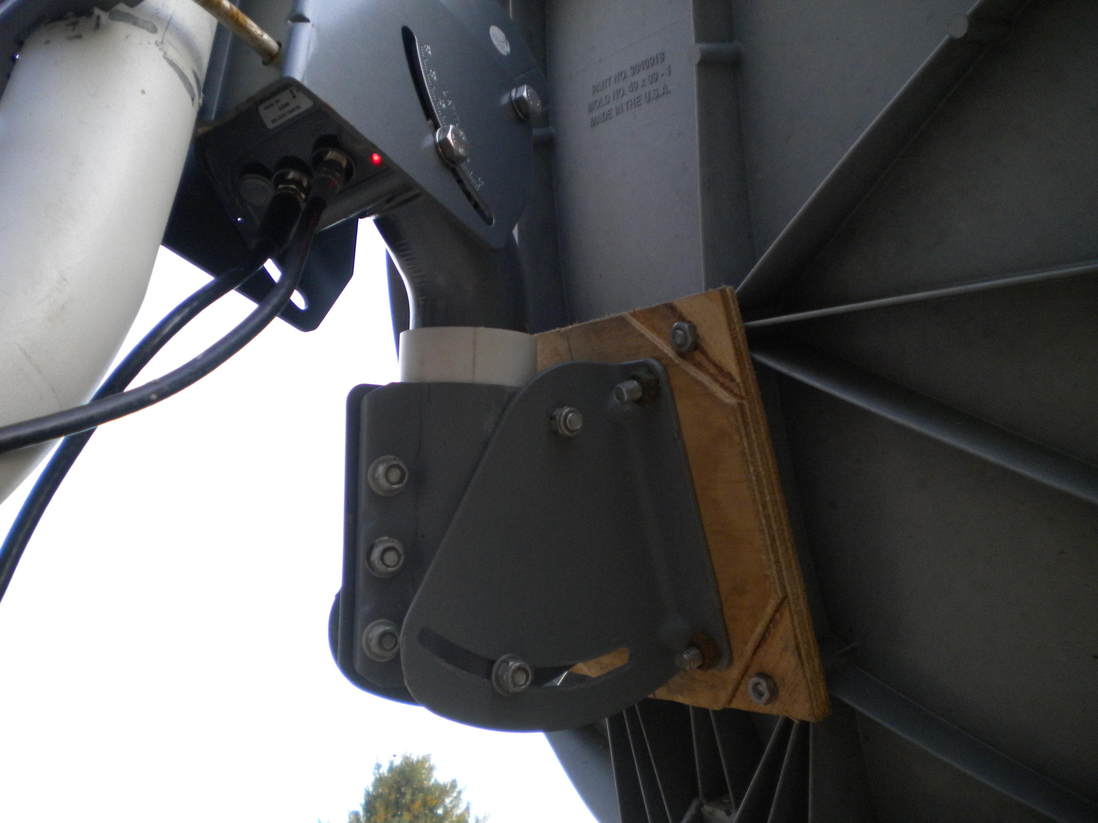

Original Mounting Bracket
This was the original mounting bracket - - - except it used to have a metal swivel for setting skew.
My first try I had the dish mounted upside down still using the metal part but in that config I could not get enough elevation to make the dish work.
I removed the metal part and made the wood part - - - still trying to mount the dish upside down.
In the end - - - I decided it was better and easier to point right side up.
I think now I could have made it work with the metal part but I think I like the ghetto look. :)

Good job and pics
I would add one thing to the build.
Since I get like 45" of rain a year I light to pre-prime and paint anything I put outside made out of wood or metal.
It take a bit longer BUT helps make it last longer.
Good luck with your new setup.
:up
That is a good idea
I like your idea - - - I will get some lead based paint and paint the wood with a brush.
