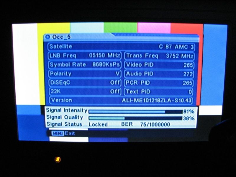

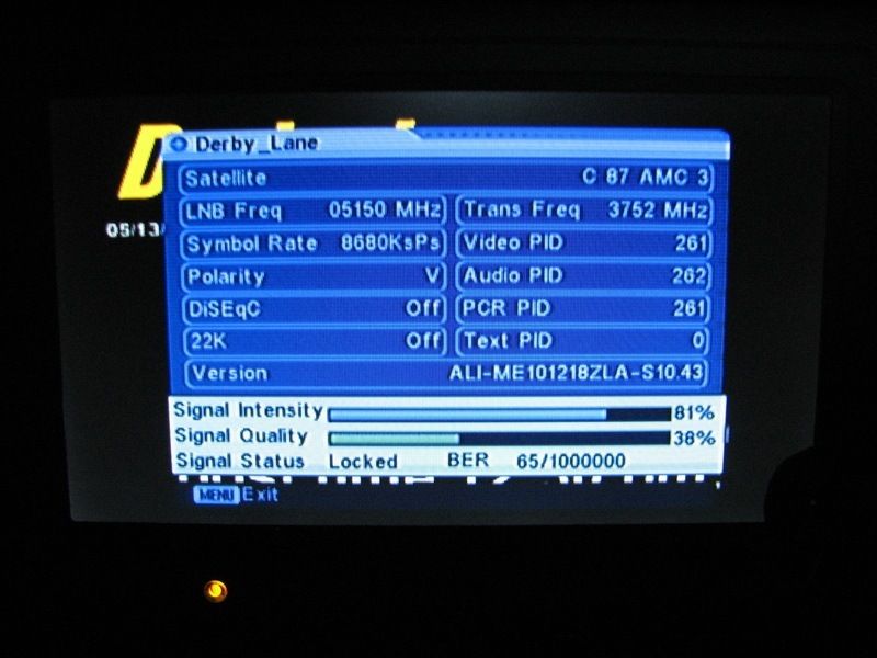

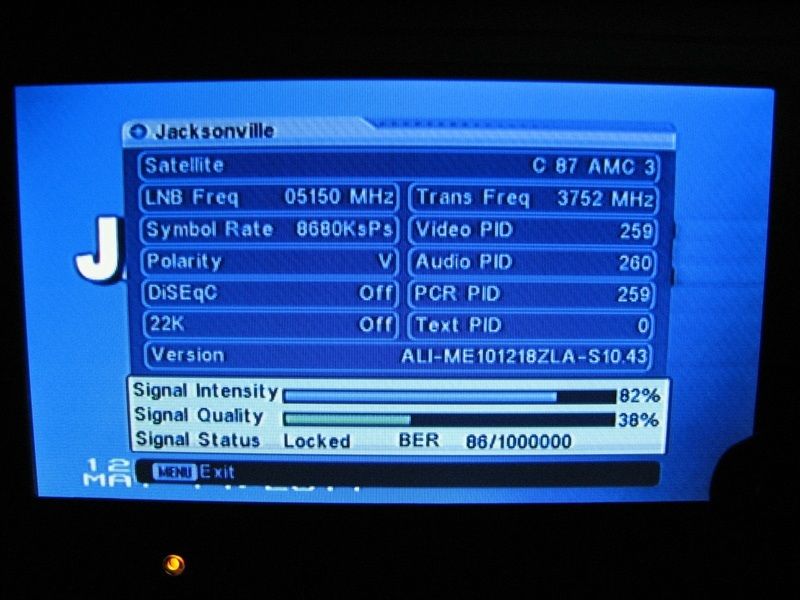

Conky said:
what is the most likely cause of her getting signal at night but not during the day?
Orbit position?
Sat position at different times of the day?

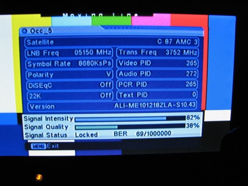

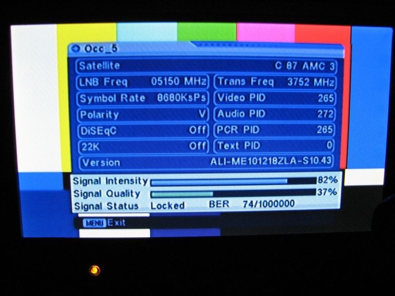

I recounted an experience some posts back about 99w whereby during the day signal was great and then at night the Quality would drop off for a few hours whereby it was unwatchable and then it would creep back in and settle down.
This was an issue with the scalar rings and feedhorn being misaligned to the dish. One quick adjustment with a hammer and the problem was fixed!
Sleepless...after reading all the advice and opinions here. :D Just remember guys, she already put a number of dishes in her backyard, no way she's going to ever quit on this hobby, until sat signals are in the air.
from looking at some of the pics she has posted she is barely above threshold quality wise when its locked. Due to the satellite not being in a fixed orbit (also known as wobble) the satellite probably gets further away at a time resulting in no signal. During the night its back closer and the signal goes up.
Seen this happen with folks who are on the edge of a DBS satellite.
Some ways back in this very thread, I posted an answer for this problem by Corrado.
Thanks to some great night photography, we can see this still needs to be done!
before (terrible) . . . after (still needs work)
Till the scalar and LNBF are aligned, all the rest of the discussion is a waste of time.
Dee

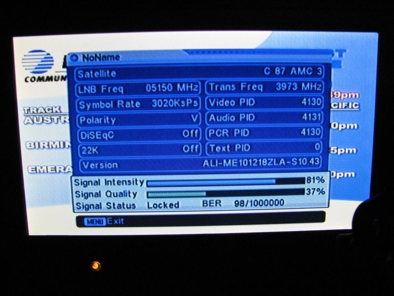

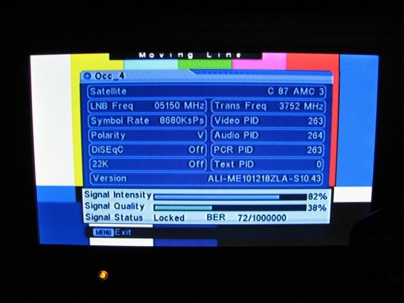

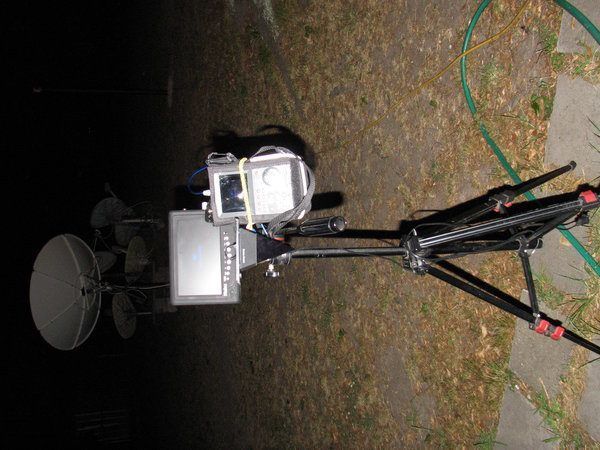

A few days ago I totally lost MeTV even at night. NOTHING I do will bring it back. I've tried everything. It had been where it worked ALL THE TIME, then it went back to fading out in the day time and working only at night, then it quit working at all.

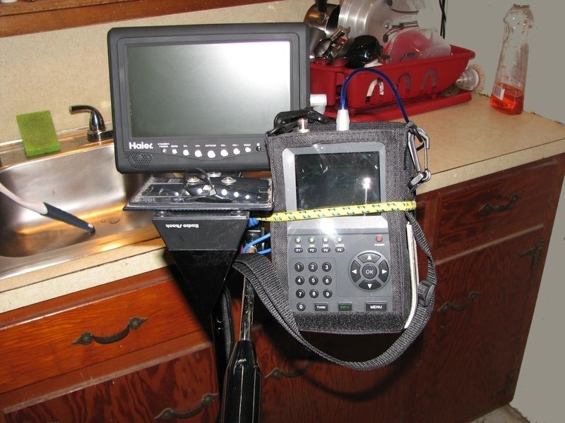

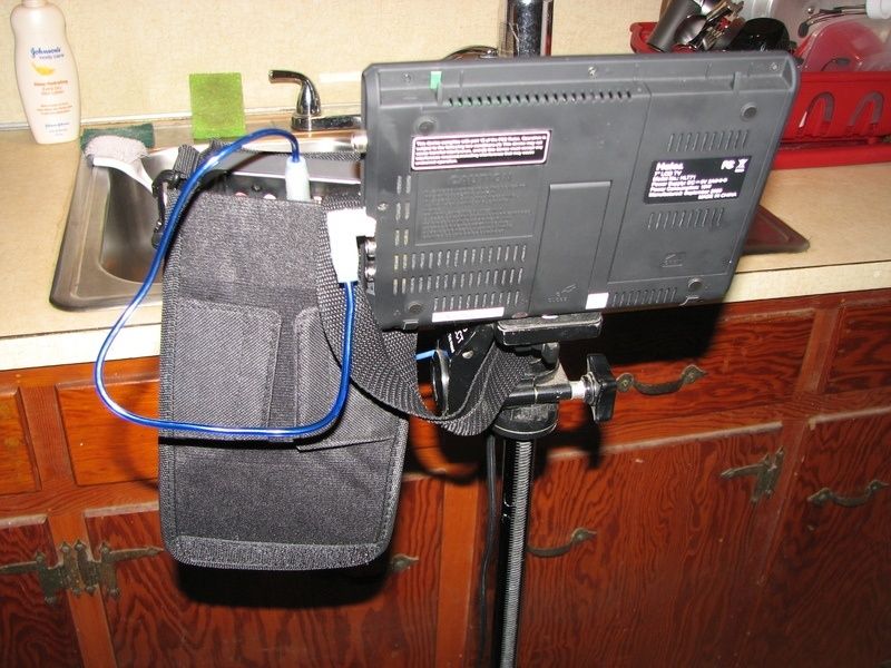

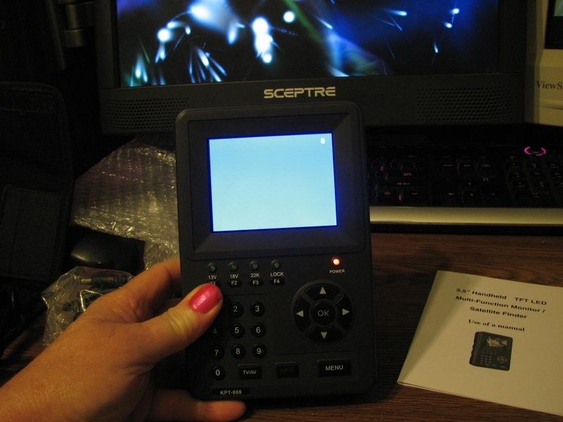

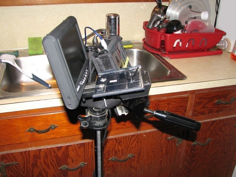

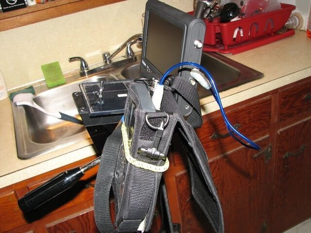

Today that little meter came in. I added it onto the tripod with the little tv because the screen on the meter is too tiny for me to read even with my stronger glasses. I plug it into the little 7" tv and I can see it fairly well.
There is no point in trying to tune it in during the day, it never comes in there and at night the mosquitoes eat me alive. I fought the stupid thing tonight for about 45 minutes before the mosquitoes ran me in. And that was the end of it. I folded up my little tripod, pulled the wires down and packed it in.

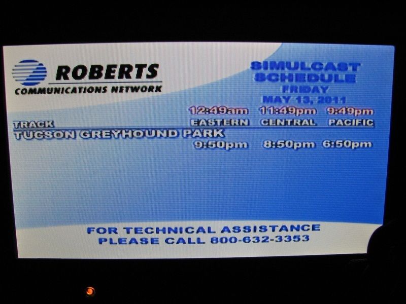

I was able to find the stupid horse racing nonsense on 87 but I can not find NASA, this or me tv anymore.
So to h*** with it. WEEKS and WEEKS I've been fighting with this thing and I get nowhere with it. Every once in a while it will work for a few days then just quits even when I DO NOT TOUCH A THING! I'll power down the gbox and absolutely NOT TOUCH IT and it just fades out and goes away.
So I just have reached my limit on this garbage.

There is a USB port on the meter but the booklet says in Engrish not to mess with the port and there was no software that came with it. So apparently they don't want you to do it the easy way on your pc. Manual entry is the only option.
I also would like to be able to download a copy of everything I entered into the meter in case it crashes so I don't have to do that all over again!
Also, I found replacement batteries on ebay for it, I used a digital measuring thing my dad gave me to check the size and I matched up the values of volts and stuff so I am certain this is a usable replacement battery. Just in case..

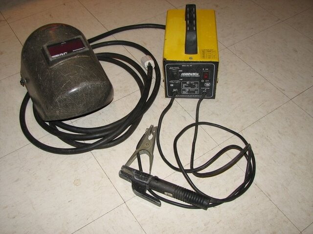

On the 10 foot dish.. I called my dad today and we talked about it. He told me to go over to his house (they are still out for the weekend) and go get a little bitty welding machine and bring it here. The whole thing is about the size of a kid's lunch box but weighs about 250 tons.... :(
I've helped dad before with welding and he taught me, well, kinda, how to weld. So he told me I could stick the pieces he made to the ring so they are in the right angle and he'll come pick up the ring Monday, clean up my nasty welds, finish welding it properly and clean it all up in general.
So I got the little welder, a hood and some little welding rods from his garage and brought it all home. I had a lot of trouble figuring out the hood because it has a battery in it so that when you're not welding it's easy to see through and when you start welding it goes dark. That didn't work too well and I got blinded a few times before I figured it out.
Then the breaker kept tripping and I would have to stop and wait a few minutes for it to cool off then try again. I could only get about 5 seconds at a time on the breaker. I called Dad and he said the welder takes a BIG breaker and I had it plugged into a little 15 amp breaker. Not enough!
So I globbed up a nasty mess on the ring and the clamps enough to hold it in the correct position. This may have cut a day or two off the process and I saved my dad some trouble by doing this step myself. He said fixing what I did will be easy and not to worry about how ugly it turned out. He has a BIG welding machine at his place that will fix anything.
The little one I borrowed is just for very minor things like what I did today and isn't a real welder.

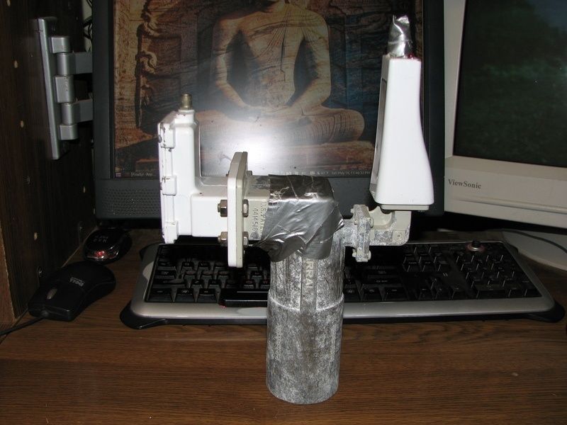

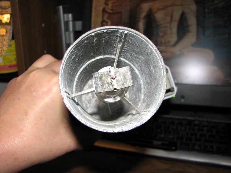

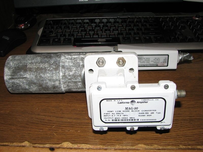

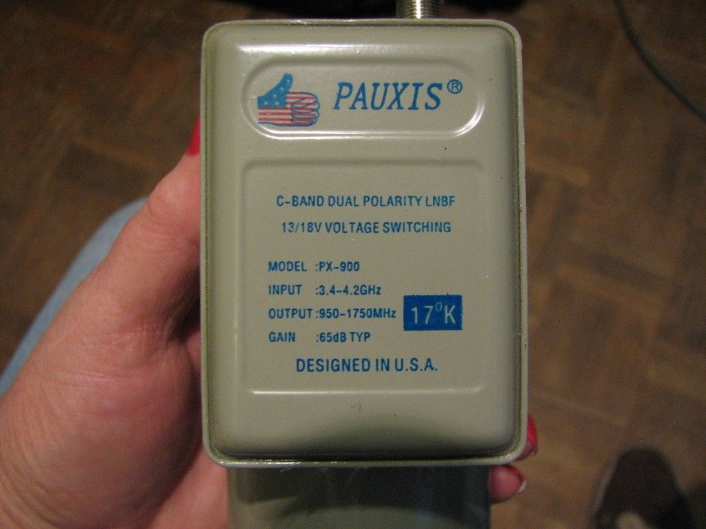

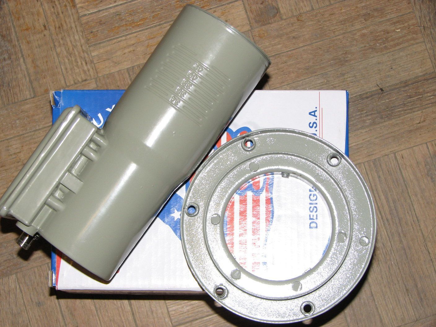

So, the little dish problem... Maybe it's the EL CHEAPO lnb I bought on ebay? I bought the cheapest (like $10 I think?) lnb I could find that doesn't have a motor on it to change the polarity. I guess it would be called auto polarity? :confused:

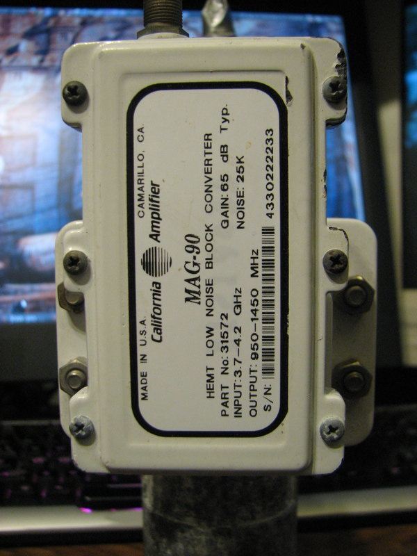

I found an old Chapparal lnb in the tool shed with the other junk. There was a motor on it but the motor was frozen up. I took it off to put oil in it and the gears kinda spilled all out so that's a goner. I also sorta broke a plastic thing in the lnb that connected the motor to the rods in it that rotate around. So, I stuffed some foam rubber in the hole where the motor went and put duct tape over it to hold the rods in place because the were just spinning around freely inside.
Hopefully the tape will keep the water out too though I kinda have my doubts.
So I realize that this lnb now can no longer change polarity, at all. Perhaps I can manually rotate it around to the right spot, lock it in place and leave it be. Maybe it's a better lnb even in it's broken and Mickey Moused state than the cheap Chinese lnb?
I was thinking that as a last resort I could use the ku side of it and point the 6' dish at PBS but I see they are both H and V channels there. :( I guess I could use it only for the V channels since it appears that the HD and S2 channels are all on V channels.
I suppose that I need to look into a proper lnb. I don't want one with a built in disque switch or one of those other kinds of switches that works on tones because they won't work with my existing stuff. So if I get an lnb that does both ku and C I would want it where the two signals go down separate wires and not combined into one wire. I can run the two wires into my 8 way switch as it has several open spots on it now.
The lnb, actually, I guess I might need two of them IF I keep the little dish, needs to also be affordable. I sure can't afford a darn $150 lnb!
The more I think about it, the more I want to blame that cheap lnb from China. Very rarely does anything of quality or value come from that country.. :mad: And dummy me, I bought two of the bleepin things!
