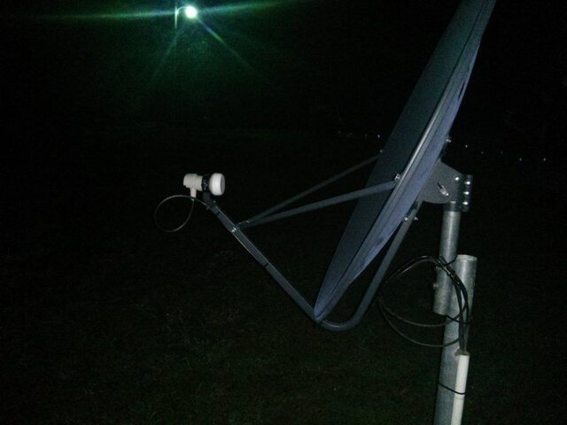

The LNB is 100% stable btw. I can rotate it for skew if I put a lot of muscle power into it, but otherwise its aiming directly toward the dish
Did you assemble the post clamp in the butterfly bracket with the through-bolt going through the hole stamped "A"?
If so, looking at the scale "A", the pointer is a flat price of metal (originally painted white), visible on the left side of the elevation nut, it should be pointed to approximately 54 degrees.
The LNBF skew in the photo looks right for your area on 97w satellite.
Placing your phone on the metal dish will cause the compass to be inaccurate. Stand a few feet behind the dish and find a landmark like a tree, utility pole, etc. that is far away that lines up with compass reading 178.
Now review post #2 of this thread for how to setup the receiver and aim the dish.
Good luck!
Alright! so, it's assembled just like you say. When it's at 54 degrees on scale A, it looks very very low, there are other satellite dishes on my neighbors homes and they are aiming much higher than mine is. It's like aiming towards the fence. Is this to be expected with this type of dish?
I can tell you, from installing satellite systems for almost 14 years, that having a good, stable, and plumb mount are the keys to getting a satellite dish aimed easily and correctly. I recently aimed my first GEOSATPro 36", which looks like what you have. The elevation was a little hard to determine on mine, because the white mark they referenced in the documentation, was obscured by the nut on the elevation adjustment. I figured out it's roughly the metal edge you can see through the elevation adjustment slot. Anyway, point is, don't skimp on the mount, make sure it's plumb, cement it in, as long as you have good LOS (Line Of Sight) you should be able to tune it in. I'm not familiar with your receiver, but mine showed no signal or quality until I ran a Blind Scan. Ku FSS signals are pretty weak, so it takes a bit of fine tuning to get decent signals on them.
All that said, I'm very new to this, and this is just my advice as a Dish/DirecTV/HughesNet installer.

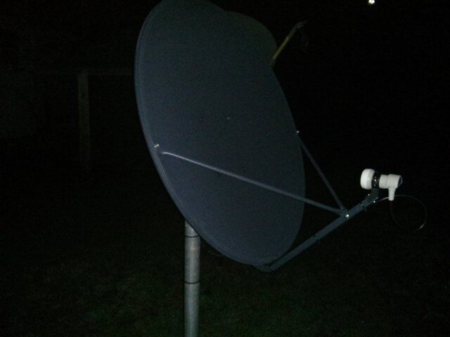

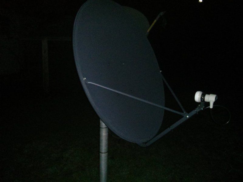

Here are some pictures of mine, these are bolt hole A, about 50 degrees elevation on scale A, just to give you a reference. My LNB is also only -2 degrees for polarity, so pretty much straight up.

Your dish looks exactly like mine at 50 degrees. I guess it's correctly set up!
(Question: Do HughesNet dishes transmit? Is that why they want the LNB back?)
Mine works, it's aimed at Galaxy 19, 97 West, and I'm in southeastern Oklahoma. G19 is 184 degrees azimuth, 50 degrees elevation, and -2 degrees on the LNB, if I remember correctly, for my location. Those pictures show the dish aimed at 97 West from where I am located.

The dish has a 24.62 offset angle. This means that the dish is actually aimed 24.62 degrees higher than the dish face angle. When the face of your dish is angled back approximately 30 degrees, it is picking up satellite signals from 54.62 degrees elevation.
If you look at dishpointer.com for the 97w aiming from your location, the magnetic compass reading is 178. This is only a few degrees East of 181, but be sure to use the magnetic reading when using a compass. You can also drag the pointer to the exact point on your property where the dish is installed to provide an aiming line to the satellite as a overlay on Google maps.
You won't be able to point the dish at 54.4 degree elevation and rotating the dish to the 178 degree compass reading and expect to be receiving satellite signals when you walk inside the house. The aiming is very precise and a fraction of a degree in elevation or azimuth and the signal will not be received. Set-up the receiver and a small TV outside beside the dish to watch the Signal Quality meter reading to locate and optimize the dish aiming.
The pounded in pole could work for testing. You might get away with a pole pounded in the ground until the first rain or wind, but it will move unless it is set in a few bags of cement with a bolt through the post or the post flattened near the base within the cement, to prevent it from spinning.
Thank you everyone - 99W comes in good! I never would've got this without 1. your help and 2. had I not figured out the little white elevation thing. The receiver beeped and said "LOCKED - 67 dB". Very interesting stuff - it's amazing how funnily bad the motion graphics are on some of the channels xD
