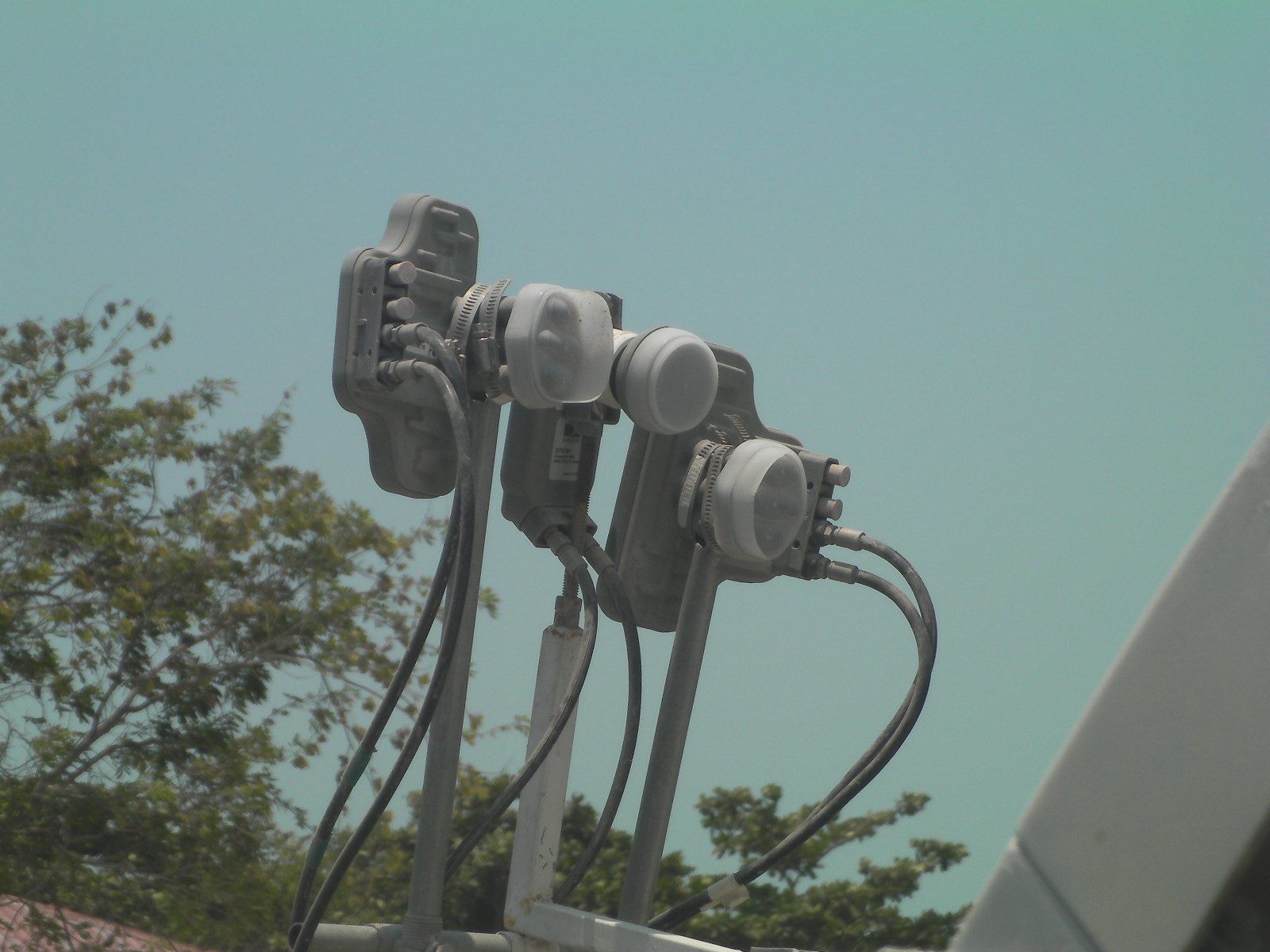

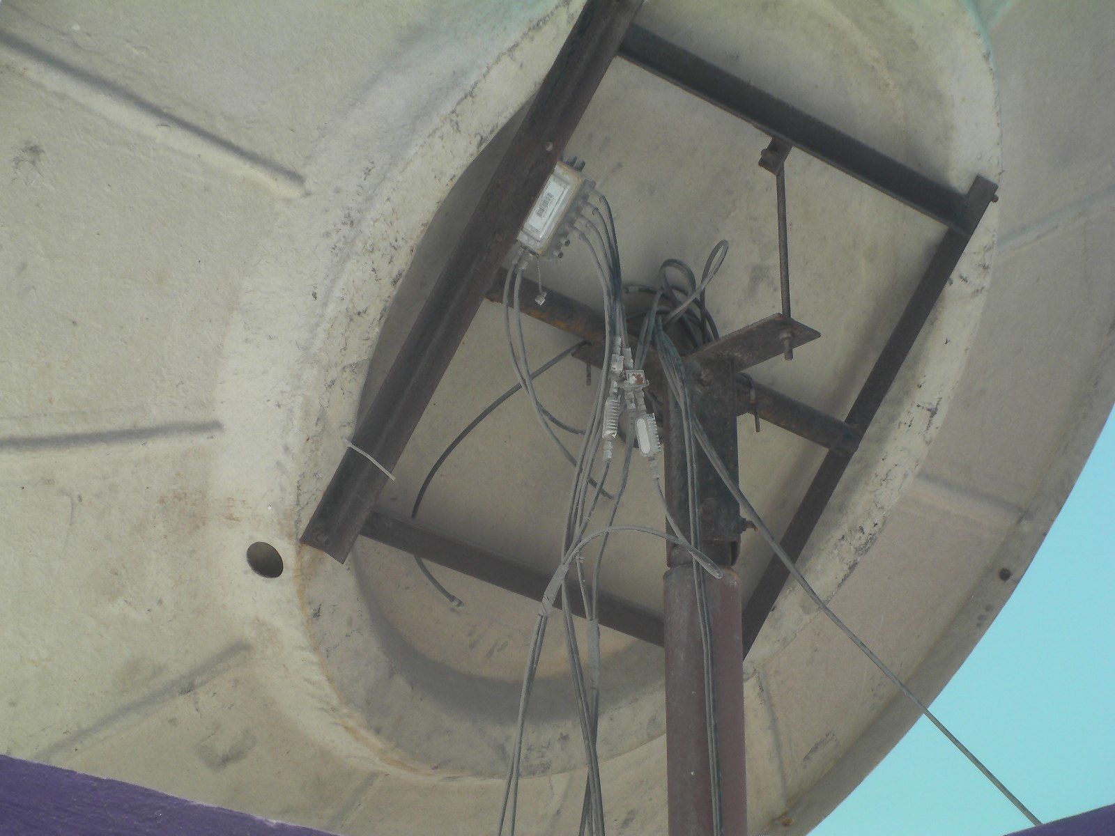

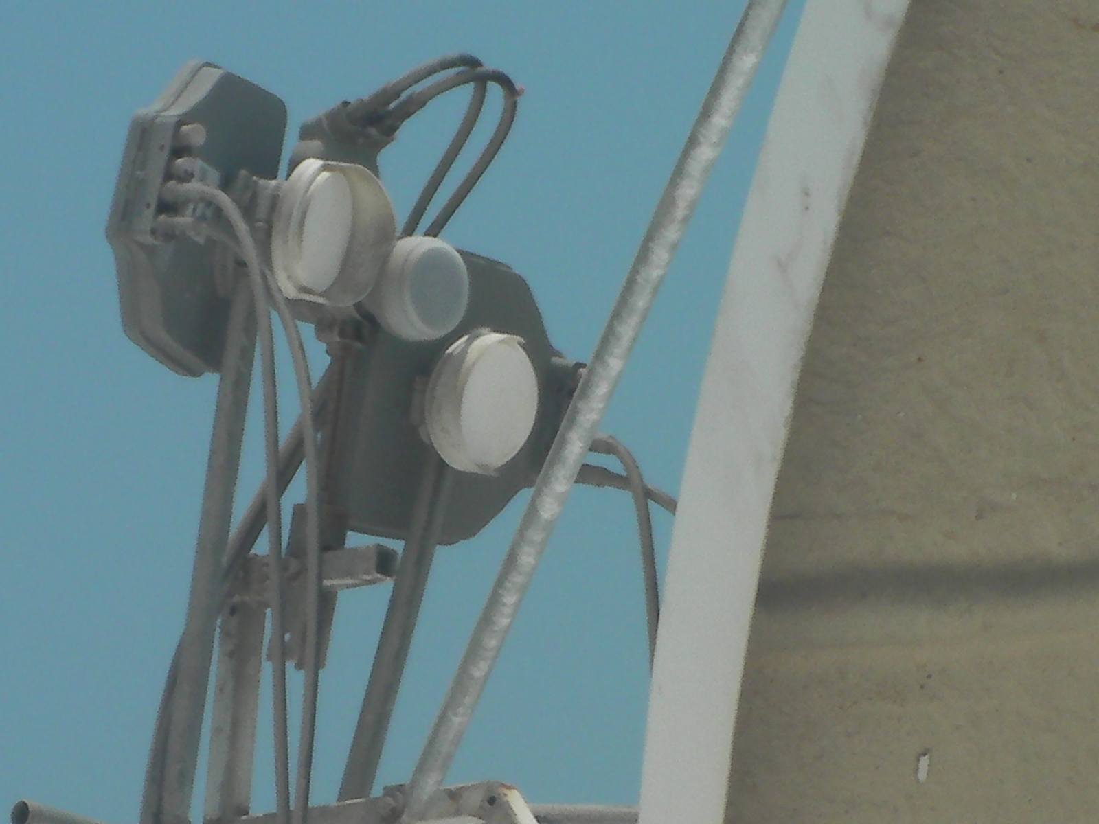

Here is the Directv setup I would like to accomplish.
This is for a 8 foot dish for 99W, 101W and 103W way South of the border. This is a non SWiM set up.
I will be using non-SWM lnbs and an HR22 dual receiver.
Who can help me especially with the switches ? (this is a set up for 2 receivers or one dual receiver, so I guess)
Will I be needing a Directv AIM meter for tuning or will the receiver show me the signal for Ka?
This is my first time ever setup on Directv.
Thanks !
I still think you are unlikely to get this working. There are no switches that will support this configuration.
The SWM8 or WB68 multiswitches both require four connections to the dish. Two connections carry the 99 and 101 signals, two connections carry the 103/110/119 signals. Since you are not looking at 119 you MUST use an SWM8 because of the way guide data is carried. But you need to merge and switch the 101 and 99 signals before they get to the SWM8 and that is normally done within the LNB itself, and as far as I know there are no external switches using DirecTV's technology.
Also the Ku LNBs within the Ka/Ku assemblies will still be active and you might pick up signals from other satellites which will be passed to the SWM8 in error.
The 101 is in the middle; the lnbs for 99 and 103 are set to the sides and only one of the 3 feethorns is used with two blank. The 2 blank feethorns are below the arch.
How can the signals be combined ?
You have been asking for our advice on this project for a while, and you have been given the same advice for a while.
If you have seen it working, you should go and ask whoever did it how they did it.
