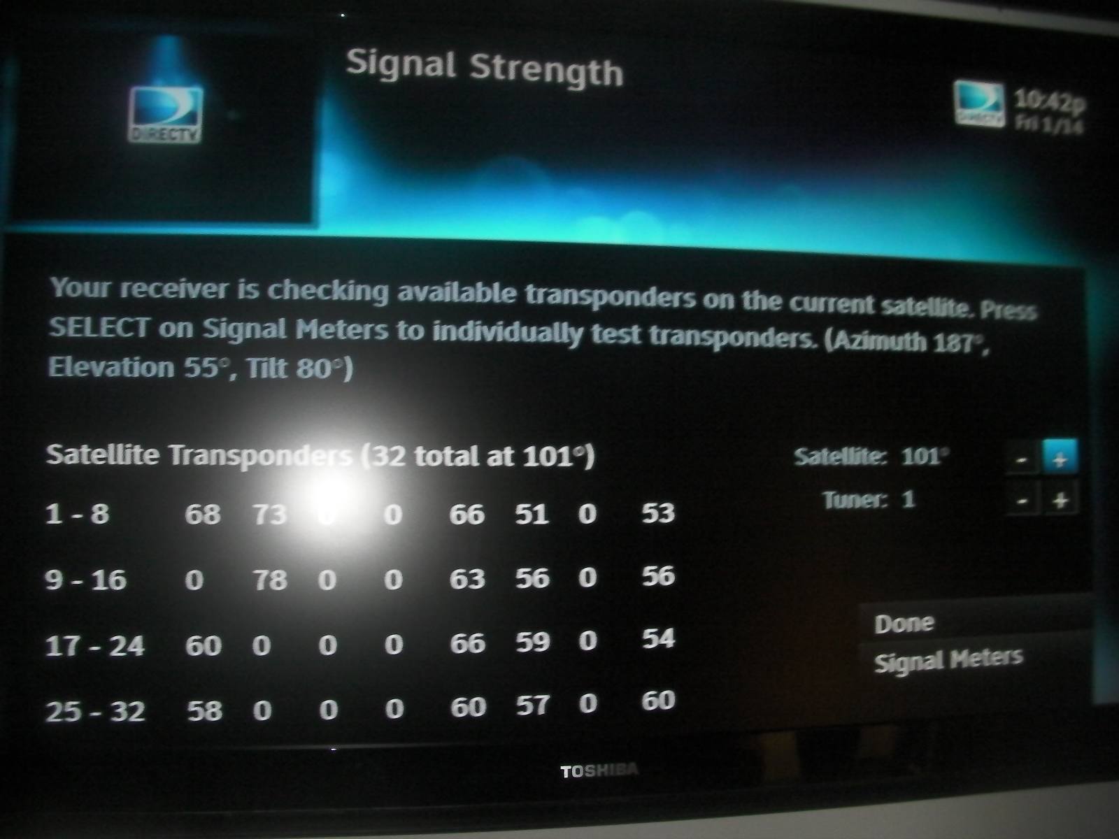

With so many transponder active, you are not aligned on 119 which is where I thought you might be. So exactly which TPs do you see signal from? Even if you are pointed at 101, the receiver will tell you "no signal" if the TPs it uses for start up are too low. Not sure which ones it uses, I know TP25 is where most of the firmware downloads come from. And if you are not aligned on 101, then 99c, 103ca and 103cb will show no signal at all.

<img src="http://www.satelliteguys.us/attachment.php?attachmentid=88975"/>
A D-12 isn't 15 years old
I had that D-12 already in 2001
that means that my foremost goal would be to tune up tp12 to over 60. Correct ?
I'd shoot for at least 70 to be honest. And if you had a D12 in 2001 that still is only 12 years but I don't think they've been around that long

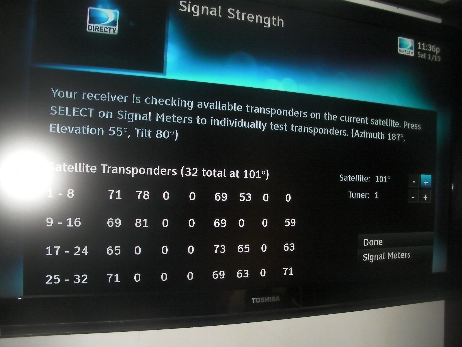

TP25 on 71.
Still not getting any picture:
Verifying configuration . . . "A satellite signal could not be detected. Please check your installation and re-test"
TPs 4, 12, 18,20,26, 28 will be zero for you because they are spotbeams pointed at different US cities. This means you are missing TPs3, 7, 11, 14, 15, 19,23, 27 and 31. All those TPs should be the same signal strength as all the others. You won't get the receiver to operate correctly until you fix that.
