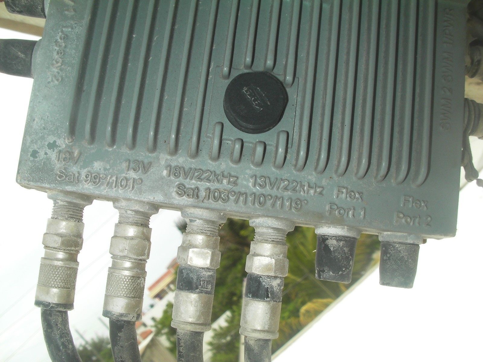

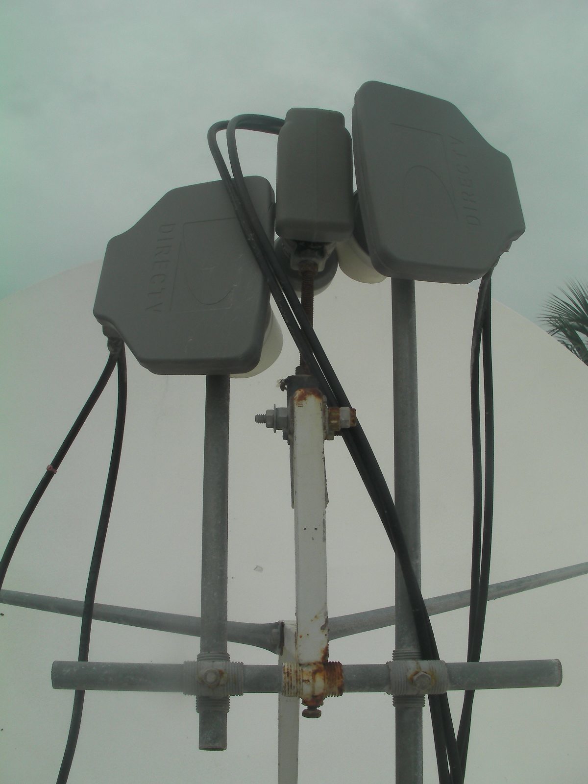

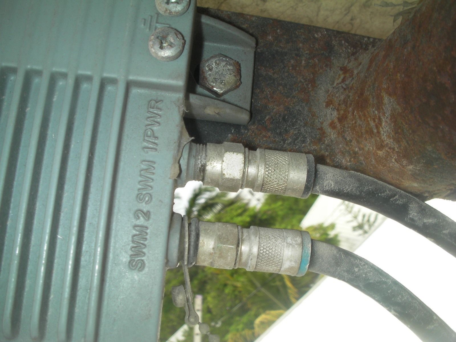

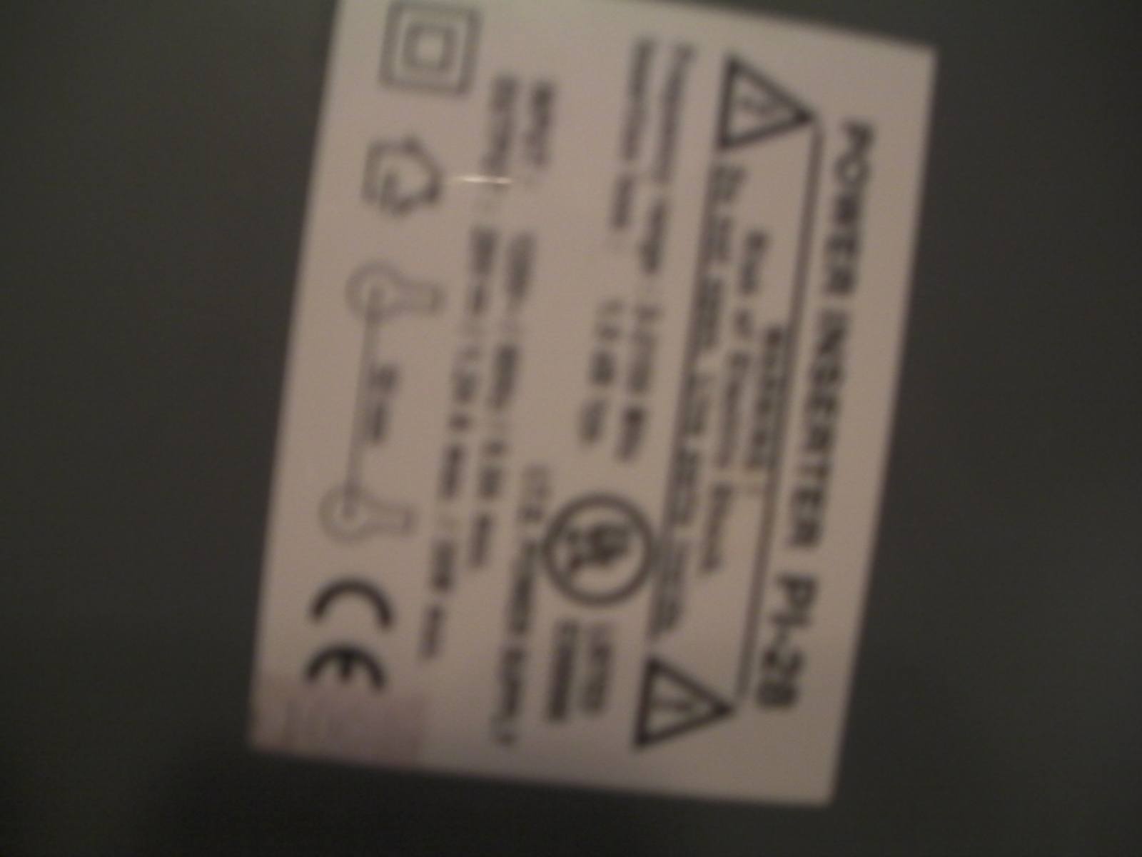

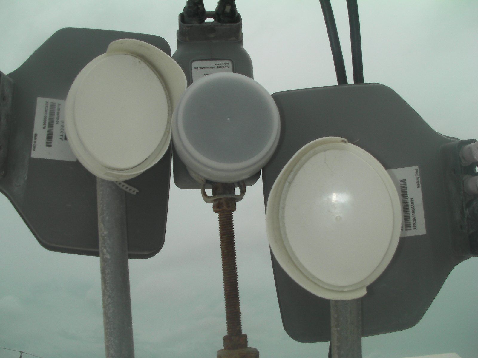

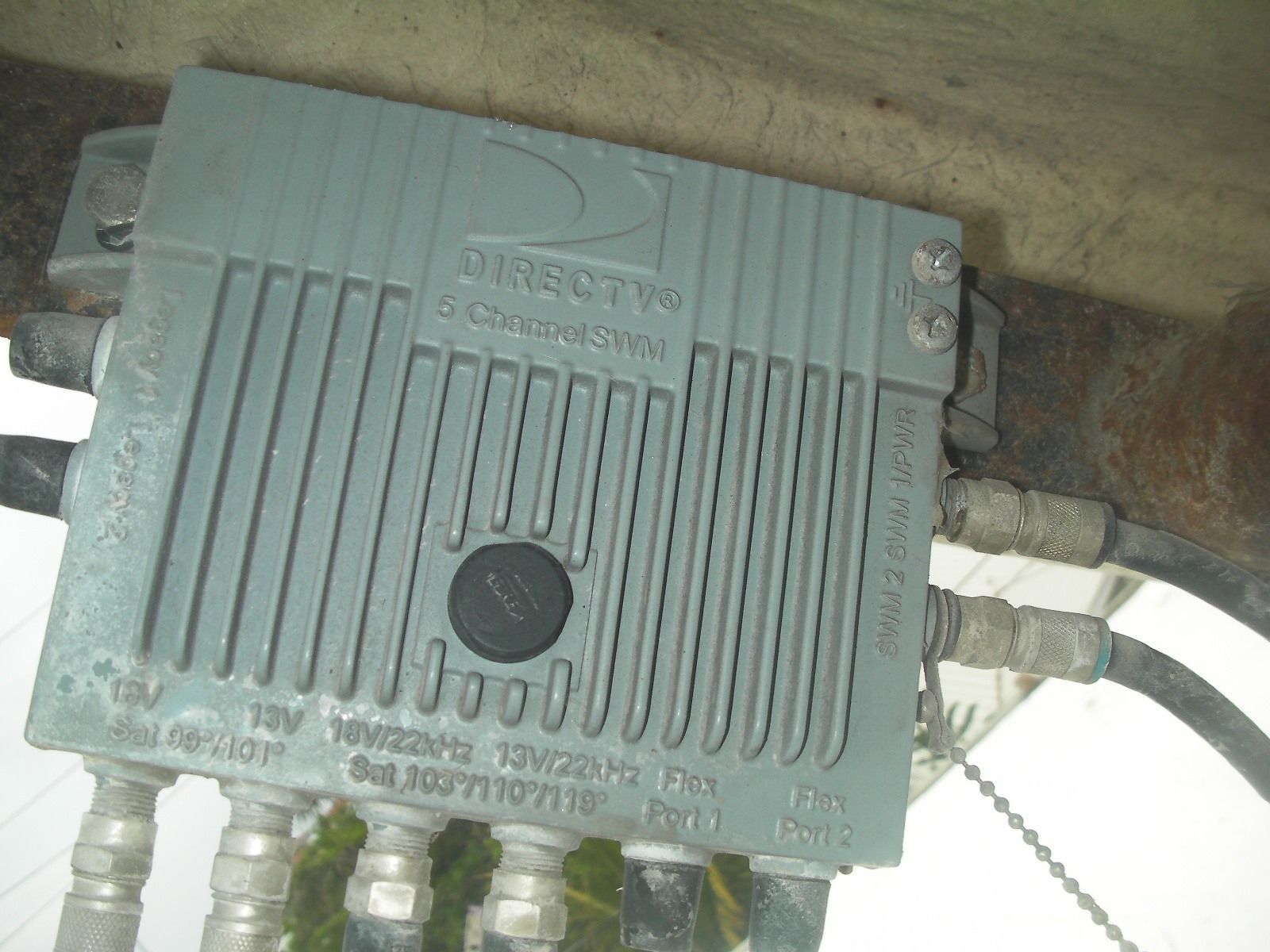

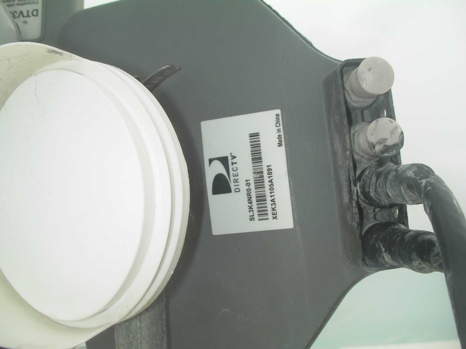

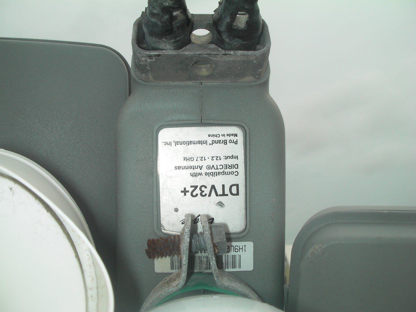

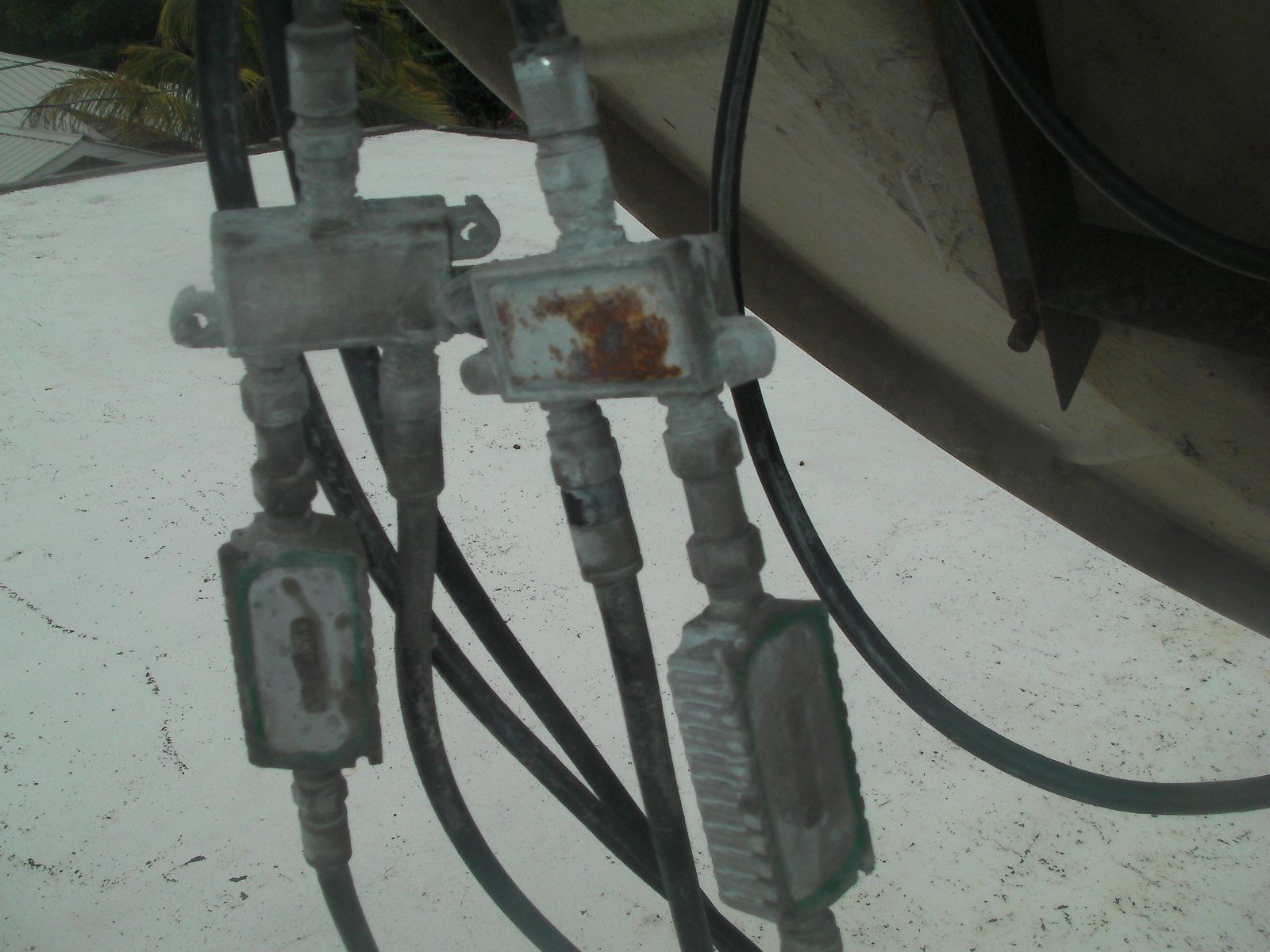

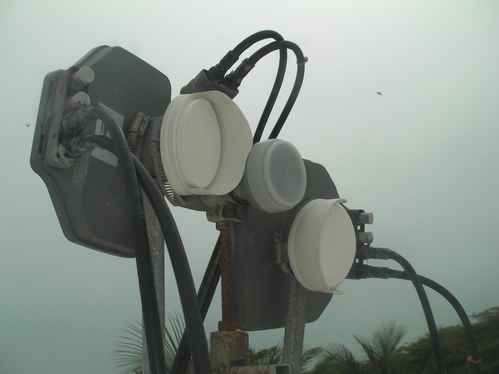

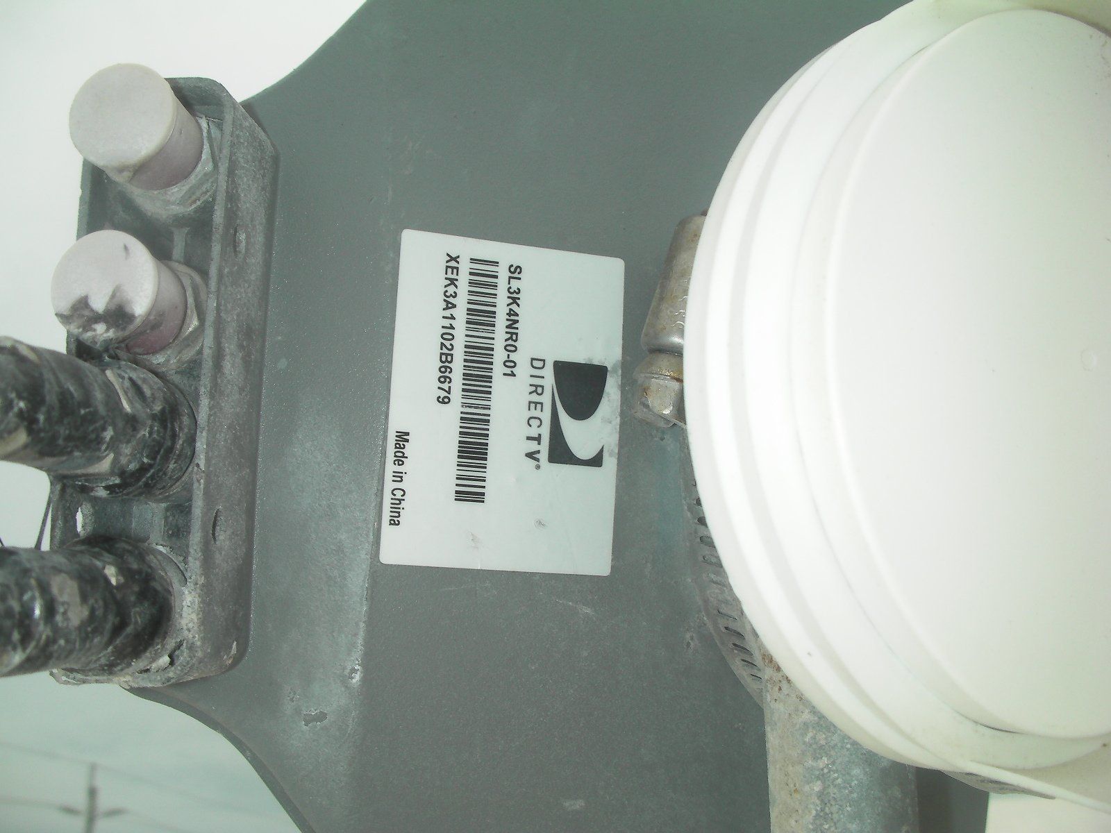

Here is what I observed and photographed:
Non SWM lnbs for Ka band. The right Ka lnb 103W (seen from behind the dish) is combined with the Ku 101W and the 101W has an inline amp before it is combined and hits the switch. The other Ku lnb 99W goes straight into the 99/101 inlets of the switch.
Every LNB uses two cables to the switch.
Two exits from the switch go to 2 receivers HR24 SWM. One receiver has the power amplifier which comes with the 6x8 SWM switch.
Let me know your thoughts. Thanks !
View attachment 88138View attachment 88139View attachment 88140View attachment 88141View attachment 88142View attachment 88143View attachment 88144View attachment 88145View attachment 88146View attachment 88147View attachment 88148View attachment 88149
I will be using a HR22 (non SWM) with 6x8 Ka/Ku switch, non SWM.

If you understood well the frequency plan, we need to ask ourselves these questions:
How to combine catv with L - Band? easy a Diplexer...perfect but there's a catch, you need to locate a power inserter to feed the LNB.
so let's say in some way the person managed to combine 99 W (CATV) with 101 W with a Diplexer and a separate power supply for the CATV section or 99 W.
as you could observe 103 W has portions in upper frequency of L - Band there is no commercial device to combine 950 MHz - 1450 MHz with 1680 MHz - 2150 MHz you need to pay a special manufacturer to custom make a band pass filter
so you can combine and also you have the issue of powering the LNBf section that is receiving a specific bird out of an orbital slot.....
The LNB's needs to be tricked to use only the Ka portion of the 99W of one triple LNB you have to insert 18 VDC power so it stays in even transponders,
after that you need to extract only the Ka portion or 250 MHz to 750 MHz this could be done with a diplexer.
You can use the 18 VDC of the switch to power the Eagle aspen DTV 32+ for 101 W and get even transponders combined with other diplexer.
Do the same for odd or 13 VDC. For the other satellites or orbital slots your power inserter not only needs 18 VDC or 13 VDC bit it need a tone generator (22 KHz).
after all that you'll be missing:
103 W (1680 MHz to 2150 MHz) odd & even or 13 VDC and 18 VDC
103 W (1680 MHz to 2150 MHZ) odd & Even with 22 KHz tone
I would like to see those Ka levels....the picture you show there looks like a home made 1.8 m off set fed antenna......ka is much more difficult to achieve with poor antennas or not accurate efficient surfaces....
The person should be very close to the US (Northern part of Mexico, probably Jamaica, DR, Puerto Rico and probably you might have a shot in Belize) but no way southern that that.....specially with that kind of antenna.
The thing gets difficult not only because Ka is so weak or has very low spill over in fringe areas, but when using larger antennas the antenna boresight is smaller because the gain is higher.
In other words sharing the antennas surface is difficult when it has more gain (size) you have to be within or close to the satellites target to share the antennas gain, this can't be done when you are deep in fringe and require high gain
to achieve required locking levels.
If I red well you might be suffering this @ 101 W where you lock all even but some odd are missing.....what happens here is DirecTV 4S carries Even transponders and DirecTV 8 carries odd transponders
?as you are using a high gain antenna you have to share it's gain and aim between two satellites in order to achieve all even and all odd so you will have to weaken a bit your even levels to acquire more odd levels....
