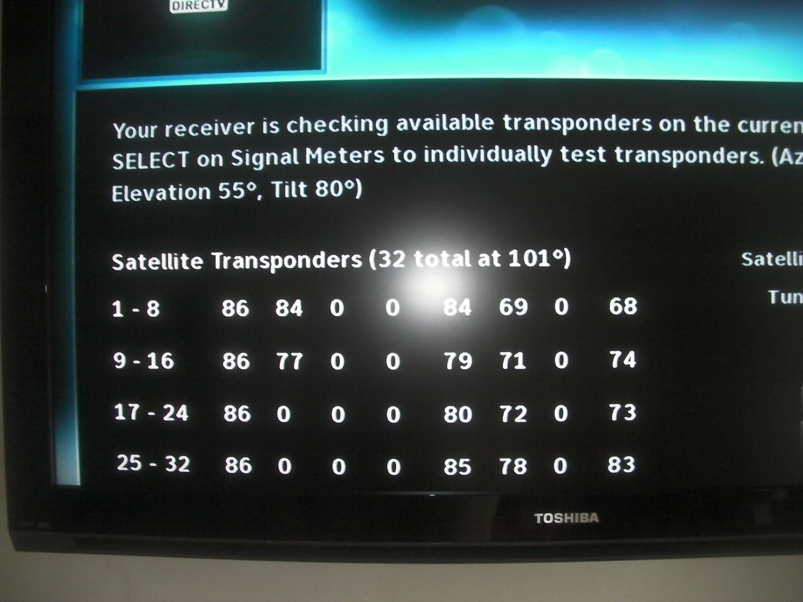

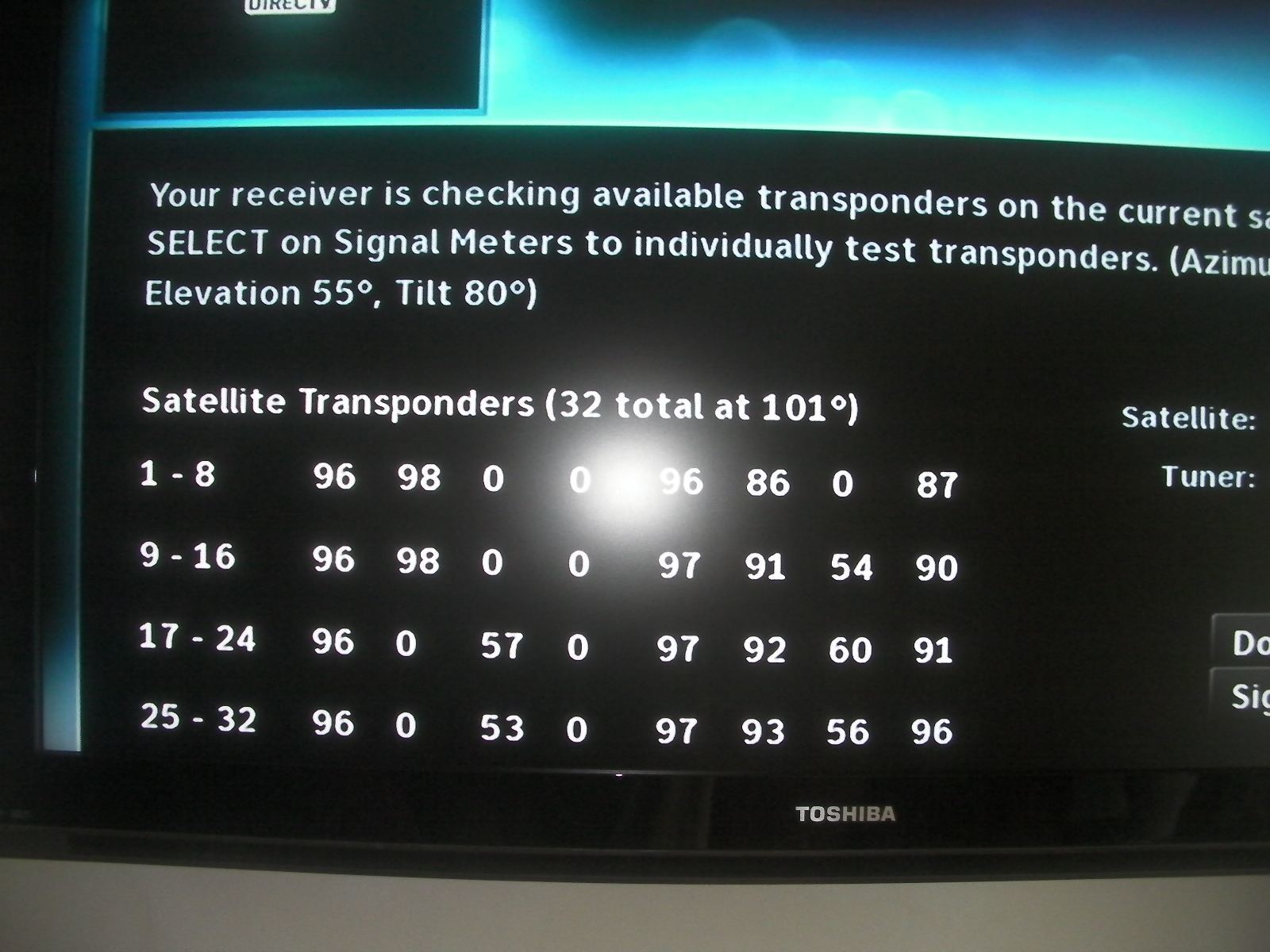

I switched now to a SWM set-up and things seem to have slightly improved. I do have less error messages about updates, the signal strength is still the same.
Further I have tried a Sonora power amp LA281R but reception got actually worse. With the amp it dropped some 101W tps and also lowered some other signals.
I will have to call Sonora to ask.
I am using the Sonara to overcome a long cable run of 250'+ from the SWM switch to the receiver, which causes a slow down of the receiver.
That cable run does not include the length from the Lnbs to the switch which is up to 50 feet.
ww
without Sonora LA281R: 101W wo amp.JPG
with Sonora LA281R: 101W with LA281R.JPG
