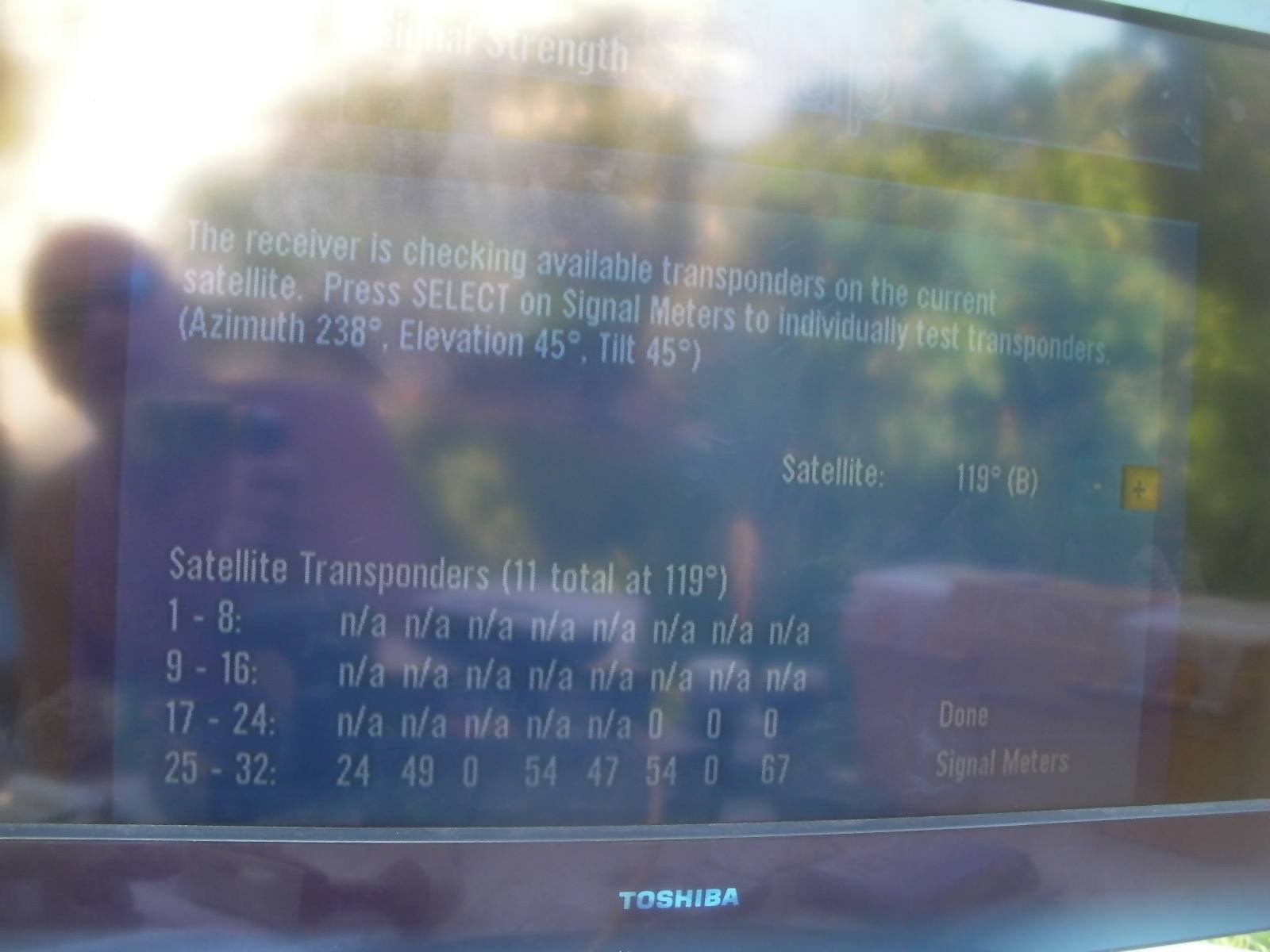

got a signal for 119W for Directv !
I used the 8 foot dish in use for 119W Dishnetwork; change the LNB from Dishpro to Legacy and got the
following readings (I did not move the dish at all, just changed LNBs):

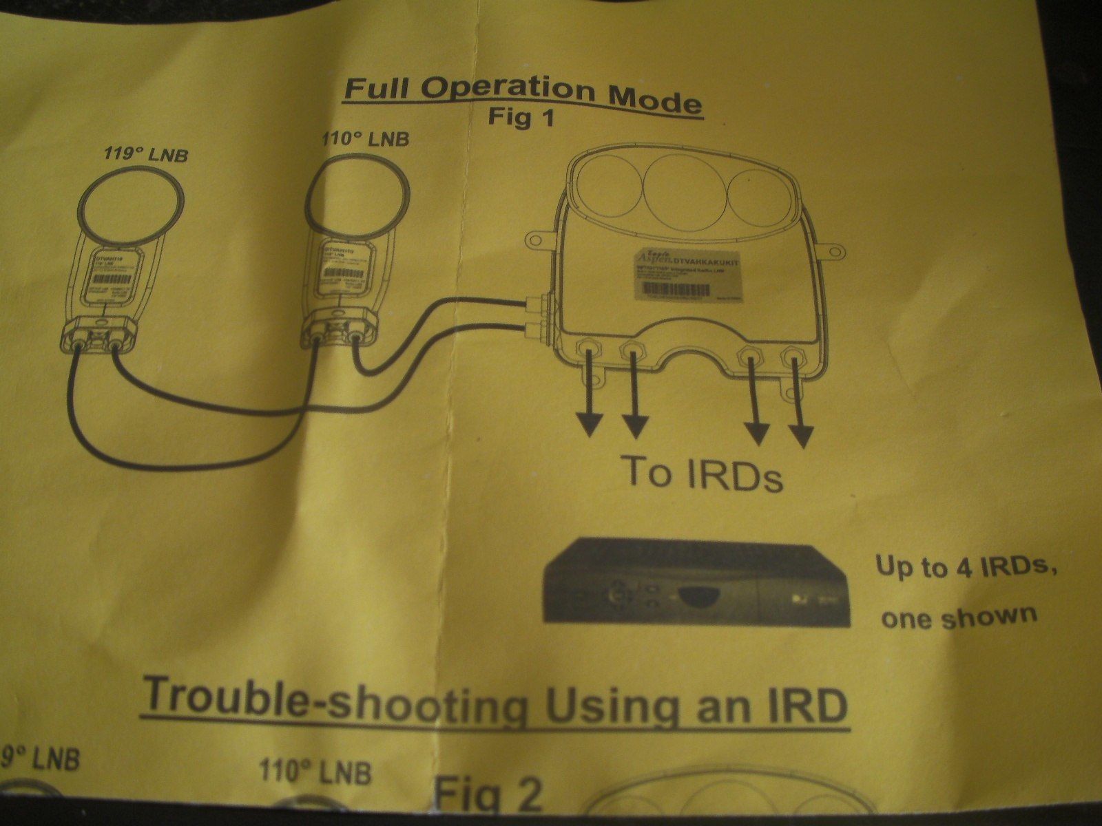

Here are the setup instructions for the Alaska/Hawaii LNb I have installed for 103W:
* How would I go with just adding the 119W ?
One input is marked for 110 and the other for 119W.
Thanks,
I wired the Directv 119W LNB to the 103LNB as shown above in the yellow schematic but just left the 110 LNB off:
Two cables from the dual Legacy LNB to the Hawaii/Alaska LNB input for 110 and 119.
I also tried just one single wire.
No signal arrived at the switch.
Any idea ?
thanks

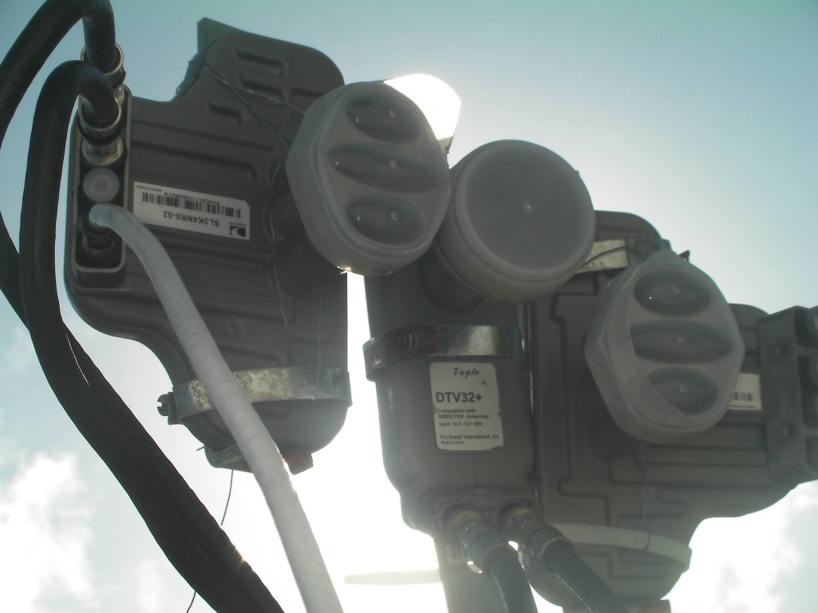

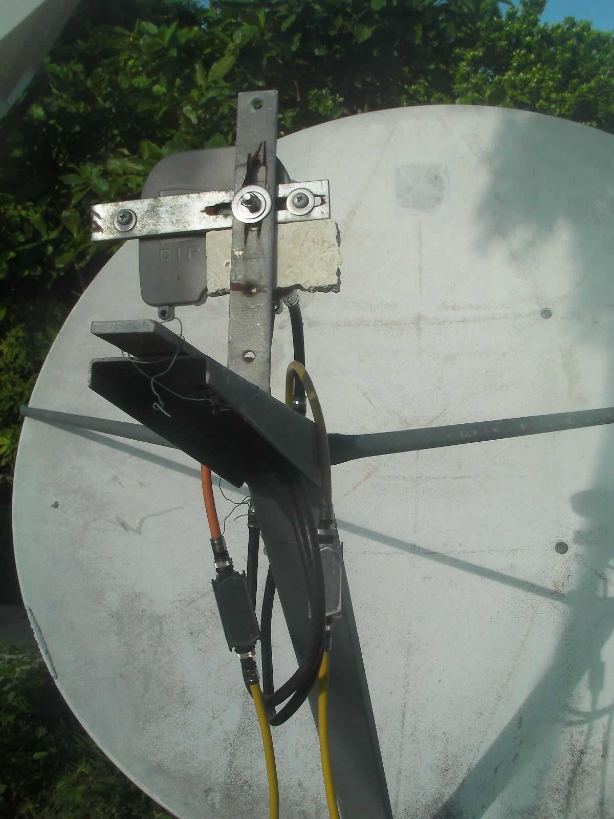

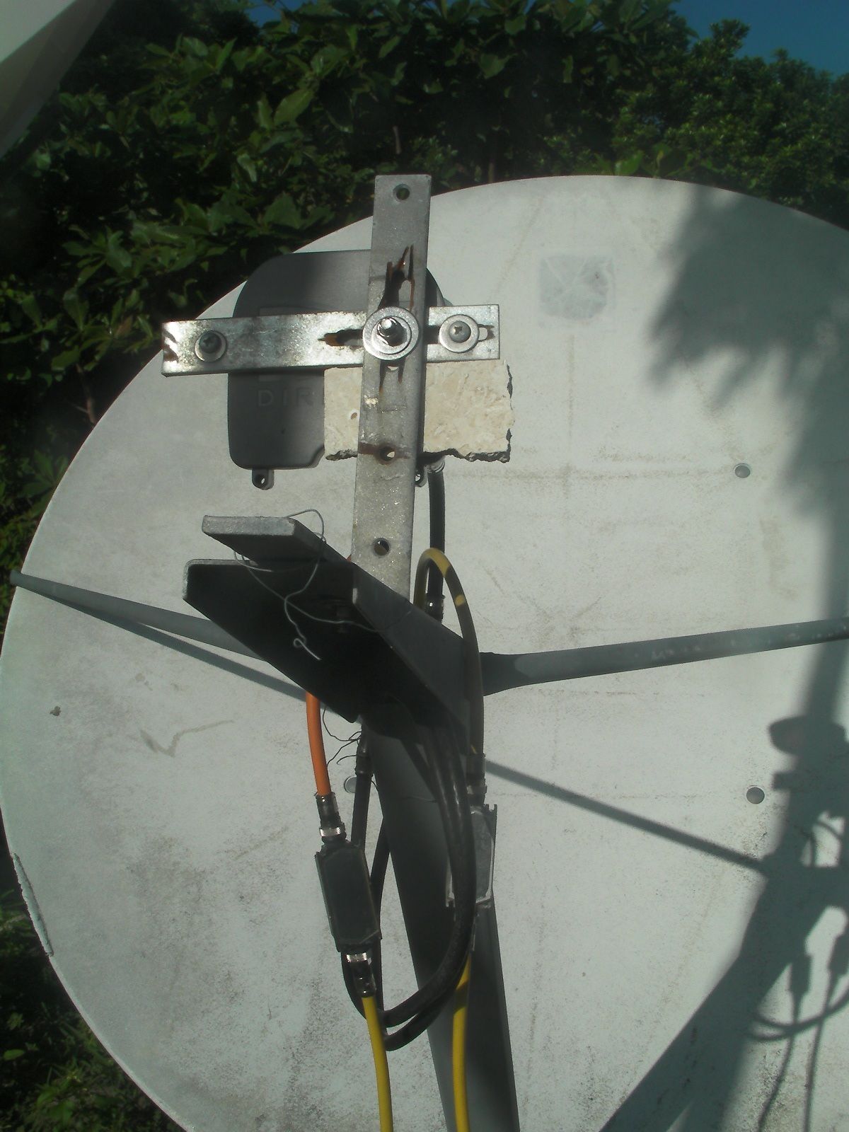

119W: On a 9 foot dish I changed the LNB from a Dishpro (for 119W Dishnetwork) to a regular Directv lnb for 119W Directv.

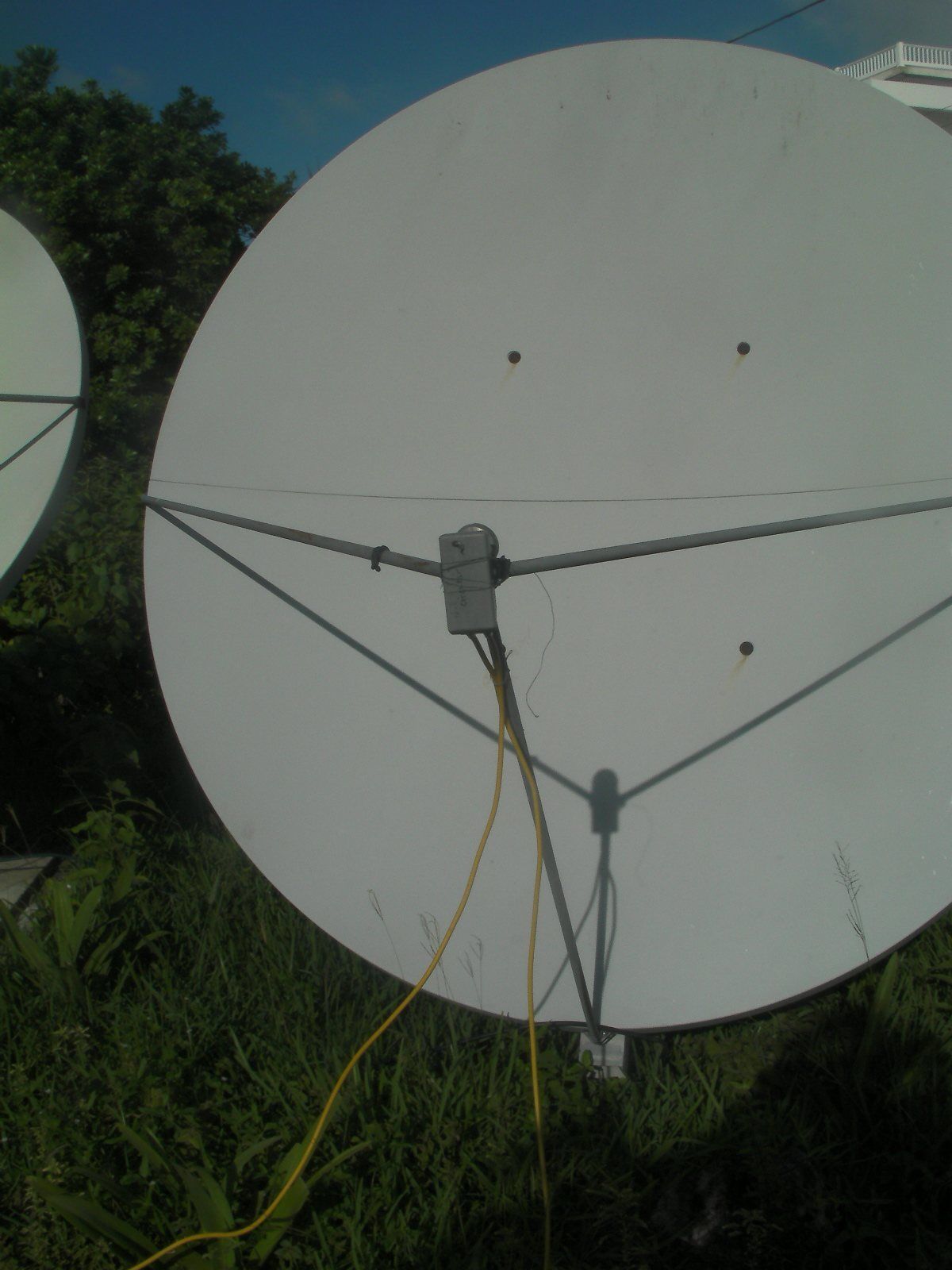

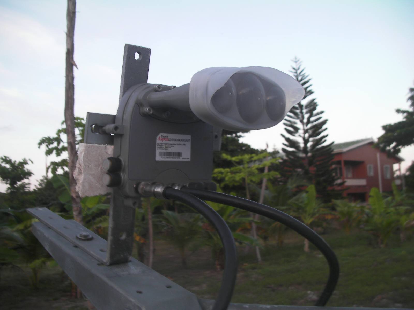

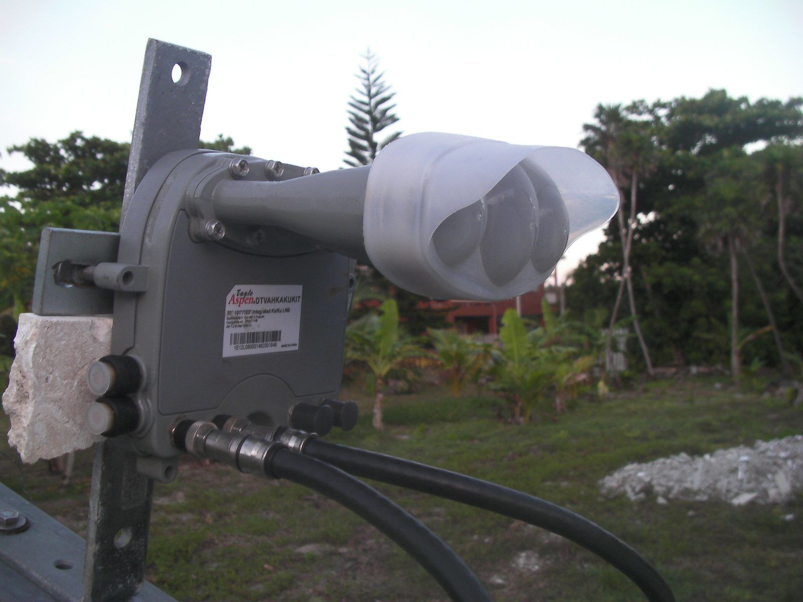

103W: a Hawaii/Alaska triple Lnb mounted on a 6 foot dish. Only one feedhorn of the triple lnb --located in the dish's focal point-- gets the signal. That's why the LNB is off center. The 119W is fed in with a PVDP-2PP Power Passing Diplexer. An inline amp is added for 119W before the diplexer.
Though the Hawaii/Alaska LNB has inputs for 110/119, I could not get it working that way but had to feed the 119W into the 103W cable running to the switch using the diplexers DVDP-2PP.

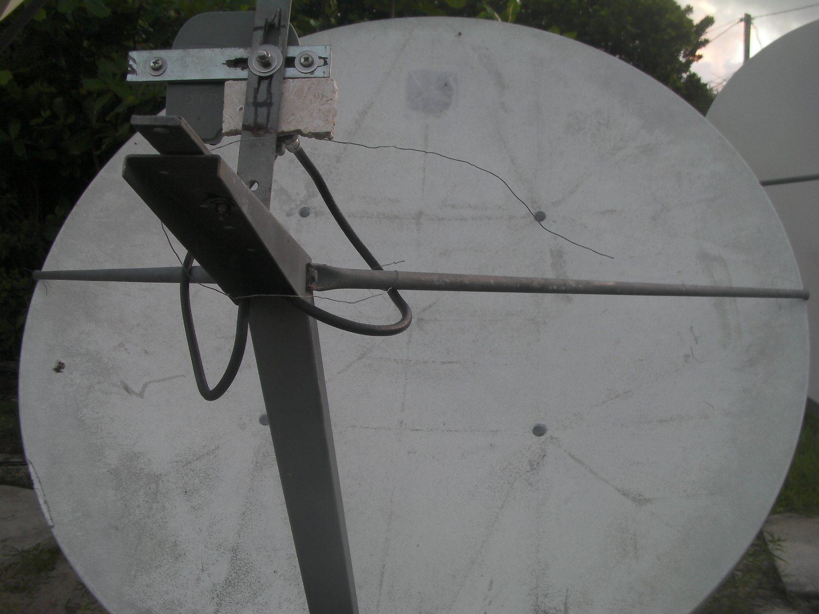

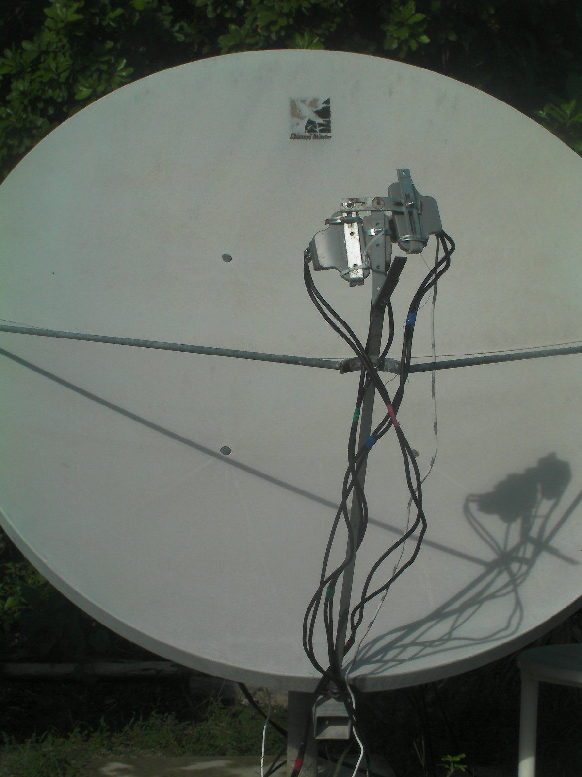

9 foot dish: 101W in the center/focal point, regular LNB. The triple LNB for the 103 is to the right (in the right pic). The top feedhorn (of the 3 feedhorns) is in use.
The 103 triple lnb (left in the right pic) is currently not in use. For 103W I opted for a separate 6 foot dish (as seen above). It was much easier to fine tune.

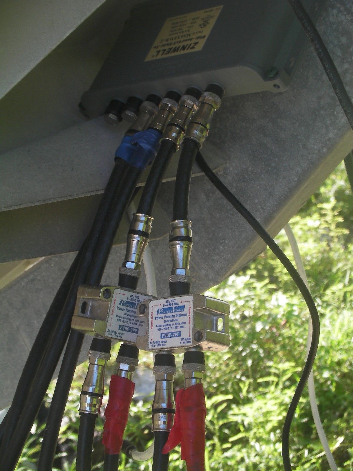

The red taped cable for 99W is combined with the 101W cable by a PVDP-2PP Diplexer into the switch's 101/99 input.
The blue taped cable comes from the (above shown) 6 foot dish for 103W. It also carries the 119W signal.
