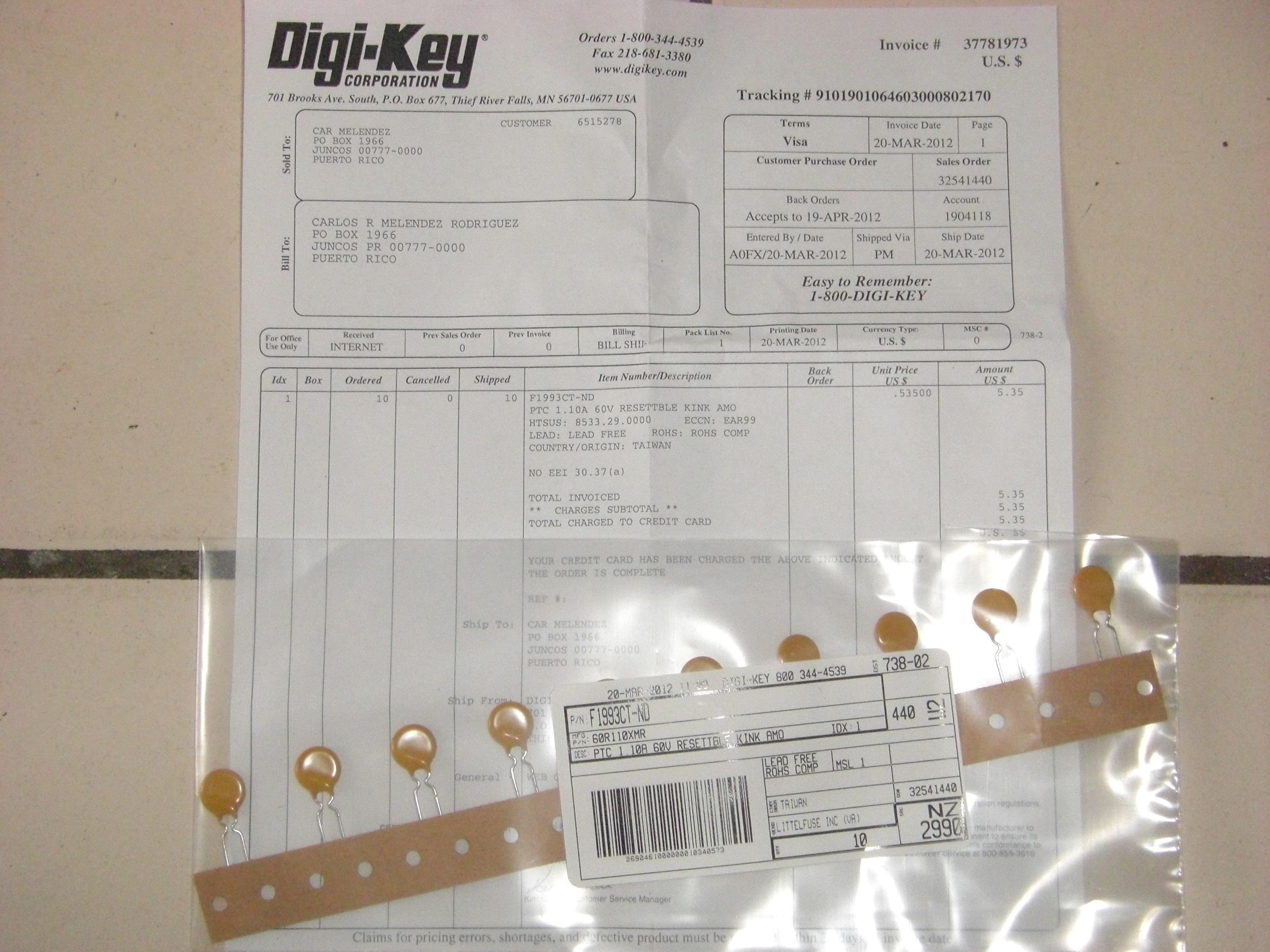

I just received my 10 pieces I ordered from Digi-Key. I'm planning to update my (2) S9, (1) Solomend and (1) S10 with component outputs eventhough they are working OK. All 4 boxes are connected together to fixed dishes using 4x4 and Diseqc, so sometimes I lost some V polarities on my S10 when 2 or more of the boxes are turn on at the same time. Thanks Pixl for all your effort and inputs!!!

Will like to hear from Pixl what we should do if we already purchased the original P/n He suggested. Do we need to go back and order this new one and discard the ones ordered???? Thanks
If you already bought or installed the first Digi-key part I would use it. I did some testing on the first few I installed and a dead short does indeed cause the thermistor to open the circuit and protect the power supply. If you have yet to buy one go with the new part number as it is closer to the original specs. Not that critical, especially if you don't short out your coax very often.
I will use what I have, all new ones I need to order will go with the new p/n. Thanks!!!!

So now I'm a little big confused. So the short is created by the original part F1993CT-ND?? If so will it beter to use the new one F1990CT-ND??? Price on the parts is really cheap so I'll appreciated if you give me you honest opinion or point me in the right direction. I was in the process to begin to update all my 4 S9/S10 plus 4 of friends eventhough some of them are working OK. Thanks

No the short is not created by the original part. What he saying is if he shorts the coax on purpose(to test it) the part is doing what it is supposed to do.
