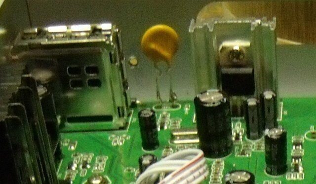

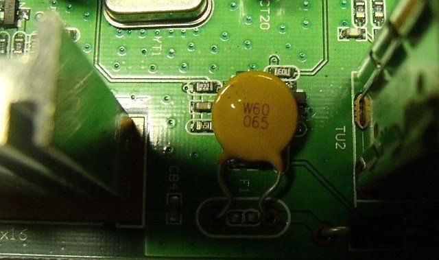

ke4est and Pixl, Thank You! I recieved the part Monday. (That's incredeble speed by the the postal service to these parts) Finally had the opportunity to install it today. I did not perform a 450ma burn in. Put back into operation, returned to perfect :) S9 serial # HD10C1B99-003944
The original part, W60 065, did work for 2+ years, Heaviest draw is less than 200ma.
Failed part exhibits a 5v drop @ 100ma. after 20 min. from 'cold".
Thanks Again!

Nice! Glad to hear it's back up and running like before. Glad to help! You are very welcome.

ke4est and Pixl, Thank You! I recieved the part Monday. The original part, W60 065, did work for 2+ years, Heaviest draw is less than 200ma.
Thanks Again!
Nice photos of before/after of the top side repair.

I've traced the problem of low LNB voltage that causes the S-9 to work for a while then drop off. There is a small part that looks like a disc capacitor near the tuner that actually is a PTC thermistor that goes bad.
