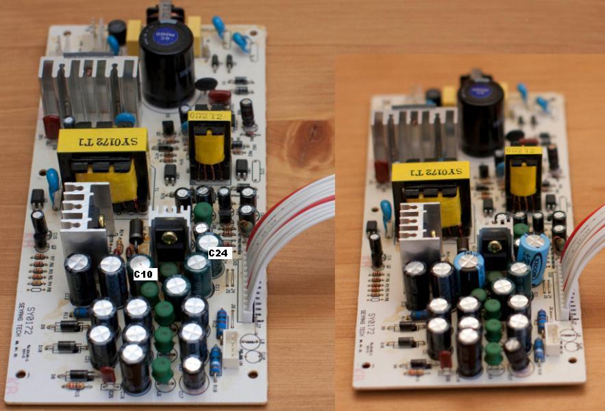

well today my salvation army SV8000HD rebooted on its own as I was watching the Argentina World cup game and was stuck on BOOTING.
Powered off/on with rear switch and display was gone, I did see the green lights on the board "on" but other then that it was doing nothing else..
So did a google search on Sonicview 8000 power supply and found some results on some "hack" sites (had no choice) and followed some suggestions on how to fix the BOOTING/NO Display problems.
It mentioned to replace the C10 and C24 capacitors with radio shack part # 272-1032.
Ran to Ratshackatack and purchased 2 caps, took out the power supply board and removed and replaced the 2 capacitors as pictured:
Put back the power supply, and fired up the SV8000HD and walla.. the display was back ON and booted normally.
total cost for fix, $3.49 since I already had the solder iron and some rosin core solder.
