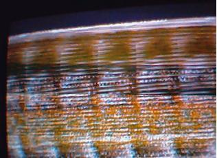

why does the screen do this it scans and finds one and starts doing this. why like its blury and flickers? hmm

Maybe it is a HD channel or a 4:2:2 , yeah coolsat 5000 picks it up , you just can't view it, well thats what I think you're getting.
