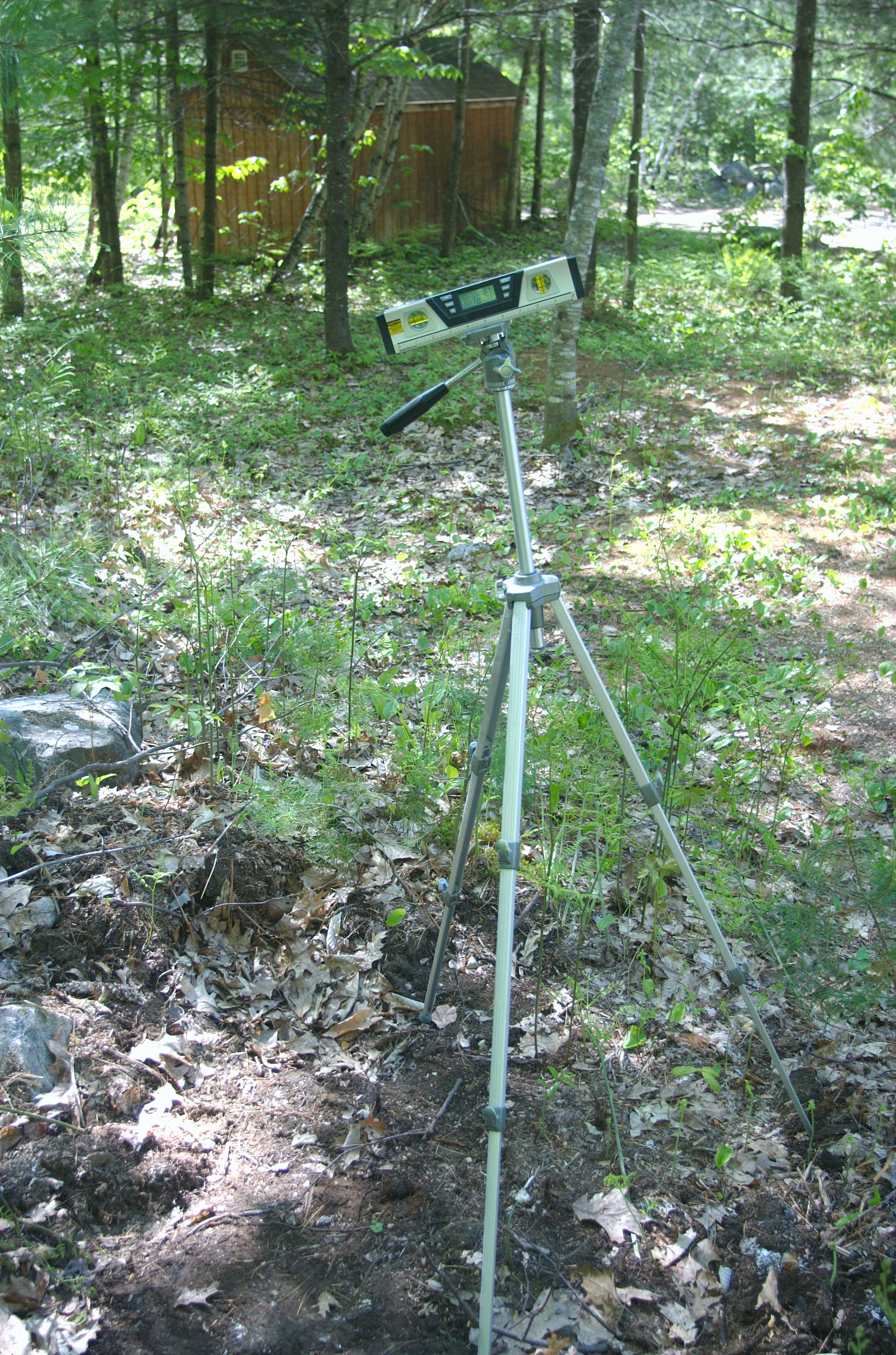

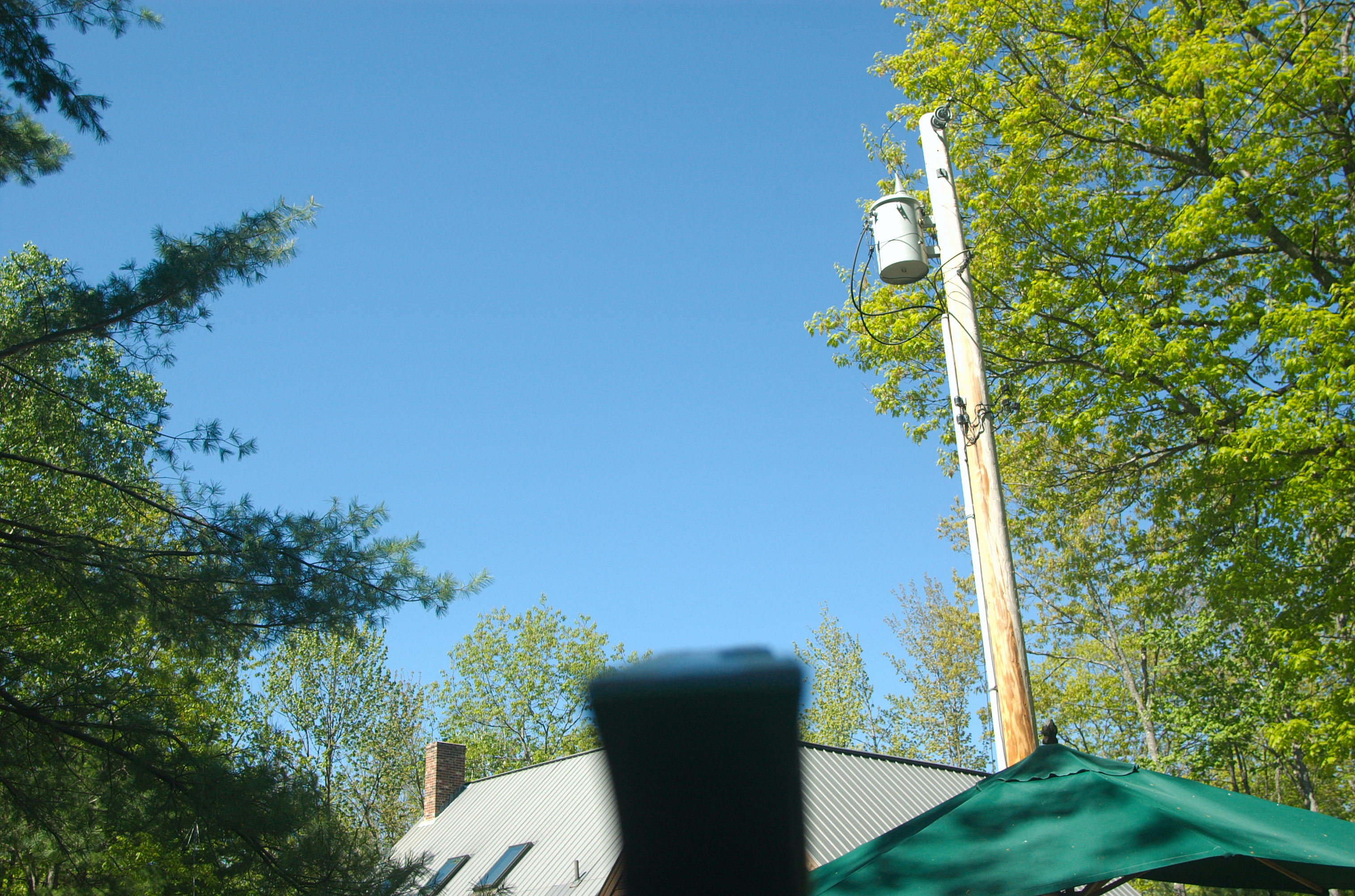

Well if you had asked this 3 or 4 weeks ago, the best answer would have been to use the sun, at the time when AMC21 was undergoing a solar outage. Now, however, the sun will be considerably lower than where the sats are, but you can still use the sun for the azimuth, and use a digital level or inclinometer for the elevation. This is what I did a couple years ago when I was deciding upon where to put my fixed Primestar, which BTW I have aimed at AMC21. First, find Azim/Elev of AMC21 for your lat/lon, then go to the USNO site, and find out what time of day the sun has the same azimuth as the sat. Put a digital level on a tripod, and put it in front of your dish, such as: http://www.eskerridge.com/bj/Sat/Levelsetup_1385.jpg and aim it in the direction of the sun, and then raise the elevation until the angle on the level or inclinometer is the same as the sat's elevation. THEN, you can sight over the top of the level or inclinometer to see where the sat is in the sky, such as: http://www.eskerridge.com/bj/Sat/level-view_1387.jpg Worked well for me, and my Primestar has been fixed on AMC21 since. Ie done this way, you don't have to worry about the offset angles that can really be confusing, or about magnetic deviation. I have also used digital levels which have pretty strong laser pointers to locate offending trees for other purposes (clearing views of distant mountains), and that can work if the trees are close enough, but I really think using the sun is more accurate. I have spent years here cutting down a dozen or so good sized trees, and using rope saws thrown over limbs that are 60' up in trees clearing holes to get views of sats, only to find that when you remove a limb, the trees generally go into hyper-drive growing back even thicker foilage in a couple years. I finally gave up and moved my dishes to a better place.
