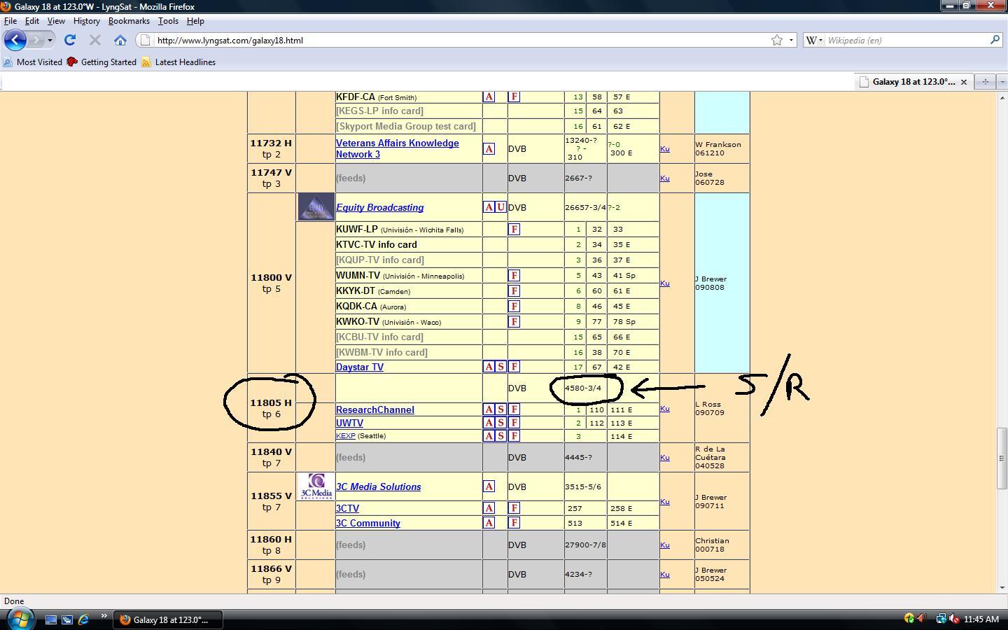

Iceberg. You are the man! SR is listed as 1 on Lyngsat. 4580 is the correct. How did you find that?
Thanks again for your help.:)
I usually use our own thelist ;)
But for Lyngsat, where there is more than one channel in a mux, the top shows the symbol rate (and the FEC but most receivers that is automatic)....see attached
