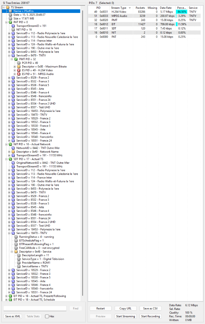

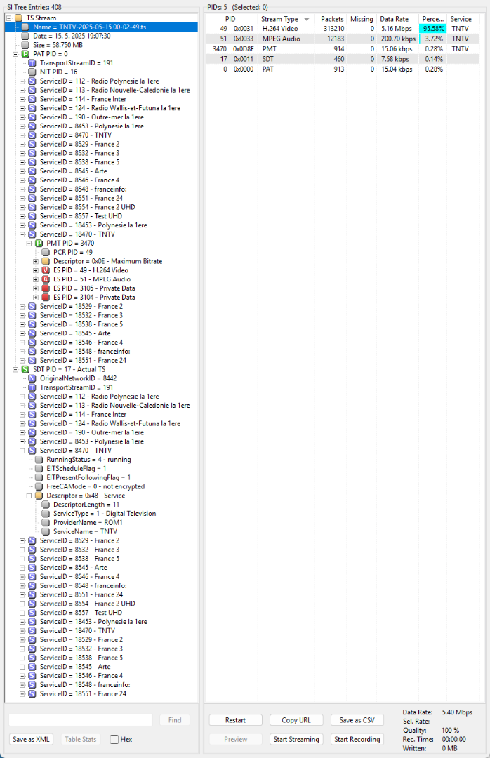

cyberham SatelliteGuys Master Original poster Jun 16, 2010 6,203 5,277 British Columbia May 15, 2025 #63 I uploaded two more zipped files to here. These were recorded using an Openbox S9 receiver. There are two ways to record on the S9: with PS off and with PS on.
E EnoSat Active SatelliteGuys Member Jun 4, 2011 19 14 Slovakia May 15, 2025 #64 There is no difference between PS on/off
