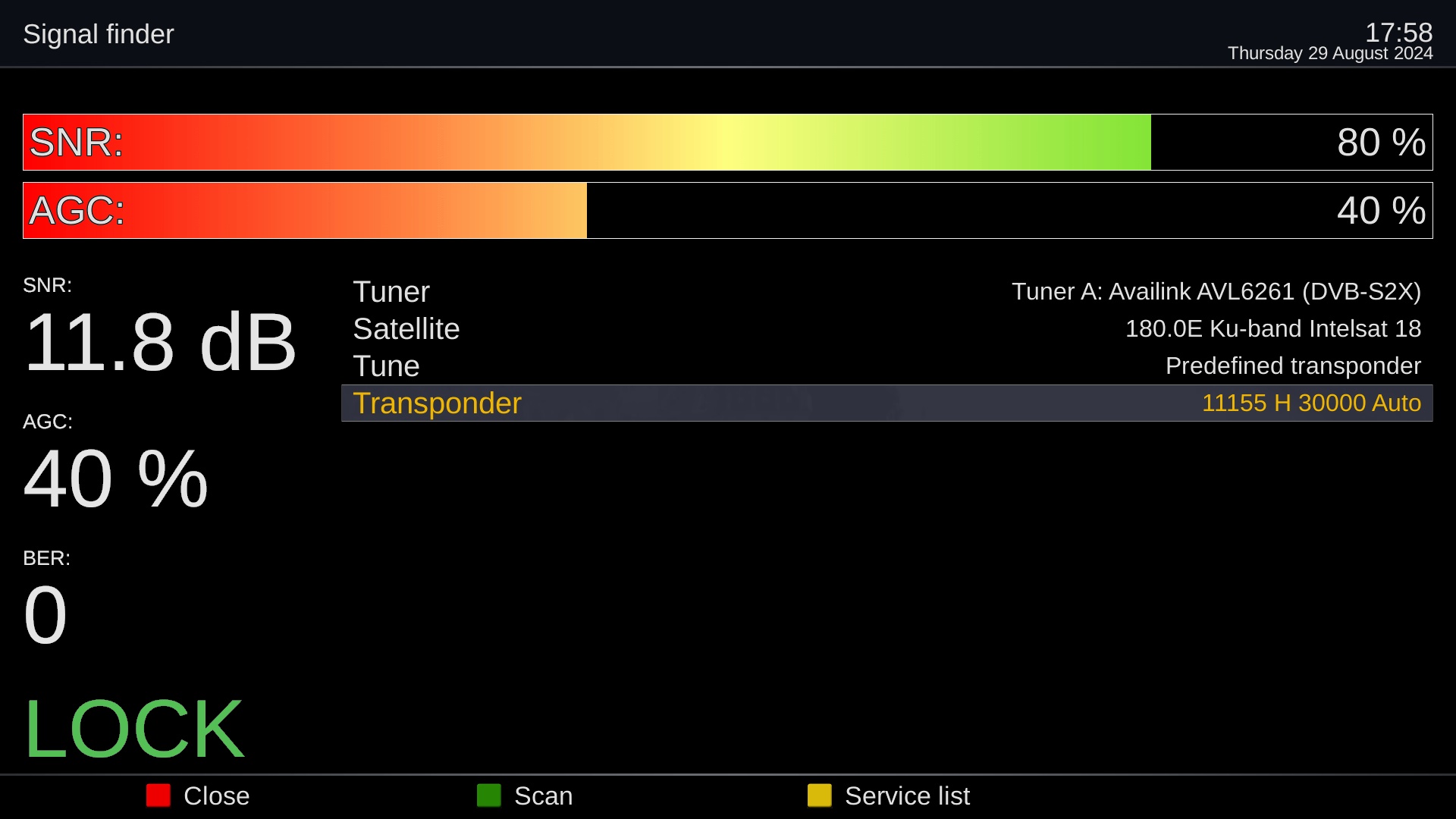

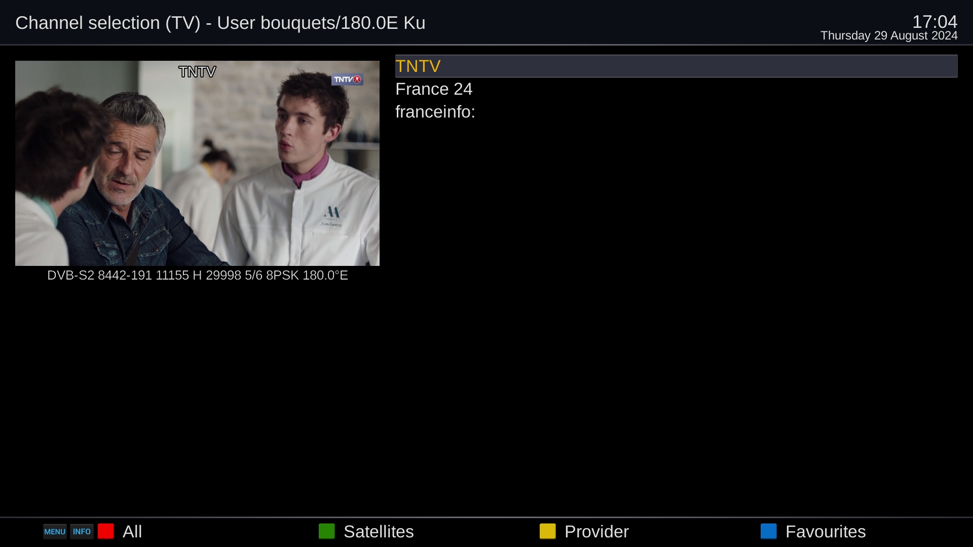

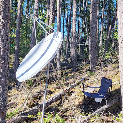

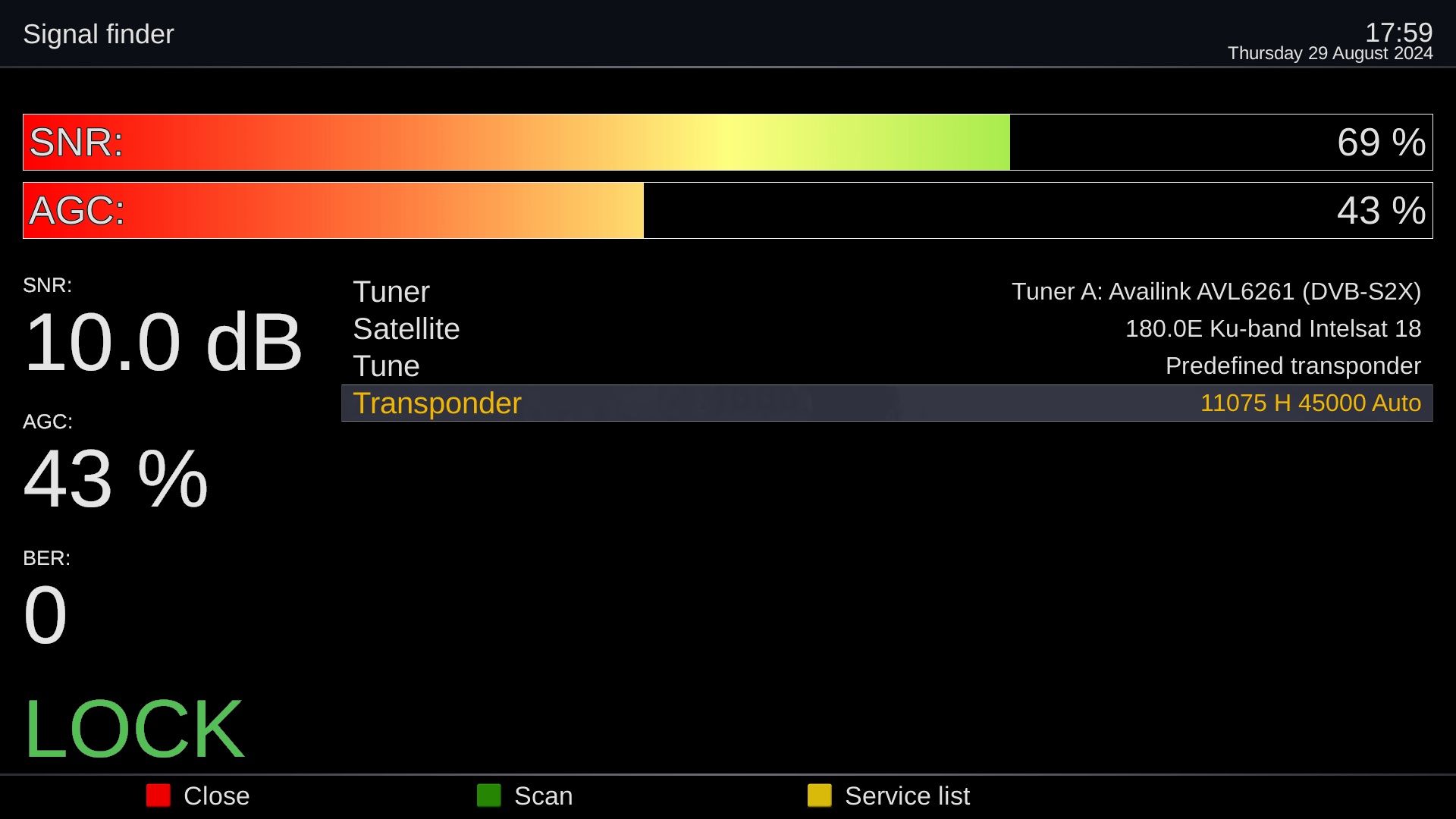

Today I had success. I used my 1.2m fixed dish mounted inverted to make the 12.8 degree elevation easier. My azimuth is 243 degrees (WSW). I had to locate the dish in the forest to find a window through the trees. In the end, I locked two transponders: 11155 H 30000 (11.5 dB) and 11075 H 45000 (10.0 dB). 11155 MHz has three video channels ITC (TNTV, France 24, franceinfo) and five audio channels. 11075 MHz has many video channels but all are encrypted with Nagravision.
My question to those who can receive this satellite either now or have in the past...do these polarities agree with your results? These disagree with Lyngsat which says both tps are vertical.

According to SatStar.net, the beam you are in, French Polynesia/US, is only vertical:
How much skew is on the LNB? Since the dish is upside down, how did you adjust it, and did you go the right way?
Skew here is +35.3 degrees. With that amount of skew, if it were in the wrong direction, I wouldn't receive any signal. For an inverted dish, I learned last time I inverted that you turn the LNB in the same direction as if the dish is not inverted. The scale on my LNB bracket only goes to 20 degrees, so I do have to guess a little about where 35.3 degrees would be. I could try adjusting the skew a little next time I'm at the dish to see if this fixes the issue.
Six years ago, Martyn said here that he received both tps with H polarity. Are you around Martyn? I am doubting what I read about this satellite since I think there are errors in published info about Intelsat 18. Or maybe things have changed since the date those items were published.
ADDED: I'm wondering if they have combined the two 11155 tps into one tp. It looks like I am receiving everything that Lyngsat shows for 11155 V and 11155 H on the one tp. Would this save $$$ for them? And beam everything to both North America and the South Pacific?

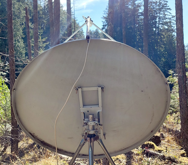

I downloaded and zoomed in on the photo from the back of the dish, and can see the skew (judging by the coax connection/cable). To me, it looks backwards, and the skew should be on the other side of zero (from the back of the dish leaning like this / instead of \ ). Basing this on my fixed dishes, looking from the back.
Putting it to 35.3 on the other side, would change it to vertical.
I looked at high resolution old photos. I think you're right! This would explain my problem and the disagreement with satstar and Lyngsat. I will correct tomorrow! My most recent memory about an inverted dish was when aiming my fixed dish at 77W. Of course its skew is in the opposite direction of 180E.
Weird, Lyngsat shows 11155 as both V and H, on different beams.
I think now that Lyngsat is correct. We cannot receive the horizontal beam since it's focused on the South Pacific. We can only receive the vertical beam here in North America. I will correct my LNB skew today which will correct my scanned results to vertical only.

Keith Brannen gets the Troubleshooter's Award with full bragging rights associated. The LNB skew was corrected and both tps scan in on the correct vertical polarity.
Viewing from behind a dish, whether the dish is upright or inverted, a positive skew means you rotate the LNB clockwise. In general, with reference to the peak of the satellite arc, you always rotate the LNB in the direction of the arc which you are exploring: clockwise for western satellites, counterclockwise for eastern satellites.

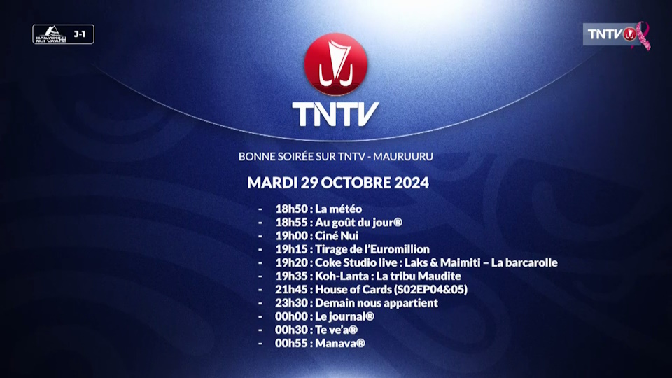

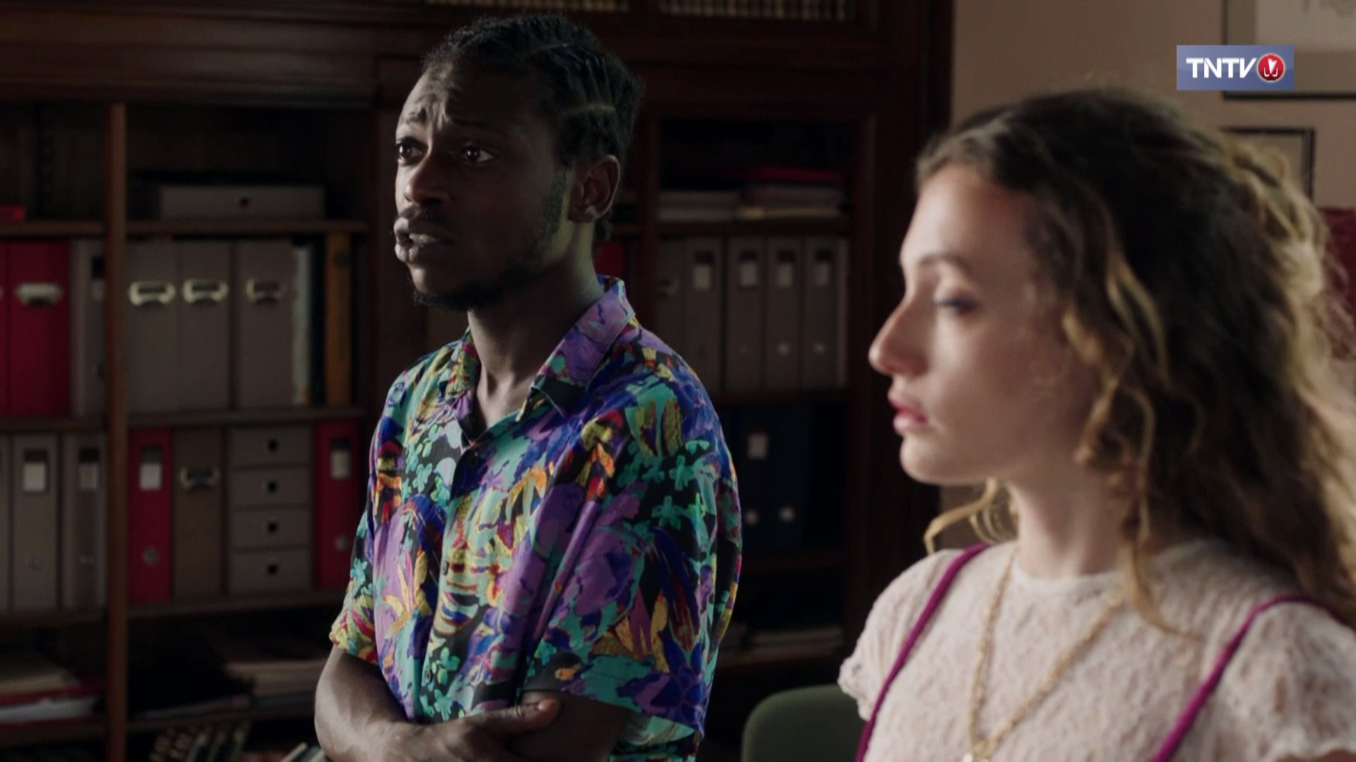

The ITC channels on 180E support EPG so it's easy to know as you view what's coming up on their schedules. I search for programs in Tahitian on the TNTV schedule since they may have a local reporter travelling around the islands providing most interesting visuals. I can record them and watch at any time.
Christian Lyngemark is updating Lyngsat with the info I fed him so the transponder with ITC channels that we can receive are being updated on his chart. There are many ITC radio channels also on two transponders.
