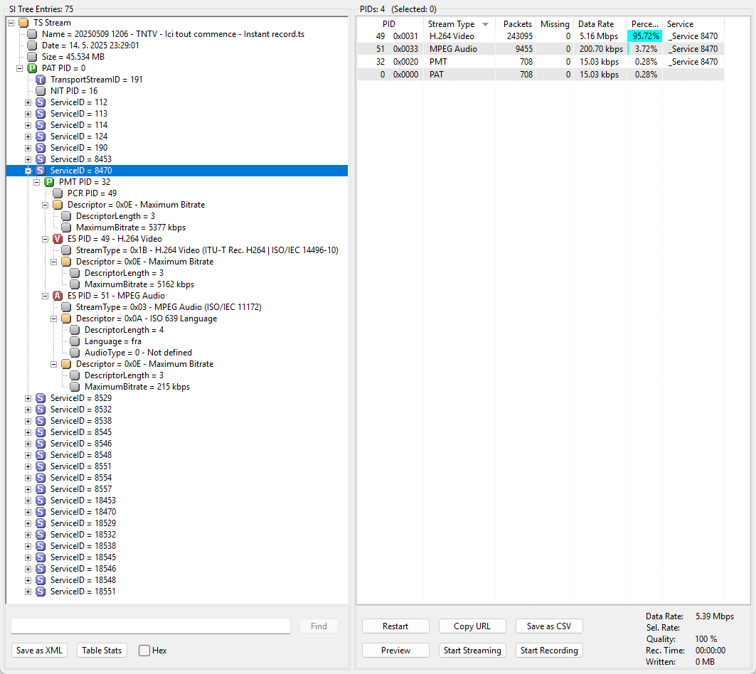

The zipped recorded file is available to download for 3 days from here. I included all files produced by the recording process in the zipped file. Let me know if you have any trouble downloading.
Since you only selected a regular RECORD, only the PIDs defined in the PMT were saved to the TS file.

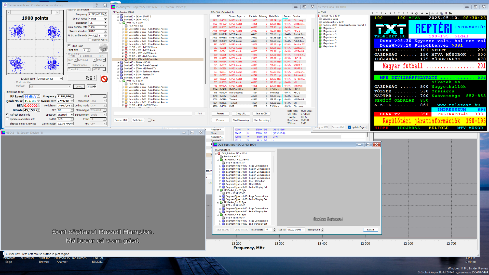

I have uploaded to here a newly recorded file using a GT Media V7S5X receiver. Anybody can download while the link stays active for 3 days.
