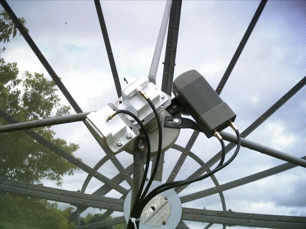

At this time I have only one coolsat 4000 pro in the c band system. I have a 7.5 mesh dish with dual c band lnbf on it with a ku linear attached to the scalar. I have 4 coax going down to a 1x4 diseqc switch then to gbox then to receiver. The gbox is in the middle of the system. I have the cs4000 set up as diseqc 1.0 and I do not think it is changing between the 4 ports on the switch. I get all same q and signal bars all the time. I assigned c band horz to port one, c vert port 2, ku horz port 3 and ku vert port 4. It is a dual ku lnb. I have 5 zinwell 6x8 ready to set this up for my household of 4 receivers but have not put a zinwell in this c band system yet. Any thoughts?

In this particular case it may be easier to use your Zinwell 6x8 instead of a DiSEqC switch for the four LNB outputs you have on your BUD. But you may need a power inserter to get enough voltage to the vertical C-band LNB. Most like more than 13V. As with the DisEqC switch, in this set up the GBOX should be connected in between the receiver and the switch.
However I should point out that in a more complex system, where you have more than one motorized dish and all are controlled by a single receiver, the best and probably only way to do this is to have the GBOX or Ku motor after a DiSEqC switch that selects the dish. Something like 6x8, 4x8 or 4x4 switches can be used to connect to multiple LNBs and allow other receivers to be added. Putting the motor or controller after a DiSEqC switch really bothers people here, but it can be made to work reliably.
